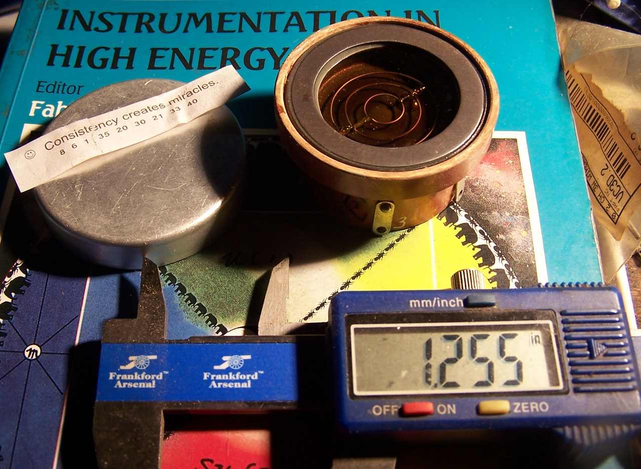

Re: Standard counters - tubes arrived
They just got here from Ukraine. See picture.
They were more than slightly optimistic about the sensitive area these have, which of course means they'll count less for the same silver activation than one that covers the entire 2" piece of silver.
But of course, if we all use the same setup, it's a scaling factor that only matters if you're trying to get to absolute accurate numbers of neutrons, which is nearly impossible with any technology.
Truly, that's only going to matter when we can use a calorimeter to measure net heat gain, other than for safety. For safety, I'd say that if you're getting to over 500 cpm silver in 2" square on a five minute activation, you should stop about there and find a way to get yourself farther away, run less frequently, or scale things down for now. That will be a lower number on these smaller tubes and a smaller piece of silver -- hey, it's cheaper.

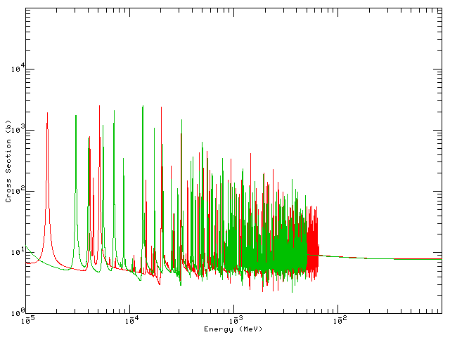

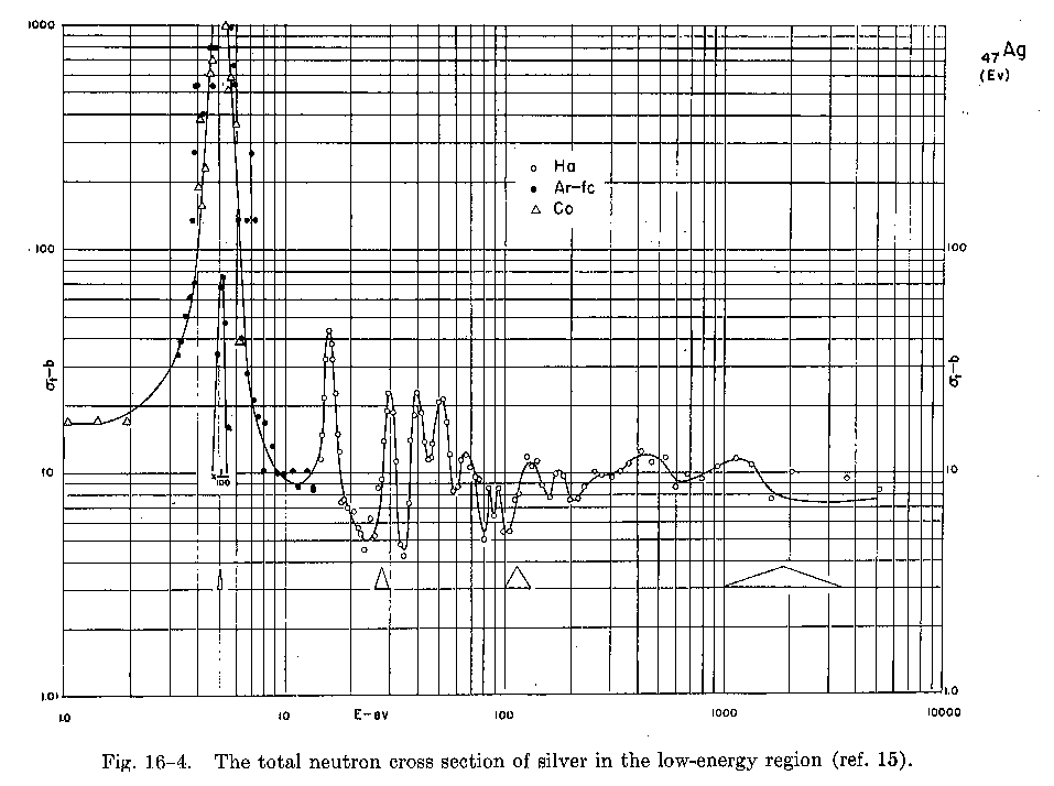

Doug, In all the data you have accumulated, is there a beta penetration depth graph for silver?
It is often said on fusor.net that silver foil is best, but if silver has 2MeV betas, then wouldn't that be able to get through a full millimetre of silver? I presume that is the max depth (to how many sigmas??) but there must be some optimum upper thickness of silver such that, after a given activation flux, external beta emissions from that piece would be a max. If the max penetration depth is 1mm (?) then I'd have thought there would be an optimum around 0.3 to 0.5mm so as to maximise activation detection.
Advice welcome... because I am thinking I might try to make a scintillation silver sandwich, and silver price will be the most costly single component so I need to maximise it.
Also, the other question that goes with that, what is the penetration depth of a 2MeV beta through a scintillation crystal?
I've not seen one for betas in silver, but it's fairly easy to calculate with the stuff in say, Haliday's book. You have to leave some for penetrating the detector window and depositing some in the detector of course. Since electrons lose some fraction of energy per interaction, it's a bit of math as the likelihood of energy loss is not a constant but varies with (remaining) energy.
We are using silver that is .01" (ten mil) thick and it works great. It was the cheapest part from a jewelry supply house, I think about 30-40 dollars for a 2x6" piece (eg three samples at our standard size). As you seem to know already, it's getting the radiation back out, not the neutrons in, that is the limit there. We are careful to use the side pointing at the fusor to lay on our detectors to get consistent (relative) readings there, as that side sees more resonance region neutrons than the other side, and activates better for whatever reason, probably the lousy capture and low numbers of reflected neutrons (at resonance, or any energy) in the moderator stack. We've not tried thicker than that here, yet, but Bill brought a coin the other day, pretty thick, we might try that if he brings it back next time.
I can't see exposing my scintillators to full-snot radiation from a fusor, in your case it might be different. Fusor.net has some info on silver-painted geiger tubes and it was kind of disappointing.
Further, many many things get activated other than silver so getting good data out of that is going to be quite a challenge -- some of them have long half lives and will constitute an ever increasing background. The I in NaI is especially a problem -- it ruins them for a long time. But the sheer amount of X rays means that during a run, you see nothing but them (and the radiation damage to the scintillator). It takes so much lead to stop those that you scatter neutrons in (and out of) the lead too...there's no easy answer to that one.
A test coming here soon is an NaI head with a very high threshold to only see the really hot gammas from the rare fusion event that goes straight to gammas. We think we saw some of that during the last demo, but I was kinda busy with the full house, and need to repeat that test. Of course, no one has been looking at the relative percentages of the three possible DD reaction paths so far, and that's something we'd really like to know about if fusion conditions are other than thermal where we know the numbers. Could be that with magnetic and electrostatic fields one or the other gets more probable than in a pure-thermal situation? Which might mean that tuning for max neutrons isn't tuning for max fusion!
One issue with fast phototubes and scintillators is dropped counts due to either sheer speed (easily quicker than any TTL you can get) or pileups leading to only one pulse being counted when really there were 2 or three in that threshold crossing. They really don't do well in hot environments, they are more for detecting tiny amounts of radiation. Something more "numb" seems to be more applicable to high radiation work. At some point, you are better off just integrating or averaging the DC current out of a phototube, which of course is far less accurate than counting.
The radiation depth, X0, of a crystal depends on both crystal (or plastic) type, density, Z, and the type of radiation involved. Since you've not responded to my question of what type you're going to use, I can't look it up in the books (basically, the one in the background of a picture just above this). It varies all over the map. Of course, you don't have to catch it all unless you're going for energy spectrometry, just enough to make a count. An inch thick will definitely get you to "counts", often much less. In general, something dense like BGO has the shortest radiation length, followed by NaI, followed by plastic.
