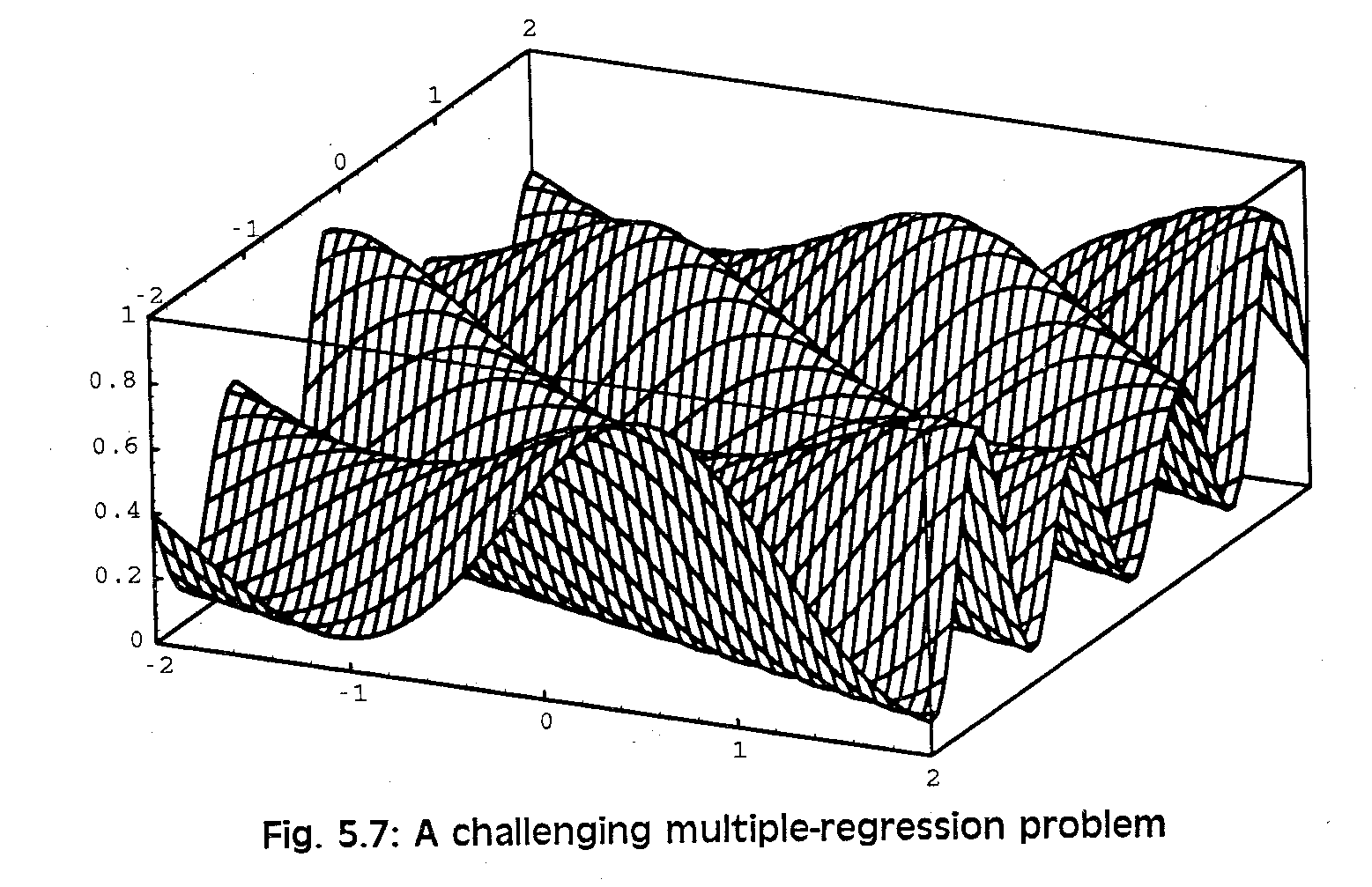

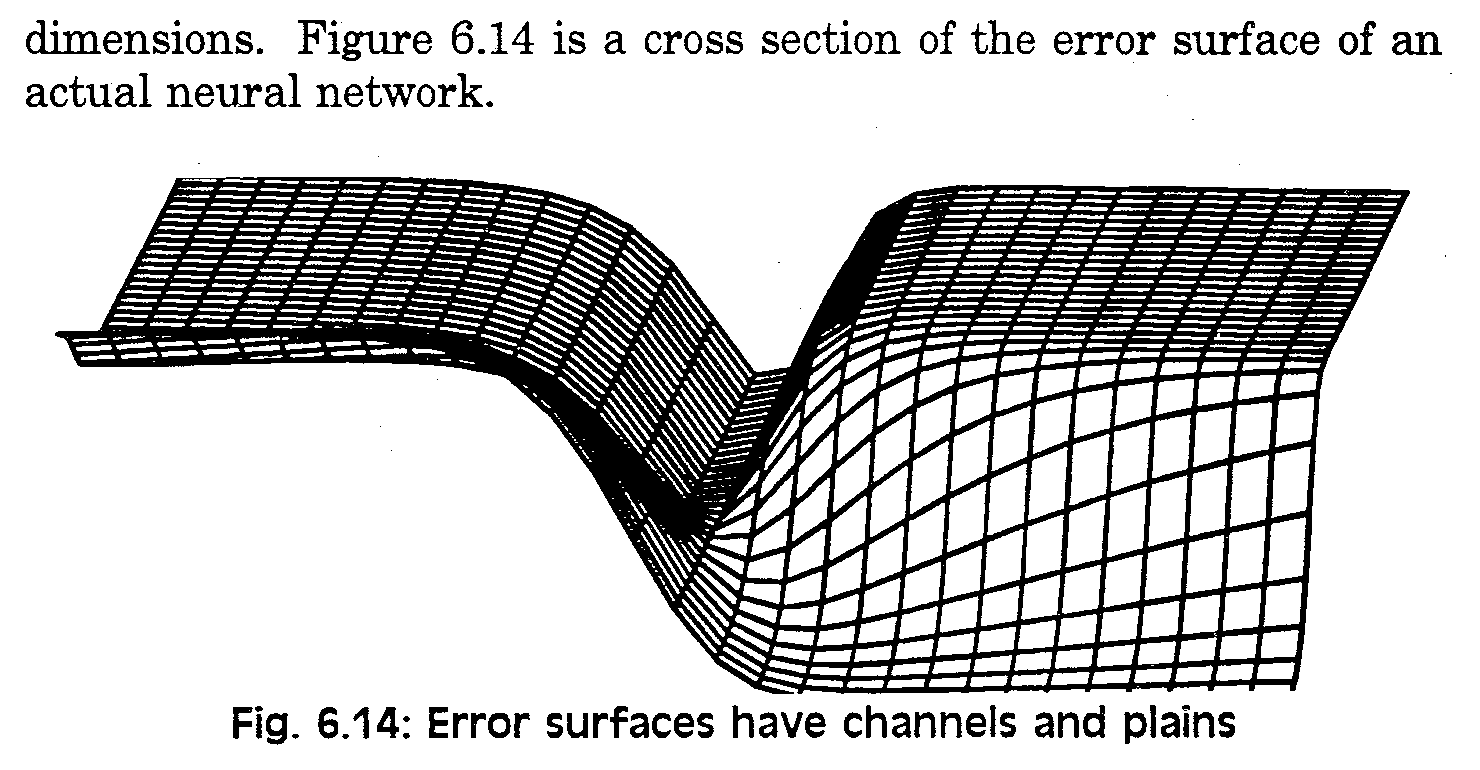

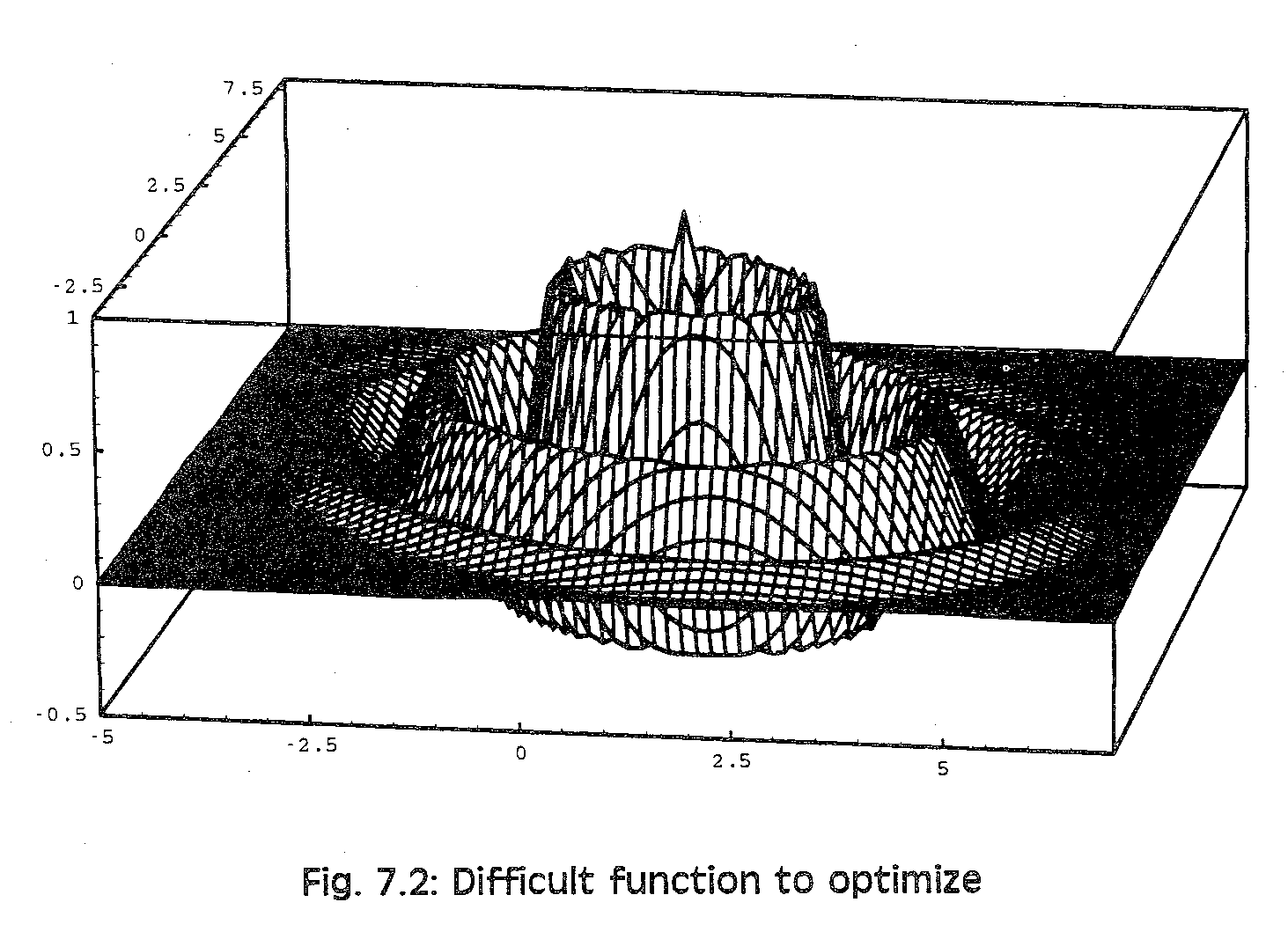

Here are some possible error surfaces in two dimensions. Remember we have a lot more of them to deal with.
Focal length a function of element spacing and net charge (including the stuff there, which is a variable itself).
Gas pressure, volts, current. Ratio of inner to outer dimensions. Ratio of ions to free electrons. Neutrals that
scatter things if there are many of them. And all this is potentially (and in my case hopefully, since I want to control that)
a function of time. These are from Timothy Masters book on neural network training and the issues with simple gradient descent
as a way to optimize things. This is really the same problem....Only in some cases the math that would even produce these plots doesn't yet exist,
the perturbations of one on another aren't convergent either.
