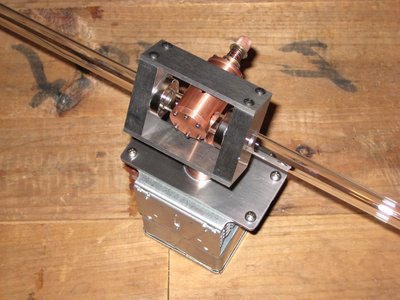

Finally got around to finishing up the machining on this thing. It's probably a little on the fancy side for a test piece, but I wanted to get some good practice at machining OFHC copper before I start whittling on some larger chunks for other stuff.
All of the pieces parts
I still need to get something to cut the quartz tubing and finish up the anode & cathode along with the power supply.

by Doug Coulter
Wow, that looks super nice! A thing of true beauty! A lot better than my kludge at any rate, it should work great once tuned (which can be a little tricky). Yup, OHFC copper is something that takes some practice to machine well, if at all. It likes to climb lathe tools for one thing. Kind of "gummy" stuff. I've had no special troubles with it on the mill, but on the lathe....not so easy sometimes.
I cut quartz on the lathe here, it's the only thing I've found that will work, and I'll cut you some if you like. I put one of those cheapo diamond cutoff wheels in a kind of toolpost grinder I made, and cut with the lathe going slow (about 60rpm) with water lube, mostly to keep the diamonds on the wheel, and the dust out of the air. Think dremel tool mounted on a toolpost and you'd be fairly close (and I actually started out with just that, but it's too hard to make a dremel go slow). But then I made one with a 24v servo motor, a belt, and a speed control to chuck 1/8" bits in a collet I made, works like a champ, also for ceramic tubing. Both of those you just cannot score and break, they simply shatter all over the place and ignore the score mark, even one halfway through the piece. Nothing like pyrex, which is literally a snap. Since quartz isn't cheap..it's better to get that right on the first try.

Thanks - my back-up plan if it doesn't work is to have an interesting conversation piece. The OFHC copper wasn't too bad to machine. I ended up using some transmission fluid for lubricant that was left over from a rebuild, which seemed to work well. The outer piece of the coax that goes around the antenna has some "decorative" contouring though that was added to get rid of the marks from when it screwed itself out of the chuck when I was boring it out. Just when I thought I knew what I was doing, it had to throw me a curve. Keeps me on my toes.
I'll get one of those diamond wheels and take a shot at cutting the quartz. If I start scrapping too much, then I may take you up on the offer.
Once it's finished I'll probably just mount it to my sputtering chamber for educational purposes and fiddle with the gas feeds, extraction and stuff like that. I want to get some practical experience with beams and focusing and all that other stuff that I know nothing about. Both the inner and outer coax portion is adjustable, same as yours, but the tuning was one of my biggest concerns and something I wanted to talk you more about. Seeing yours in action should help out with that.
