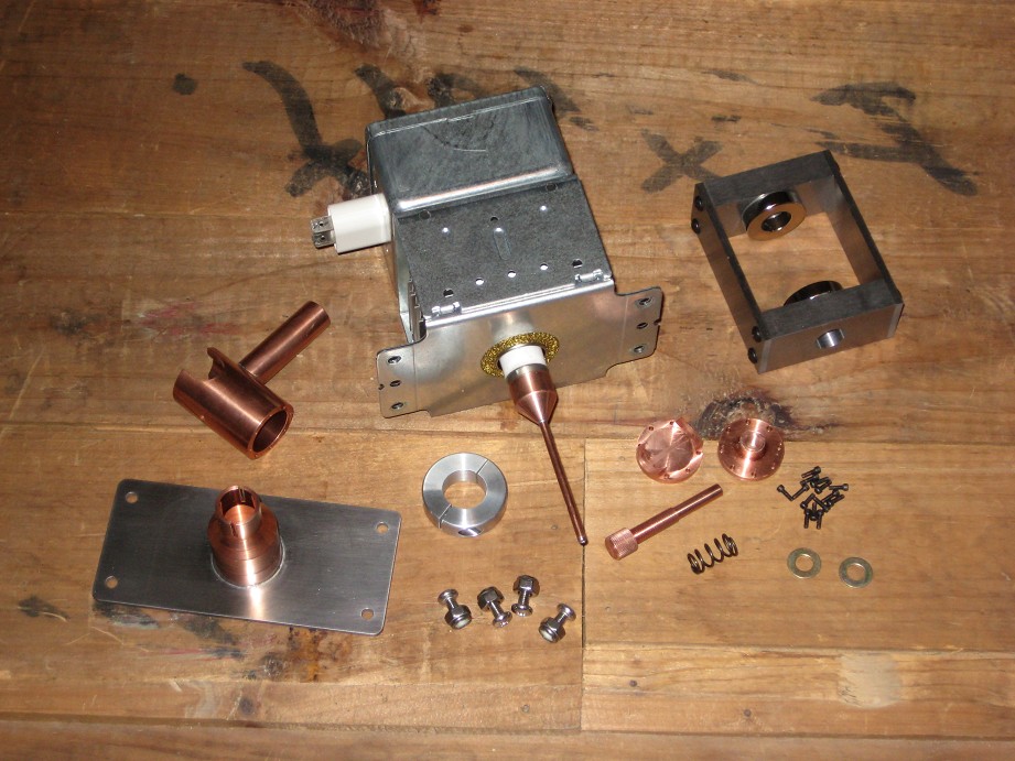

Well, I tried putting this together, first brazing the lower disk to the ISO nipple, and just plain failed to be able to do it. The thick to thin issue, combined in this case with the fact that the thick thing is also super thermally conductive means I either couldn't get the brass hot enough, carefully enough without slumping it, while I got the SS so hot it wouldn't wet due to it oxidizing. I have a decent skill at torch brazing but this one I just couldn't pull off. Rats!
I'm now considering either trying to TIG the dissimilar metals together, or furnace brazing, neither of which I have any experience at all with, or redesigning this thing so as not to have to make those particular joints. Could be I could redesign the cavity dimensions so it can all be inside the nipple (no fat place) with just some disks and pipes there. Don't know if we'll have enough heat to make soft soldering that a problem....which is a little scary.

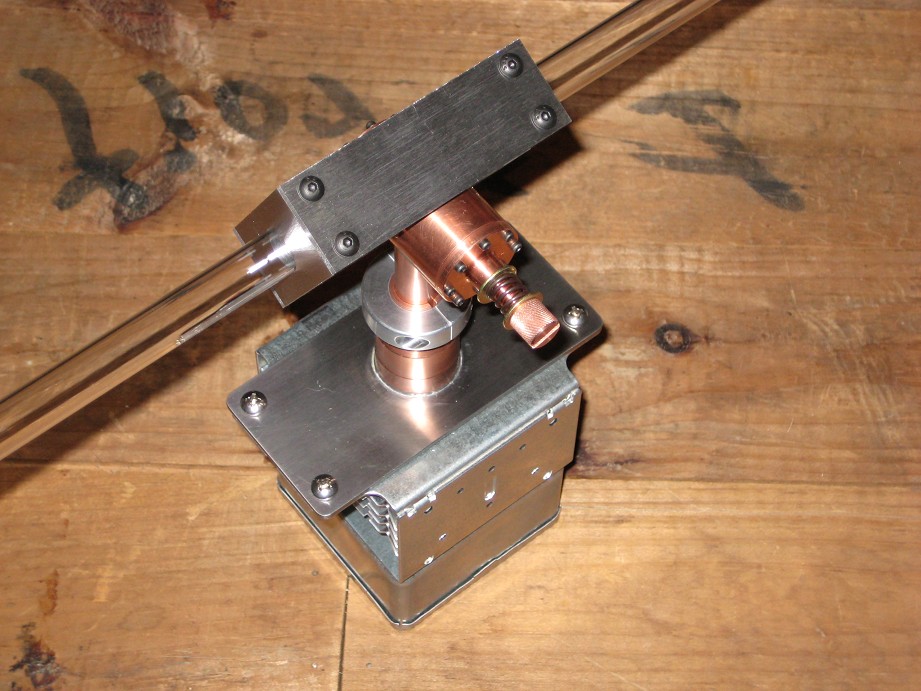

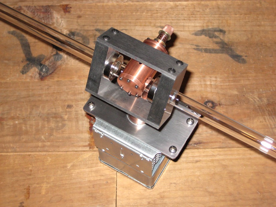

Finally got around to finishing up the machining on this thing. It's probably a little on the fancy side for a test piece, but I wanted to get some good practice at machining OFHC copper before I start whittling on some larger chunks for other stuff.
I still need to get something to cut the quartz tubing and finish up the anode & cathode along with the power supply.

Wow, that looks super nice! A thing of true beauty! A lot better than my kludge at any rate, it should work great once tuned (which can be a little tricky). Yup, OHFC copper is something that takes some practice to machine well, if at all. It likes to climb lathe tools for one thing. Kind of "gummy" stuff. I've had no special troubles with it on the mill, but on the lathe....not so easy sometimes.
I cut quartz on the lathe here, it's the only thing I've found that will work, and I'll cut you some if you like. I put one of those cheapo diamond cutoff wheels in a kind of toolpost grinder I made, and cut with the lathe going slow (about 60rpm) with water lube, mostly to keep the diamonds on the wheel, and the dust out of the air. Think dremel tool mounted on a toolpost and you'd be fairly close (and I actually started out with just that, but it's too hard to make a dremel go slow). But then I made one with a 24v servo motor, a belt, and a speed control to chuck 1/8" bits in a collet I made, works like a champ, also for ceramic tubing. Both of those you just cannot score and break, they simply shatter all over the place and ignore the score mark, even one halfway through the piece. Nothing like pyrex, which is literally a snap. Since quartz isn't cheap..it's better to get that right on the first try.
Edit:
Aluminum seems best for the cathode, as it doesn't sputter much and you can machine a super-thin tube of it for that part. I'm letting in the gas through the anode, but that's very optional and has "issues" the way I run it now, because you then have to insulate the gas line, for which pyrex works, but at some pressures it becomes a "neon sign" and lights up back towards the grounded tank plumbing, not good. It's probably better to just machine a plug and O ring seal it as I did, and get it right up close to the action for best results. You could make the end pointy, but I'm not sure if that helps much -- mine is (it's the capillary tubing I pointed via electropolishing) but in mine it's too far back for the best ion push action, to tell the truth.

Thanks - my back-up plan if it doesn't work is to have an interesting conversation piece. The OFHC copper wasn't too bad to machine. I ended up using some transmission fluid for lubricant that was left over from a rebuild, which seemed to work well. The outer piece of the coax that goes around the antenna has some "decorative" contouring though that was added to get rid of the marks from when it screwed itself out of the chuck when I was boring it out. Just when I thought I knew what I was doing, it had to throw me a curve. Keeps me on my toes.
