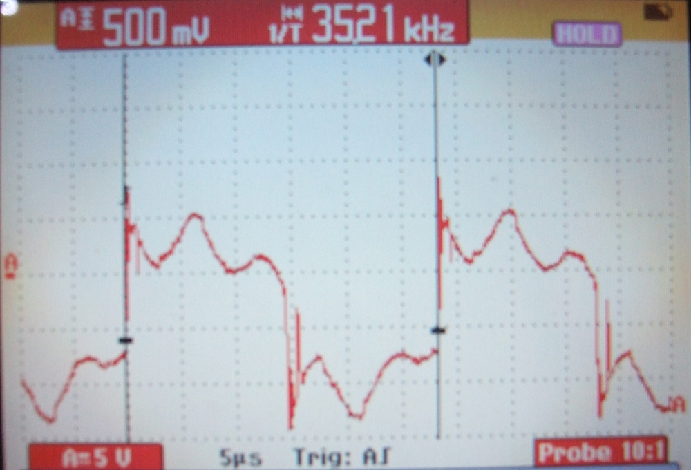

>You're going to need more drive, or less fet.
I have replaced the SPW47N60C3 fets with IXFH52N30P (52A, 300V). If/when they burn, I will get some IRFP450.

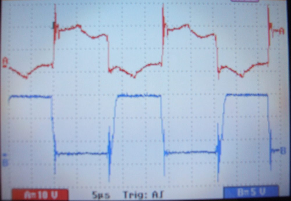

>those rises and falls are just too slow.

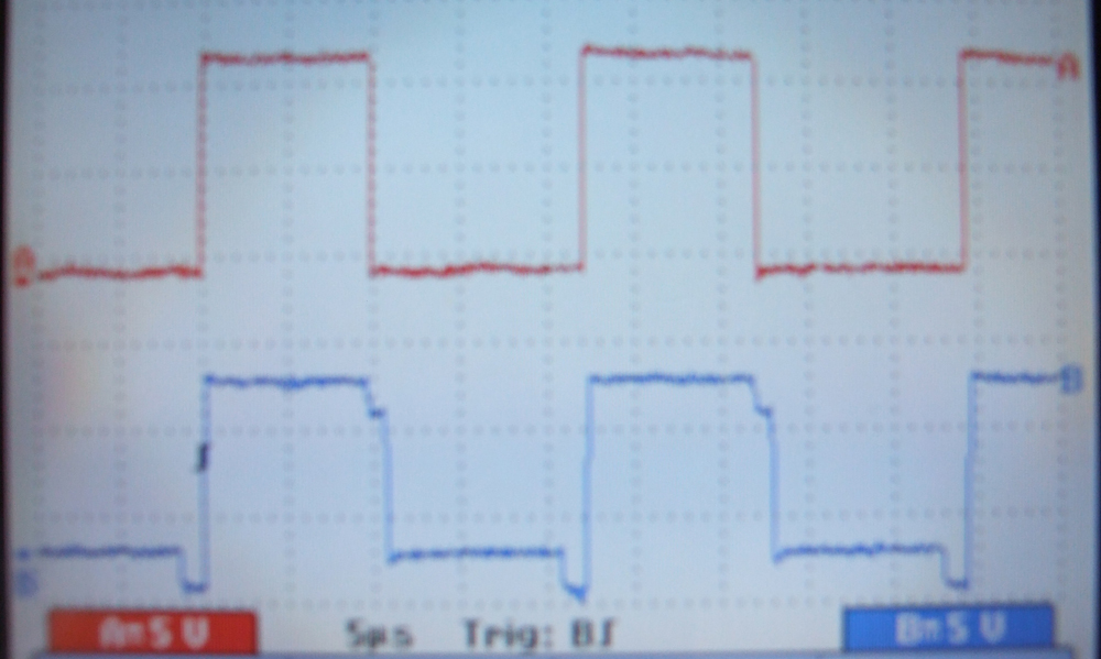

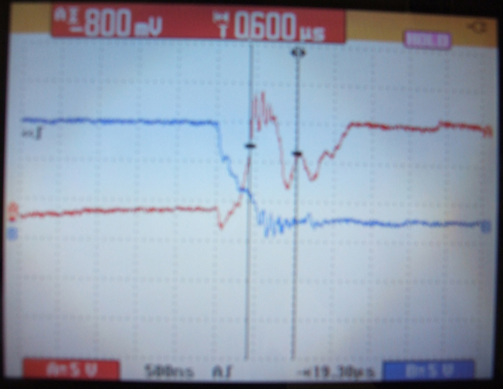

I have 6 ohm resistors at the gates and 470nF ultralow tantalums as bootstrap caps. When correctly tuned, this arrangement with the new fets seems to give a reasonable rise time. See pic 'LO2 & Output of same' (I measure the duration of the on pulse=13.8uS, rise time=1.6uS, fall time=0.8uS. So risetime is around 11% of on duration and 6% of total time. One complete cycle = 28uS = 35.7KHz)
The fets are staying cold at low or no load, but still at low voltage...

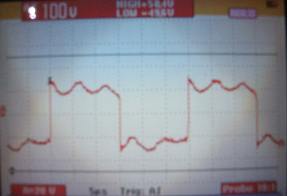

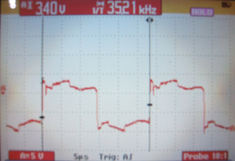

>if I could see one of the bridge outputs into the load.
See same pic as above - blue trace is gate, red trace is output of fet board at transformer primary.

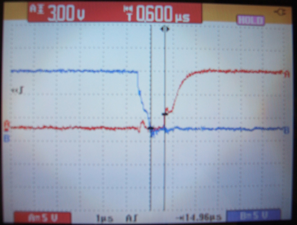

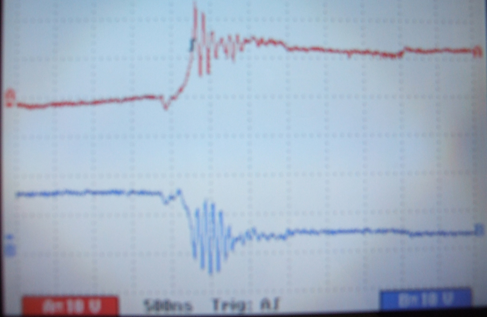

>A key diagnostic is what does the output do during that dead time.
I identified the deadtime (see pic 'deadtime between the gates'), and then looked at this same time at the output. See pic 'Output during deadtime' - blue trace gate, red trace output. It looks to me like the output flies to the other polarity, pretty hard.
I have added a pic of the chip output without the fets connected, red trace is low gate signal, blue trace is high gate signal. What's with the little 'trough' before the rise on the high gate signal? And the little notch knocked out of the pulse just before the fall? I understand this is the deadtime, but do you know why it effects the high pulse like this, and not the low one? This little 'disturbance' is what is generating the more serious glitches and ringing in the fets... I have posted a pic of the ringing on the gates due this deadtime 'trough'.
I have tuned for the lowest no-load current: 310mA @ 10VDC which is around 42.37KHz (this is where the glitches disappear, just the same as in your video) but cannot get rid of this nasty ringing effect). I am going to connect it to the stack and see what happens at higher voltages...

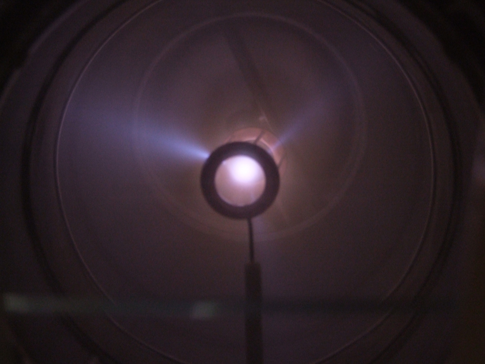

I just connected this to the stack, and the fusor. It worked brilliantly! That is, until I let in too much gas, the pressure jumped up and the stack's 50K resistor arced (that's never happened before). The backlash took out the little driver chip, judging from the smell (I cannot test it until the caps discharge). But all in all, very succesful - a massive improvement. With 20VAC on the variac I get -24KV, with 35VAC on the variac, I get -40KV (no load). The variac goes up to 270VAC, so it might be time to sink the stack into oil. I think that the maximum current being drawn on the fets was just under 5 amps at one point, and they are only slightly warm, running with heatsinks, but no fan. The high frequency component on the rising edge is still a problem, as this obviously grows as a spike as the voltage is increased. Curiously, I now get three electron streams, where before (with a 50Hz MOT supply) I only got one. That image is at around a few hundred microns I think. The pink image is at a lower pressure, somewhere between 10^-3 and 10^-4 Torr, with a touch of deuterium added.

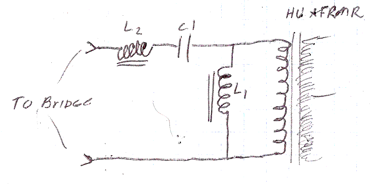

On the snubber, it's intended to get rid of some ringing and slow down the output edge foolery during deadtime. Since very fast output edges wind up coupling back into the gates, you are trying to kind of slow the thing down -- rise and fall times can otherwise be very fast when driving an inductive load. In other words, tuned below resonance a little, which is where all mine work best. As I noted elsewhere, I'll often put at least some of the primary turns on the other leg of the core to get a little more leakage L, makes things much easier to drive.
Of course, this depends heavily on the magnetics you've got, and sometimes the easiest thing to do is play with or rewind the primary winding, it's usually easy and not many turns.

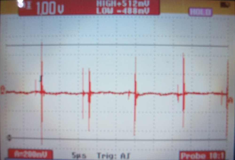

I want you to try something for me here. Short your probe, and hook the scope to some big square wave (such as a bridge output) and look at the resulting trace -- I want to see if your scope can really be floated on a big SQ wave, because if you really can, heck, I want one, I've never seen one you could really do that with without a lot of spurious stuff making it into the trace when you should see nothing (note, by doing this you make a tiny one turn inductive pickup, so don't do it near a wire carrying a lot of current). If that's happening, then some of the other strange things I see in your pictures are explainable that way.
Some of the gate drive waveforms look very-very strange -- I am trying to understand why there is stuff there during the on time for example. Nothing in the chip is happening, nor should there be anything happening on the output during that time, so where's all the junk (rather than a flat top) coming from? See above scope test -- you gotta be where you can trust your tools pretty absolutely.
Your "high gates ringing" might be almost entirely due to a scope issue here" It's actually sort of hard to make that happen unless the output is ringing hard and coupling back there via the fet capacities, so I find that slightly suspicious -- a possible measurement artifact that isn't really happening. It's actually pretty safe in this circuit to assume the top drives look pretty much like the bottom ones once your bootstrap cap issues are taken care of, and they should be at this point. Your extra diodes may be causing a little of this by allowing more outside the rails stuff.

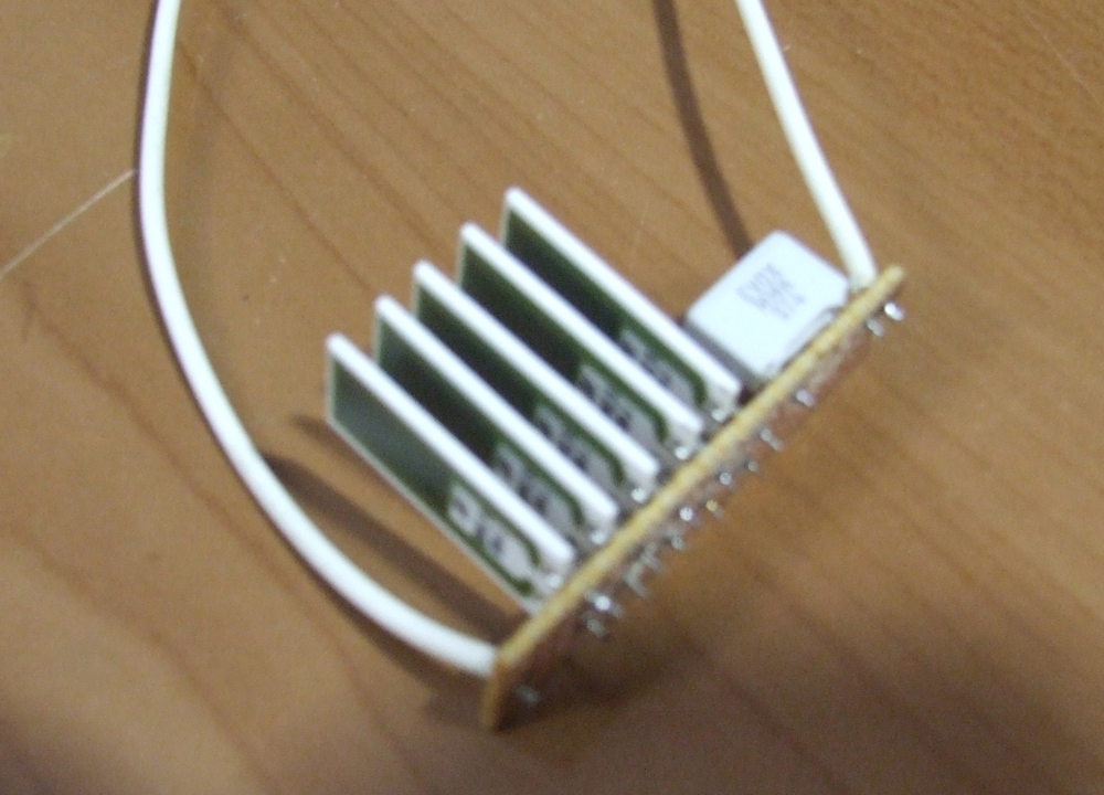

I just ordered a bunch of non-inductive 5watt thick film resistors - they should do the trick, and I can add or subtract them in units of 22ohms, until I find a workable value.

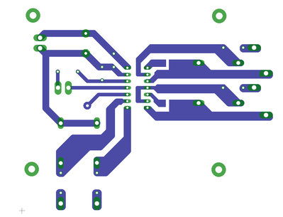

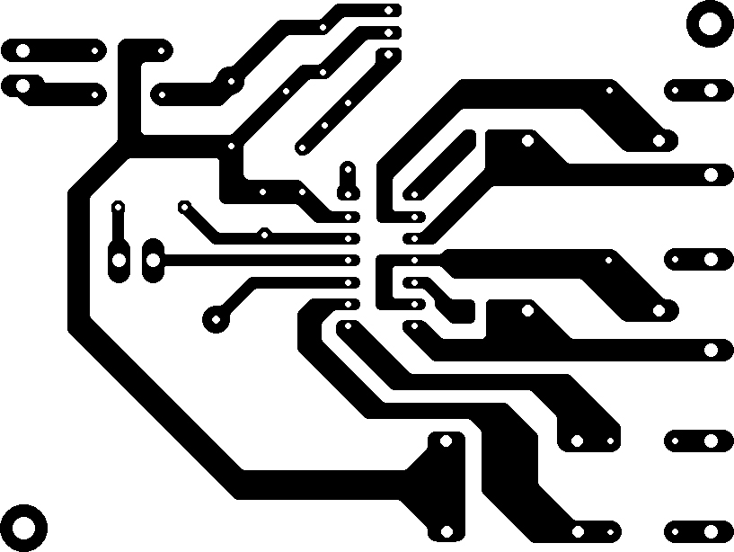

I have spent some time incorporating what I have learnt on this thread so far into a new circuit for the driver chip (see image below). I have tried to keep the output tracks wide and have used some 45 degrees to reduce parasitics. I have included space for some zeners, and a little bypass cap right up next to the power rails of the chip. This will all be shielded in an RF box, which will hopefully clean up the waveform somewhat. I will also dig out a 15 Volt transformer and add a regulator to the circuit. Will work out the current sensing resistor and optocoupler once the first version is built.

I have checked the resistors I was using and you are spot on - they are wire wound (that just would never had occurred to me, even though they look just like fat little inductors staring me in the face!)On the snubber

Yes, what I meant is short the probe -- ground clip to the center input, then hook that junction to something really noisy, such as the output of a bridge half and see if you still see no signal.
I'll be real surprised if you don't see that something somehow gets capacitively coupled into the scope innards and shows up, even though the signal is shorted out at the probe. I've seen it many times here, it's the norm.

I'm going to have to build the new driver circuit before I can do the probe test properly. I included a rectifier and regulator and have finalised the layout:

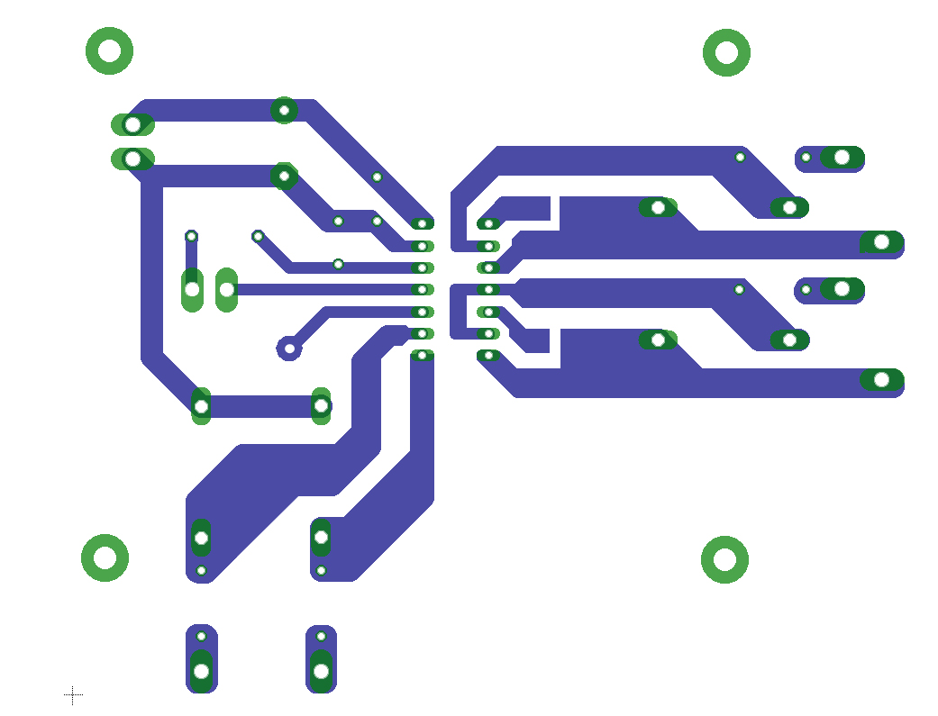

Re: Burning FET's and driver troubles
Nice looking layout. Not obvious to me where the gate R's are -- are they here or at the fet end of things? Probably doesn't matter too much, but beware coupling from the high current paths back into the gate via wiring issues. Seems everyone knows about stray C coupling (which shielding fixes easy), but with these and some pretty hefty peak currents during switch time, you can actually make a transformer with two wires running parallel that give you no end of mysterious issues...

I am now running the chip at 15v. I have added a transformer, rectifier, regulator, some smoothing caps and a 50ohm 5 watt resistor to the circuit. I'll post the updated schematic when its complete, and add details as to where all the components go and their values. I have included an image of the one of the outputs, measured when the stack was at -25kV. The circuit was very well behaved and the waveshape did not change all the way up to -40kV (the limit of my high voltage probe). The performance of the circuit and the waveshape is much improved

Looks like the 'mexican wave' on the top of my waveform is at least partly due to some characteristic in my transformer. When I designed it I included an extra feature which has come back to bite me: it has two primary coils, which can be connected in series and driven at 500VAC or connected in parallel and driven with 250VAC. Connected in parallel caused some pretty serious distortion (I could find no frequency at which the little dead-time glitches fell away). This was improved considerably by connecting the primaries in series(compare the images). Not sure if it can be flattened out further?
The probe test: Once I had the circuit running, I shorted out the probe and connected it to the output of the bridge at about 20VDC 40KHz. I do see some spikes, but only when I zoom in to 200mV per division. At 5V per division I see nothing but a flat ground line.
I have the new snubber in place - I used five 22ohm non-inductive resistors to give me 110ohms at 25watts. They do not get warm and do not seem to change the waveform - looks like I need to up that cap value (it is 1000pF at the moment). All these measurements were done with the large schottky diodes in place next to the FETs, I still need to remove them and see how that changes things.
So the driver seems to be well tuned and working perfectly (the FETs don't even get warm, shifting at least 3 amps). However, the next weakest point has made itself apparent - the high voltage feed on the inside of the tank. The high voltage is shorting past the insulating alumina tube and arcing to the nearby mesh screen. I was reading your thread on this the other day, about the quartz and/or pyrex arrangement - looks like I need something similar...
