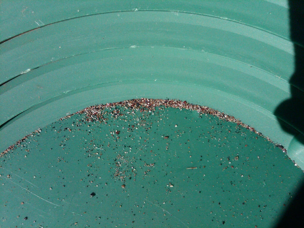

Hi, Just thought I show the contents of a small amount of concentrates I panned from Western North Carolina and ask a few questions. I promise to use a black bowl next time; as it has better contrast.
Pesky flakes of Gold
Notice a few "pickers" of gold. There is apparently a lot of "flour" gold too.
