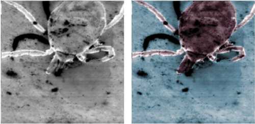

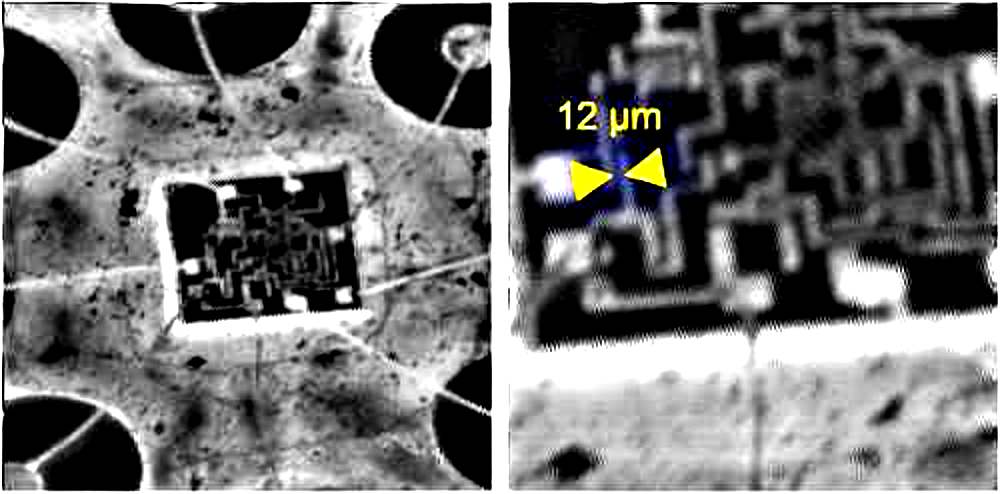

Hi,
some more images from the vidicon-microscope.
A picture of a tick which was unlucky to cross our garden table and a operational amplfier. The first one is colored with 'Photo Shop' for nicer viewing
and the second allows to estimate the resolution which is arround 10 µm.
Thomas

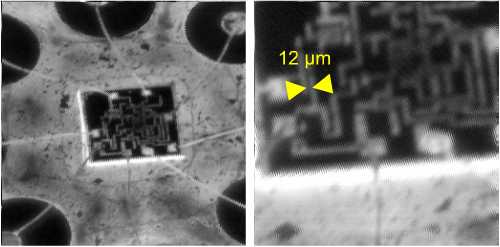

This is really great stuff Thomas! Do you have an idea what's limiting the resolution? It seems very uniformly smeared, and so susceptible to a little unsharp masking kind of post processing to restore at least some more detail. Do you think it's space charge beam spreading, or just the fairly large cathode size? In other words, might it get better at lower beam current (or higher voltages etc)? This really seems like a much simpler way to "get in the game" than building something like that from scratch.

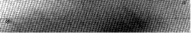

I tried some image improvement stuff on your image, but the jpeg artifacts also got "enhanced" so it would work a lot better on the raw image data. You can see the diagonal lines which I assume were from the jpeg process.
Scale and unsharp mask version from original jpg

I'm afraid the limiting resolution comes from the construction of the tube. The source is not the cathode but the crossover of the electronbeam just in front of the negativ biased wehnelt grid. The single lense is half the way between the crossover and the sample, so the demagnifiaction can't exceed 1:1. In real SEMs there are 2 to 3 lenses to reduce the source image and form the probe beam. If I compute the resolution of the vidicon I get some 10 µm, the tube is constructed for a scanning area 6,6 x 8,8 mm, resolution > 500 line.

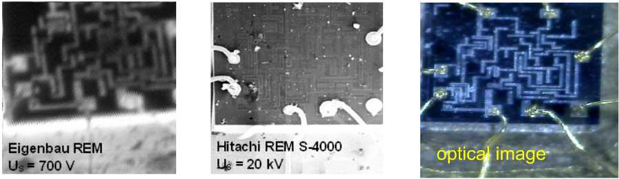

It's interesting to compare the image of the µA709 with one made with a Hitachi SEM made in my work. The contrast of the aluminium metallisation is rather low, because the high energy electrons (20 kV) penetrates the thin layers, the 700 eV of my microscope gives much better contrast.
I think the lines You get in a edge enhanced images result from mains (50 Hz) interference not from the jpg-processing. But I can send You a not processed raw file. The sample currents a rather low, arround 1 nA so I have to amplify a bit and have some trouble with the mains hum. I would be better to use the normal scintillator, photomultiplier combination which easly allow megafold amplification without interference.
