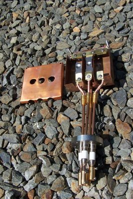

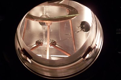

What I did for evap was prep a chemistry ring-stand to go in the tank (Cu plated it so it wouldn't outgas so much). I added a shelf low on it to hold a cut off coffee can to catch dropped metal, and to keep from evaporating on to the whole tank -- I just cut holes in the side for the high current feedthrough rods to enter, and the cut off top of the can matches the underside of the ring-stand. I put my substrate on various jigs that sit on top of that, again, to keep from depositing the stuff all over places I don't want it to go. One time of ruining every feedthrough in the tank was enough to learn that one.

This is using a 3 wire tungsten heater from Lesker, one of the few things they sell that is cheap.
I then made some improvments and used a different type of heater that I have since added a shutter to, which helps quality -- you can preheat and outgas things before letting anything hit the target, then flip the shutter open and shut quicker than turning the heater on and off -- so as to get more control over coating thickness.

I added a simple shutter, a small piece of sheet metal on a baling wire axle, and a couple small solenoids to flip it open and closed. This will let you deposit up to 3 different things in one run.
With the shutter, you find that anything reactive takes the vacuum down a lot better on heating it, then you flip the shutter open for only about 1 second to get your deposition done.
