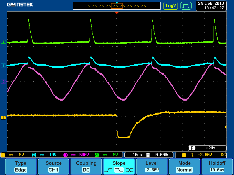

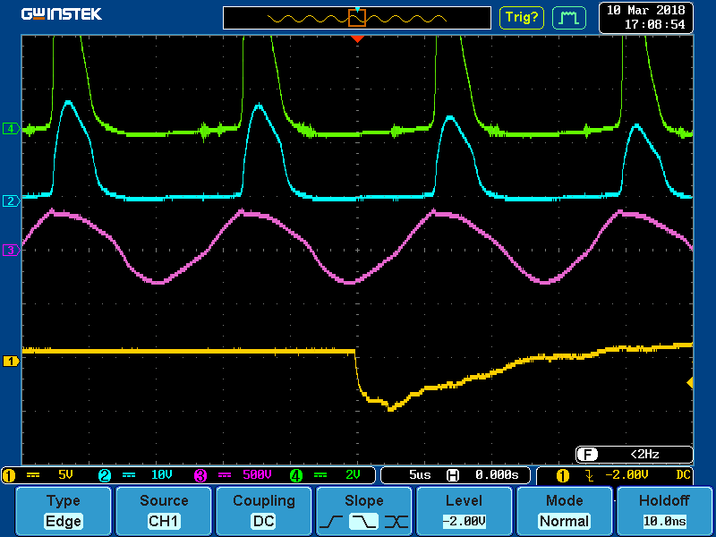

Snuck in a few minutes of fusor test time and got some interesting results. Not great, just interesting. When I get more, I'll make another thread under Nuclear.
Interesting that moving the setup across the yard seems to have increased the amount of power when there's no gas load....
At any rate, it seems that one doesn't want the max coupling capacitor, or more directly, doesn't want too much time/energy at the positive part of the cycle - it seems to drive the ions into the tank walls, and in fact it makes it harder to stay lit - I had to press the DC ion source into action here. This setup used 3 750pf in parallel, the previous test just one of them. I'm guessing that was closer to correct, and I may be fiddling with doorknob caps in series and parallel to get close, given that I can't just make the waveform I want and amplify it at this point - it's going to have to be created at the point of use by dodges like this (let's hope we don't wind up needing anything too elaborate or pulse forming by saturable reactors).
With more voltage, the neutrons that are produced come out _after_ the negative peak. So frequence has to go up with voltage, not a surprise at all.
This was far enough off that I didn't see any multiple ion bursts going by either faraday probe, but when I did get neutrons, I got more than last time, fat bursts. More on the audible counter too.

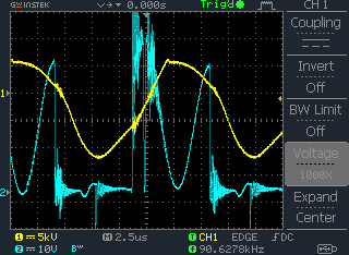

I'm having trouble probig the HV correctly. My old B&K type TV probes are way off on the AC content - read too high (while DC reads low due to the scope being 1 meg vs 10). I'm fairly sure that just adding a load capacity won't fix this - as just waving my hand a foot away changes the apparent divide ratio more than 2::1. But if you try to shield that thing, you add more capacity to ground than you'd want, and it'll arc - you need the spacing from the HV end for that reason. I need to get a solution to this so I can feed this info into the rest of the data aq and have some confidence in it.
I may revert to the last setup to get a more direct relative measurement at least for one run, just so I know where I stand.

Since the trigger is on the neutron detector - and I set that to only trigger on a fat burst, I used another scope to track the waveform and frequency as well as i could: I'll have to make a few tweaks and try more...as always.

Trouble with the multiplier resistors in those old TV HV probes is that they have an unknown reactance, which was not an issue for measuring the DC second anode voltage on a TV set, but is a problem to measure AC. If you just need to measure the AC component, consider a capacitor/resistor divider and allow for 6 db per octave response when interpreting the results. There are compensated HV probes for scopes out there good to 150 MHz, but I haven't see one that can take more than 18KV or so.
Yeah, and the resistance is super high. The issue here is that there's a lot of AC capacitive coupling into the divider itself. So, you can't just hang a variable cap across the output like a scope probe to get a flat attenuator. And in this case I do want/need DC->HF response, flat. The only way I can see to get this is to somehow shield the probe, but the shield would have to go up so close to the top that there would be arcing issues at ~ 50kv. Like I said, just waving your hand back and forth 2 feet away changes the readings ~ 2::1 (DC average stays the same, but...).
I'm trying to figure out where the "diode" of the fusor electrons starts drawing real current when going positive, and what the peak negative excursion is. The current arrangement gives me neither.

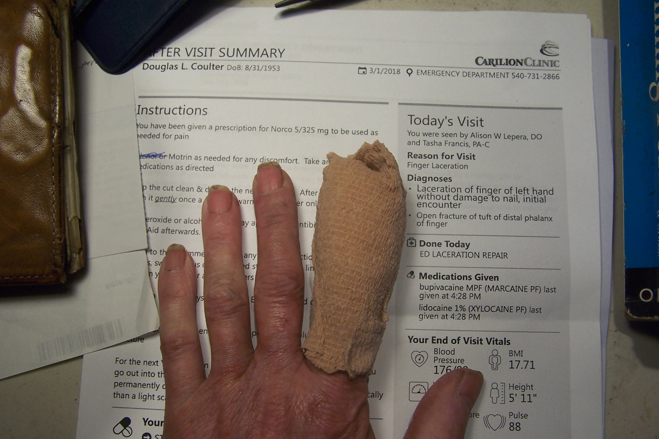

I think I just want to go sit somewhere till this is over...Doug, the 9.8 fingered now.
This year is not off to a good start for you. Maybe I should send you a bunch of "rotating parts" warning stickers to put on/in your equipment.
Well, I met a cute surgeon....the expensive way.

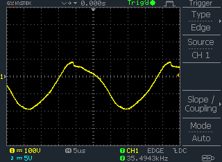

So, the 2ch scope here is showing the HV probe and one of the outputs of the full H bridge (nasty!). Maybe that leakage inductance is what makes this all work, though - this is definitely not at one of the transformer resonances. At those, the stepup ratio is vastly bigger, but it's like driving a short circuit. Seems less efficient there... The big scope shows an almost double humped faraday trace (ch2) here - and the late bump does move more into alignment with higher volts OR lower frequency. But it appears I need a better vernier on this - it's touchy as heck. I decided if I'm going to do that, I'll add the second power supply on input to get up to twice the drive volts.
