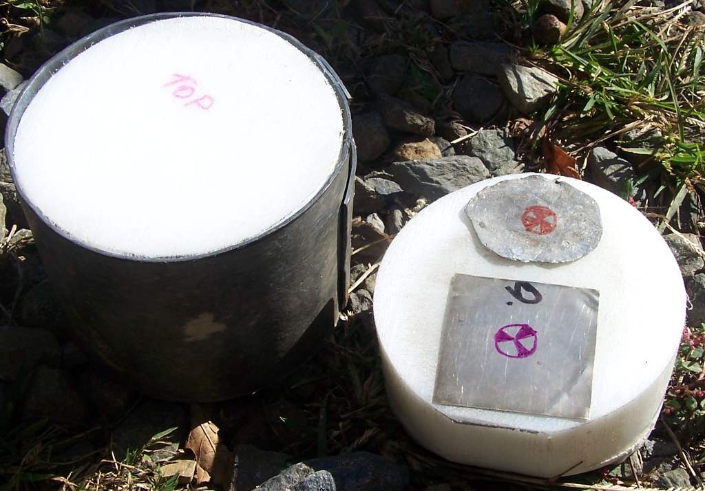

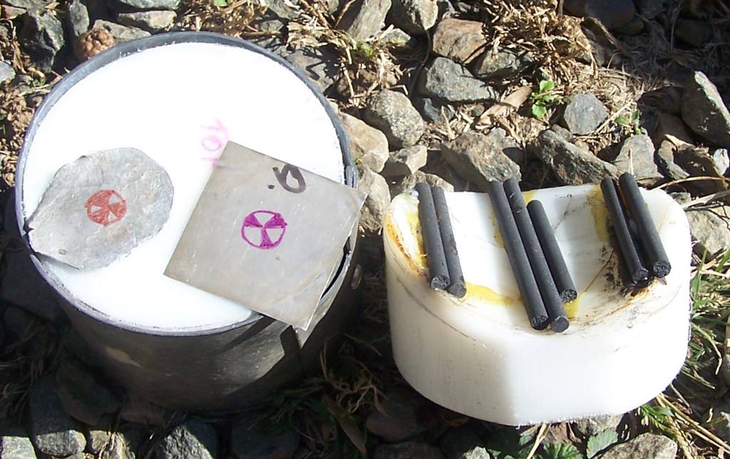

Neutron Oven parts
Above are the parts of the neutron oven, with the bottom upside down so you can see how I cut it to fit my tank, and the carbon rods I used as spacers so it would stop melting.
Oven with samples
Here is the oven with the base right side up and the activation samples sitting where they sit during the process. The odd shaped one started as a pea sized piece of indium I pounded with a hammer. The other is a 2" sq by .01" thick piece of 99.9+ fine silver.

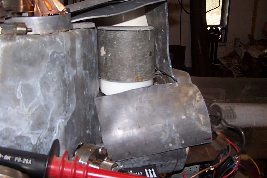

On the fusor
And here it is ready to go, on the fusor. My cylindrical grid is in the sidearm the oven sits atop, in a hole in the shielding so it gets everything full blast. The HV for the main grid comes in from the back/right in this view. As you can see, I have reasonably decent lead coverage, even though I sit well on the other side. X rays do scatter, and my wife sits above this to watch TV on the floor above...The lead pretty much stops all the power supply energy X rays, but not the neutrons or the real hot gammas from fusion. Obviously there is more I could do with shielding here.
The HV probe in the foreground is looking at the power to a supplementary grid I have out in the main volume of the tank, as an ion source and pulse inducer for the main rig. Pretty cool, works a charm, and there's a lot more left to discover with that setup.
