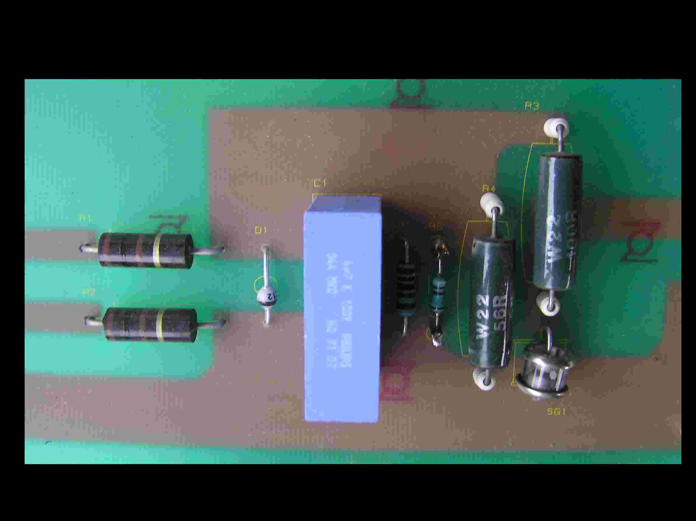

Postby chabekostc » Sun Oct 31, 2010 10:18 am
Doug-
I DID find some errors, esp. the diode being backward. I took the time to do a schmatic capture, wich I find forces you to be very exacting. I have attached a photo of the board, input is from the right, and goes left from there. Ground is both bottom traces, and the the 2 100 ohm output resistors are on the left.
I think it is easier to see the layout on the capure PDF.
Any help with what to add to those 100 ohm resistor will be greatly appreciated!
Thanks,
Charlie

Postby Doug Coulter » Sun Oct 31, 2010 12:43 pm
Looks to me like that's intended to be a current sense output, and that the thing doing the sensing is not necessarily hooked to what you are showing as the ground symbols, but floating and connected between the two 100 ohm outputs there. The top one should go negative with increasing current. The float off ground is common to avoid ground loop voltages induced by high current events and other noise.
Usually, one would look at this with a differential amplifier (op amp and 4 resistors for example) that ignored common mode noise, and scaled such that the output means whatever the other circuitry needs it to mean. To get some common mode range, this would not be a single supply opamp, but one with plus and minus supplies so when both inputs are near ground it's in the middle of the working range of the sense amp. Basically, the current sensed through the resistor(s) to ground will be related to the number of multiplier stages in use and be highest at the bottom of the stack when measured this way -- which makes it easier to measure. On other words, if you get x volts per ma with one stage, adding another would give you 2x the volts per ma, another 3x and so on. Probably the best way to get a calibration is to load the stack with a known R and measure the voltage there and the stack output volts, and compute the net sensitivity in volts/output ma, then design the rest accordingly.
Re: New HV stuff, questions
Postby chabekostc » Sun Oct 31, 2010 1:23 pm
Doug-
I agree with the try it and find it approach. What botthers me is that it looks like the diodes that are hooked up in reverse to the stack seem to be shorted to ground with only 150 ohms, REGARDLESS of the sense circuit. Ummm, 15 KV through 150 ohms. . . . smells like someone let the captive smoke out that is installed at the factory in most all semi devices. UNLESS, I have NO idea of what is going on in CW circuits, and this is showing only what is left over after a charge cycle or other some such esoteric trick (it's got to be a trick if I don't know it!).
Postby Doug Coulter » Sun Oct 31, 2010 2:13 pm
That's why the spark gaps are there....to protect the current sense in the event of an arc. You can't make the R's bigger or they burn up under normal loads. In a 4x stack, the current through those bottom diodes is 4x the load (at least!) current, so you can't go big R there, but do all sorts of things to live through any arcs. This is also one reason most designs are push pull. That way the currents from the caps on the "AC" side of the stack discharging cancel (hopefully) in the transformer. In a single ended design, this gets blown through the transformer backwards and fries the driver electronics too! Trust me, been there. Unless the transformer is already at saturation (which it wouldn't be in most efficient designs) this can result in some multiple of the normal power supply voltage being tossed into the driver rails -- in a 10x stack, it could be 10x the normal driver voltages....very bad. So, push pull is what we do when we have any choice about it.
In an arc, it's the entire stack volts that will appear across R's to ground there....not just one stage worth. It can really make a mess if you don't think everything through (and test to find the ones you missed). It's usually not enough joules to actually burn up a resistor by heat, but arcs can blow them apart...or arc across them.
This is one reason we do this at about the highest practical frequency -- so the caps can be smaller all over, and store fewer joules to fry things with in a failure situation (arc). It's also one of the reasons we use a ballast impedance in our fusors. Dropping a multi joule pulse into one in an internal arc usually means you're going to be getting into the tank to replace things if nothing else. Without some kind of fast current limiting, the current can build up quick to the point where metal is evaporated in there, which makes the spark a better short circuit, all the way to the point of it's an arc welder with many amps at only a few tens of volts. So limiting peak currents is key to having a fusor live. Huge peak amps will make stuff fly to pieces from the magnetic fields alone!
Those diodes are there to charge up the series caps as part of the voltage multiplication, they aren't shorted to ground by anything more than those caps, through the xfrmr impedance, and then 150 ohms. That's how all multipliers work. When the transformer polarity is opposite of the desired output, we charge a series cap though those diodes, when the polarity reverses, that cap adds to the transformer peak voltage and charges the "DC" cap to the full pk-pk transformer voltage, instead of half that (peak vs peak to peak). How much current it takes to keep those series caps charged is what we are measuring here, and it will be N times the stack output current (N being the number of stages), plus some extra for losses. Because that cap also has to see the current from all the other AC caps in the stack...so at the bottom the current is multiplied by as much as the voltage gets multiplied at the top -- no magic here, it's just a fancy rectifying impedance conversion from low volts-high current to high volts-low current.

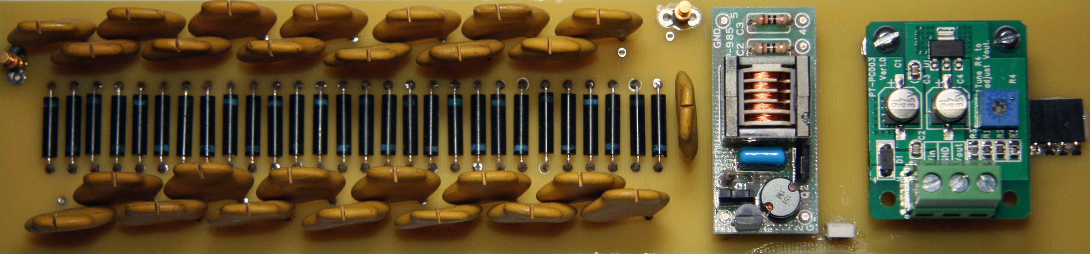

Postby William A Washburn » Mon Feb 28, 2011 11:53 pm
I have finally completed my first CCW stack. Under the text is a photograph of the device. I used Doug’s design (with a few modifications). This can be found under the “projects” section of the [Ye Olde(r) Coulter's Smithing Home] link on the opening page. Doug was kind enough to send me the basic pattern for the stack and this is where I started. I used a pre-built LM-317 voltage regulator board (PT-PC003 Ver. 1.0) and the standard JKL BXA-12529 CCFL power supply. I found an old laptop power supply to run as the primary source of power for the stack board. Since the voltage drop across the LM317 board I used was around 3V and the old computer power supply put out 18 volts this was sufficient to assure that I could get 12+ volts the CCFL.
I placed the two smaller board modules on female/male headers so that they could be easily removed and replaced if “fried”. If you are looking for the regulator board use the PN (PT-PC003 Ver. 1.0) and go to eBay. They have been discovered and I doubt you will get the same prices as I did four months ago ($4.00 ea, shipping free).
Did some testing today and seem to get 28KV (according to my Fluke 40KV probe) across a load resistance of 150 Megohms. Ohm’s law says this is 187mA. Can somebody tell me if this small stack is capable of such performance?
Well, at least I now have a place to start with some HV experiments until I come up with the money needed to convert one of the bedrooms to a true lab or build in the back yard. This depends on waiting for some money from a trust that is supposed to be a month or so away.
If this will become the low-end first HV project for folks on this list the obvious change would be to build the LM317 variable regulator portion onto the main stack board. It might not be a bad idea to allow a wider primary voltage range by using the larger components and a heat-sink to for the LM-317. I say this although so far I’ve had no heat problems on the mini-317 board YET.
