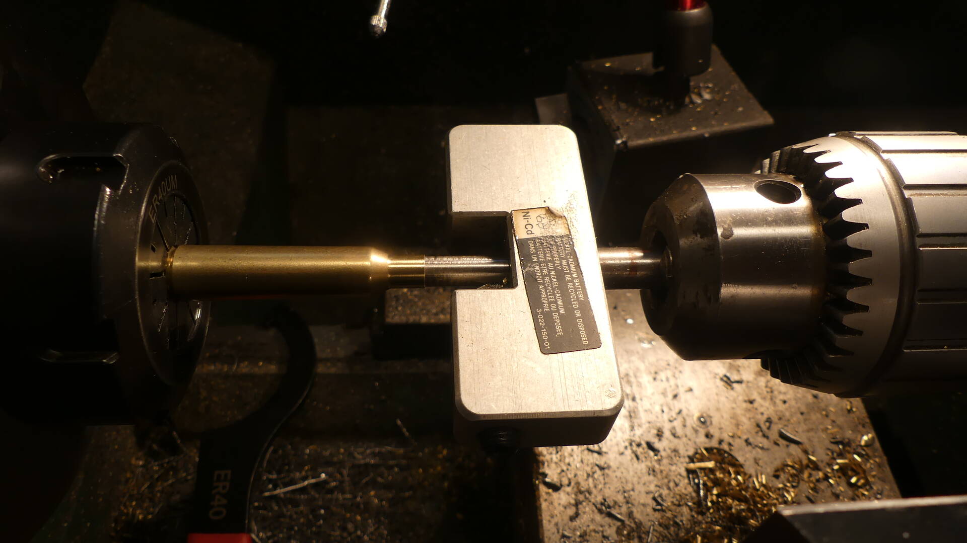

I wanted a way to hold brass (for the 6.5x55 but this will do any ~ .470 base brass) really straight and no slip to turn the necks over a mandrel. I had the tool (I think I got it from Sinclair, but who knows, it's been around awhile),
and made a mandrel for it the right size - .002 under the caliber, and set the cutter for 12.5 mil thickness with a feeler gauge.
It's a done deal now.

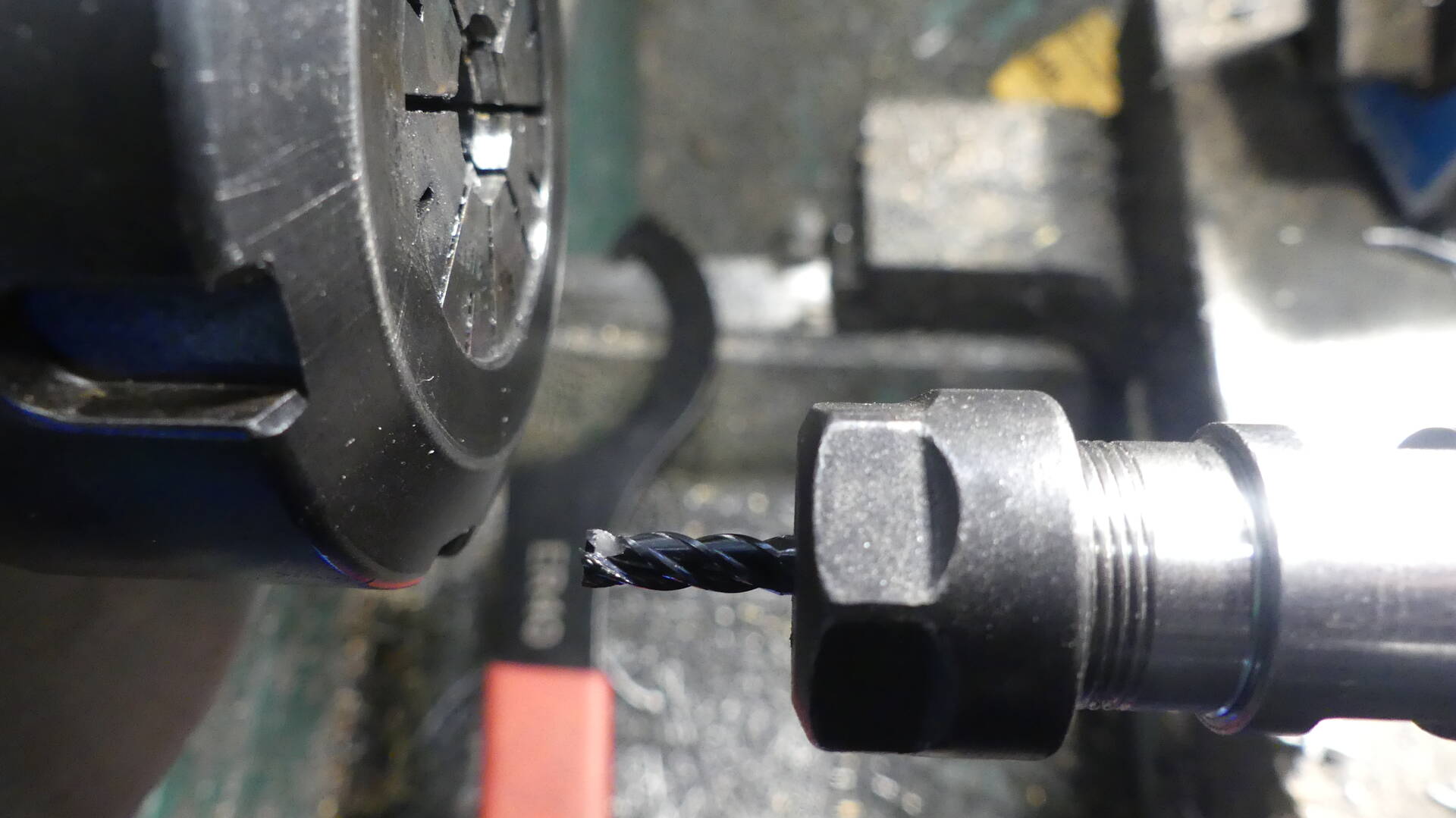

So, since they don't actually make a collet like I wanted, I decided to modify a standard 3/8" ER 40 collet to put a little .472 step in it. That was a real job. I tried to soften the glass hard steel with my oxy acetylene torch, no go, though I melted some corners. It must air-quench and I didn't get the entire thing yellow hot, just a quarter inch around the part I wanted to cut.
Chucked a 3/8" blank in there to hold it all centered, sized, and tight for no chatter, and proceeded to knock the flutes off a cobalt drill. Oh well, put in a diamond wheel in my toolpost grinder (which should get its own thread).
Even at slow rpm and insanely low feed with lube - diamonds come off, not much metal.
I'd bought some cheapo little solid carbide endmills on Amazon, sold for woad carving (!) which is also where that spindle motor came from, and tried one of those, at 45k rpm and real slow feed.
Yep...this worked, but it ate yet another of those out of the pack of 5. Glad they're cheap ...
Those endmils are brittle even for carbide

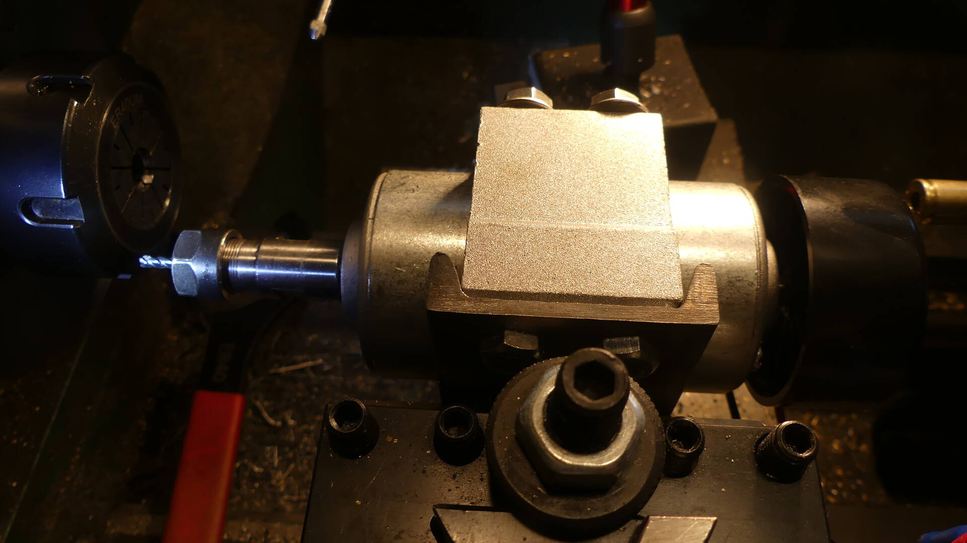

Toolpost grinder using an upgrade kit from a cnc wood carver and a little adapter I made.

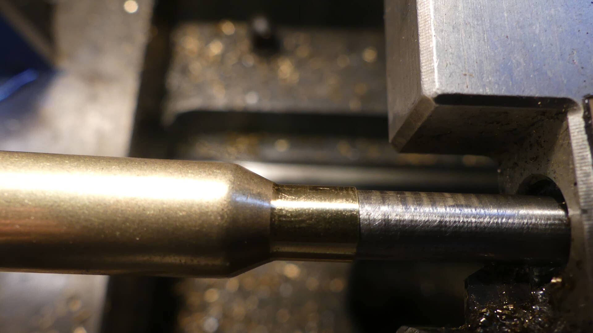

So, this thing lets me quickly chuck in brass to a known stop, and straight, so I can turn it over a mandrel I made that's the same size I use in the internal neck sizing die I also made, all perfectly straight and not too difficult.
Jut run it in with the tailstock....cut set with feeler gauge.
The surface finish is nice, and the precision is also very nice, I can set thickness easily to tenths accuracy.
TaDa!
