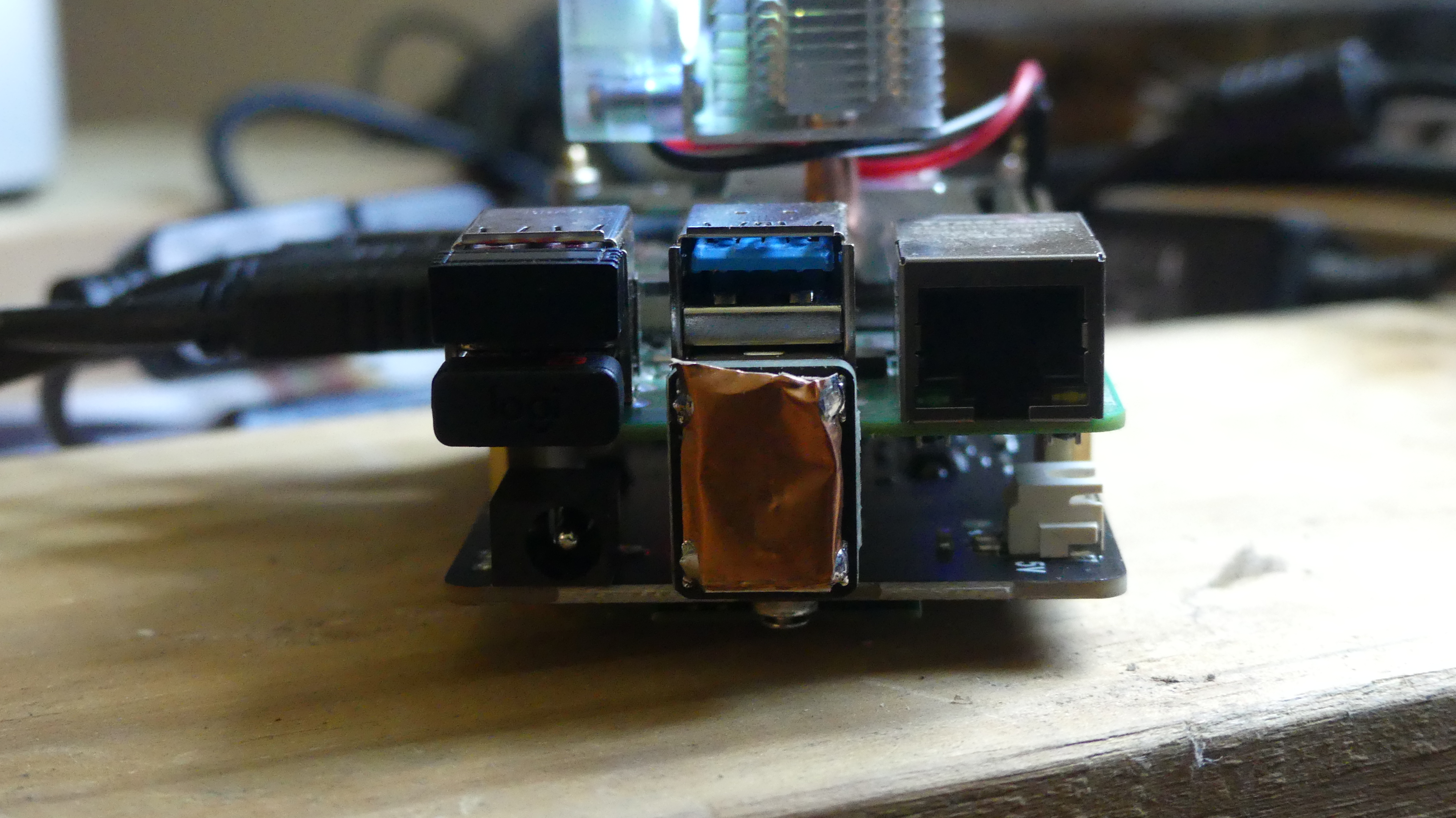

Posting from that pi. Shielding that USB kludge was no good. Creating a conductive bottm plate (because it was easy) also no good - made things worse. Did some short grounding from the tops of those standoffs to USB and Ethernet jacks at the front - worst of all. Super high frequencies are .. always interesting, and I didn't want to spend the time to do it "right" with "tiny fractions of a wavelength grounding" and so on, with no incidental "slot antennas" if that's even possible.
Seemed like a good idea at the time - you can also do it "wrong" and get lucky with cancelling radiations from different parts of a thing, and I just want this to work, not picky about how I get there.
Here's what I did for that connector - there's a bit of cardboard from a beer carton under the copper tape. This pointed up the fact I haven't transferred all my nifty tricks to here yet - like new file templates that do most of the boilerplate for various things, and a nice script for the file manager that shrinks jpegs down to size for this, hence the ridiculous unneeded res here. I'll get there. I did have to add exfat stuff via synaptic to eat my camera output. No biggie.
Oops. I don't have my auto-compressor script here yet.
As with other radiation, though, inverse square law is your friend. A little USB hub on a 6" lead danging from the mess with the wireless dongles in it solves all, better than ever. Ugly. Sigh.

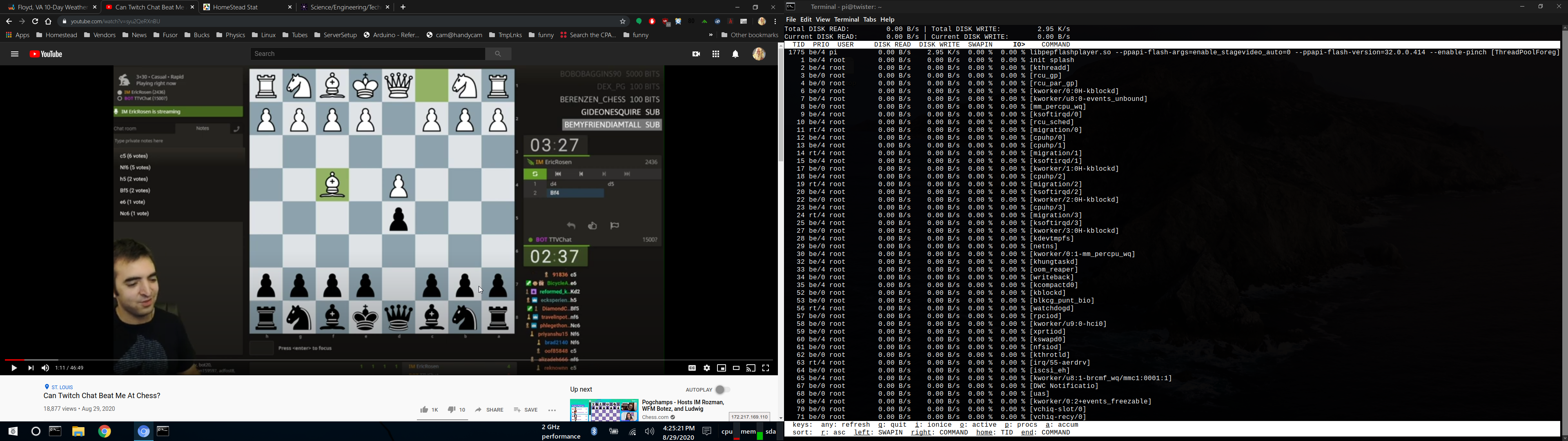

For fun, EricR plays against the twitch hive while I watch chrome destroy the SSD via iotop.
I didn't really catch it in the act, but even when paused, there are around 4 lines popping up of some chrome subprocess writing in the 150kb/sec range apiece. WTF? No wonder pies kill SD cards.
