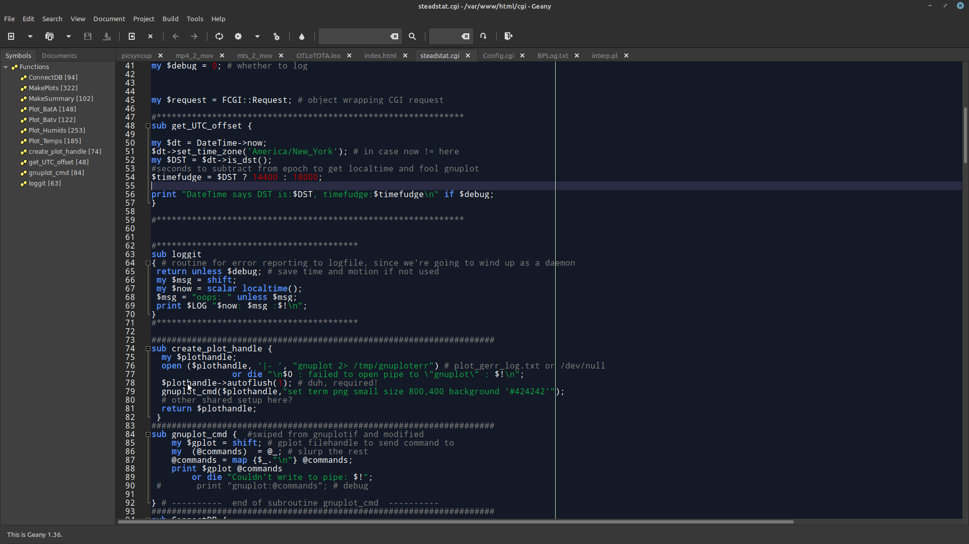

I'm still a big fan of perl as a glue language for this sort of work, at least if I wrote it according to my ideas of how to write clear, maintainable code, which I think I've managed to do here. Look at this stuff in some editor with syntax highlighting and see for yourself, even if you don't speak perl. I'm using geany just now with the SpyderDark scheme, as I like a few things about that and dark themes generally. I also use Gedit with inverted syntax colors, SublimeText and others as the mood or whatever is on that machine inspires me.
Makes things easy to understand - don't leave home without it.
I like this one as it makes questionable practices, like hardcoding numbers, really stand out...

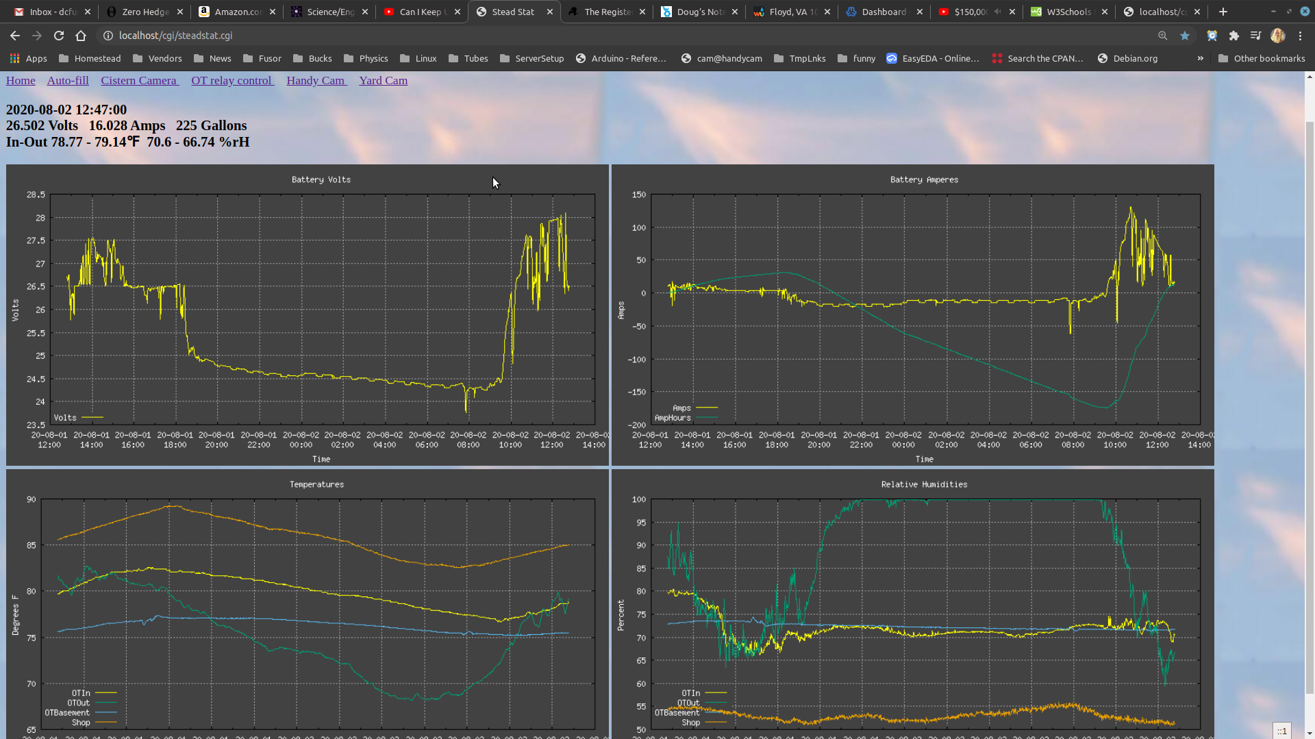

I have so much data here, I can't simply show it all, and what options I've set up so far haven't been adequate for the kind of data mining I want. I usually want short-term plots - "how are we doing today?", but it would be nice to have a sliding start window and variable duration - as I have years worth of data, it'd be nice to see, for example, temperatures in spring and fall to know some useful timings for gardening for my precise little ecosystem. I finally have enough years worth of data, taken minute by minute, for that idea not to be a total joke.

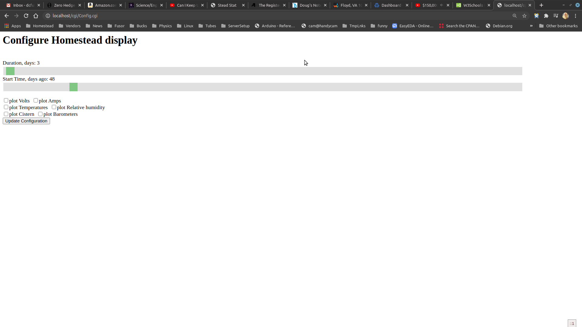

This looks unfinished, because it is...tweaks will be easy as things go along because it's clean code.
OK, it needs all kinds of pretty-up, I'm averse to web-monkey but I'll get there.
Lucky, this is not what I see most of the time, which looks more like this.
Partially customized, also work in progress
The links shown go to other web servers that show cameras, control relays, let water in from the rain barrel to the cistern (after checking it with a camera) - things like that. But if I plot everything I have at any decent resolution, it's not a fit-on-one-page thing at all...so that's where this is going, to let me set up dashboards for tasks at hand, easily. "I think I can, I think I can".
