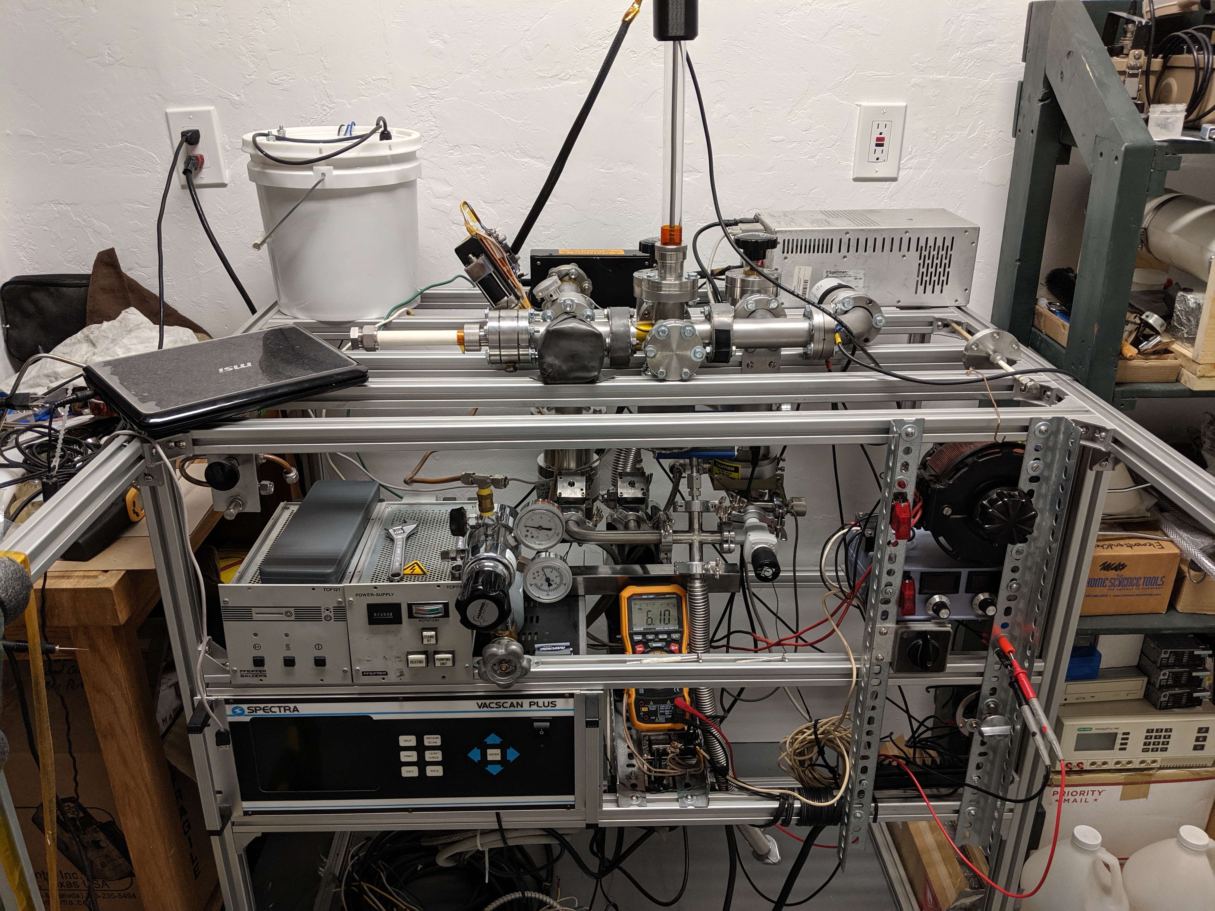

Main Chamber and Vacuum System

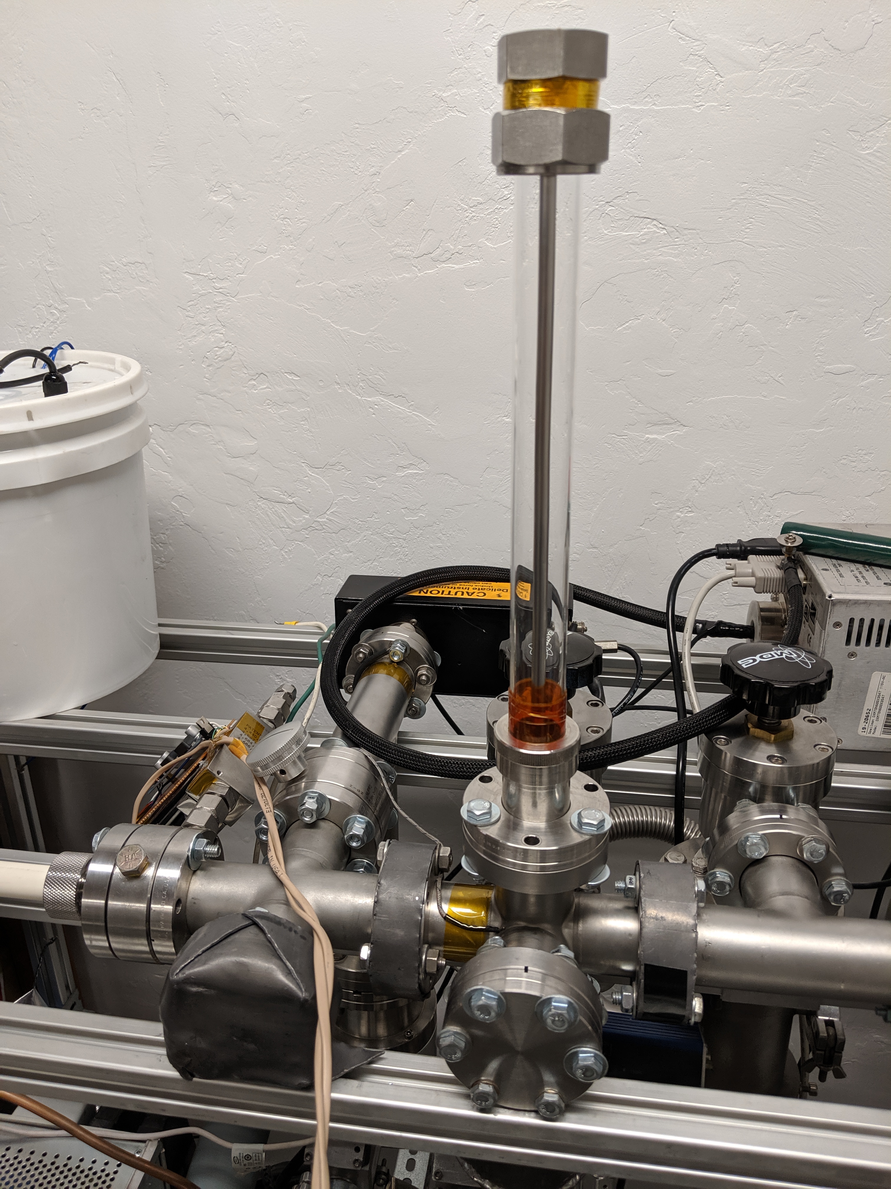

The main fusor chamber is a 6-way 2.75" conflat cross. The viewport faces the floor, is protected internally by a borosilicate glass disc, and is covered by a soldered 1/16" lead cup to reduce x-rays. An older phone looks through a small hole in the cup and a mirror gives it a view of the grid. It streams to another phone using some generic app. I used to have another viewport on the front of the chamber, but during a higher-power run an electron beam cracked it.
A tee on the right side of the chamber connects through a right-angle valve to a 50l/s turbo pump (Pfieffer TPU-040). The other tee port connects through a radius right-angle bend to a Pfeiffer PRK 251 full range gauge. Opposite the tee is a 4-way cross with a viewport, secondary HV feedthrough, and butterfly valve which connects to a RGA (100AMU Spectra Vacscan from the 90s) and a second 56l/s turbo pump (Pfeiffer TPU-056). The base pressure with both turbos at full speed and not throttled is, according to the gauge, about 2e-6 torr. Since the residual pressure is mainly water, however, I'm inclined to trust the RGA's reading of ~5e-8 torr. The latter turbo and butterfly valve allow me to differentially pump the RGA, meaning I can sample the main chamber while it is at fusion pressures. With the valve cracked I can keep the main chamber in the 100mtorr range while the RGA sits comfortably at the low e-5. It's worked well so far, confirming deuterium purity in the chamber (>99%) and giving me an appreciation for the complexities of gas measurement. The tritium that I thought I saw at m/z = 6 (from the lecture bottle enrichment) was instead D3+. More importantly, it has revealed many hydrocarbons in the 20, 30, 40, 50 m/z range that I need to get rid of due to their charge exchange cross-section. A backing pump oil change didn't solve the problem and it's been a while since I've had acetone anywhere near the chamber, so the source remains a mystery. I'm slightly suspicious of the 50l/s turbo, however, as it outgassed badly for the first several weeks.
Since much of that makes little sense without pictures:
There's lead on two of the joints since they use viton seals. X-rays like to shoot out of there at pretty low voltages.
Turbo controllers and RGA power supply in lower left. Deuterium gas and regulator in center. X-ray transformer in the white bucket and Spellman in back right.
Both turbos are backed by a 2-stage rotary vane pump (a cheap refrigeration pump that can pull <20mtorr) through KF16 fittings and hoses and the pressure is monitored by a 275 mini convectron gauge. I recently replaced the manual valve in the backing line with a NC solenoid valve to protect the turbos in case of power loss. I had the breaker trip twice, and since the roughing pump doesn't have an integral safety valve, the line hit atmosphere within seconds. Needless to say, the 50l/s turbo, which was the only one running both times, audibly complained and decelerated from 90kRPM to almost standstill in less than 15 seconds. Thankfully it didn't crash, but never again. My reaction time with the HV on is only so fast, and since I'm setting up remote operation and can't exactly run 20ft in a second, the upgrade was a must.

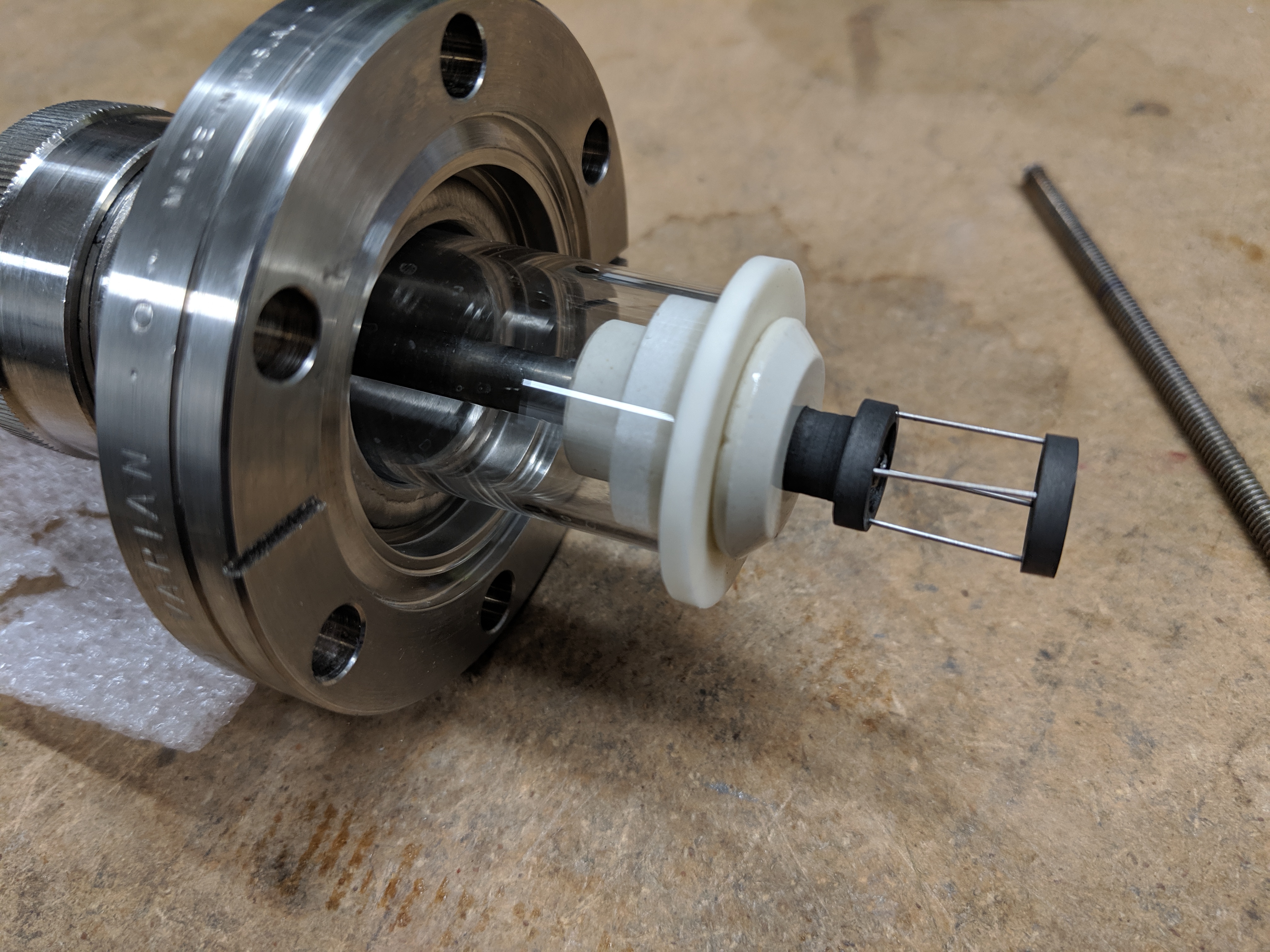

Feedthroughs
The feedthrough is inspired by Doug's and Andrew Seltzman's designs. The current revision consists of a 25mm OD, 21mm ID, 350mm long quartz tube sealed with a conflat compression adapter. The outside HV end is a 1" Swagelok cap with an o-ring to seal the male threaded section to the tube. Only the top ferrule is still in the fitting, acting as a washer to eliminate friction as I tighten it. To connect the resistor and cable, I 3D printed a piece that slides over the cap and screws into place. A threaded rod touches the Swagelok cap and allows me to attach the resistor directly to the feedthrough. I cut down on the corona using large washers on top of the threaded rod It's not an ideal solution, but works well enough for now. Inside the feedthrough column is a threaded rod nested in a 1/4" OD SS tube to reduce the E field. It is held in place by a 25mm OD washer pinched between the quartz and Swagelok cap and kept centered using a ceramic bushing at the grid end. Having learned of deuterium reducing quartz insulators to silicon, I decided to install a ceramic shield between the grid and quartz. It consists of a 1.25" OD ceramic washer and another ceramic bushing, allowing it to just fit inside a 2.75" conflat. It effectively blocks off the sidearm where the insulator passes through and leaves no easy path for ions or fast neutrals to do their thing. The tube is prevented from shooting into the chamber by several layers of kapton tape around the glass.
Feedthrough fully assembled
Ceramic quartz shield
I've pushed it to 50kV without plasma and there are no signs of arcing or other issues. With plasma the max was about 40kV, which is when the electron jets off the ceramic imperfections caused issues. I considered using boron nitride but figured I'd hold off until the quartz alone proved inadequate. The secondary feedthrough I mentioned before used to be the main one. It's a 0.75" OD alumina tube with nested 0.5" and 0.25" tubes, Swagelok cap, and conflat compression fitting. It proved incapable of exceeding 30-35kV, suffering lengthwise arcs between the tubes (Paschen strikes again) and what appeared to be intense static buildup and discharge between the layers. It will now serve as a lower voltage feedthrough for a "control grid" once I get some more things sorted out.
Secondary feedthrough extending over 8" into the chamber so the outside portion is rather short.

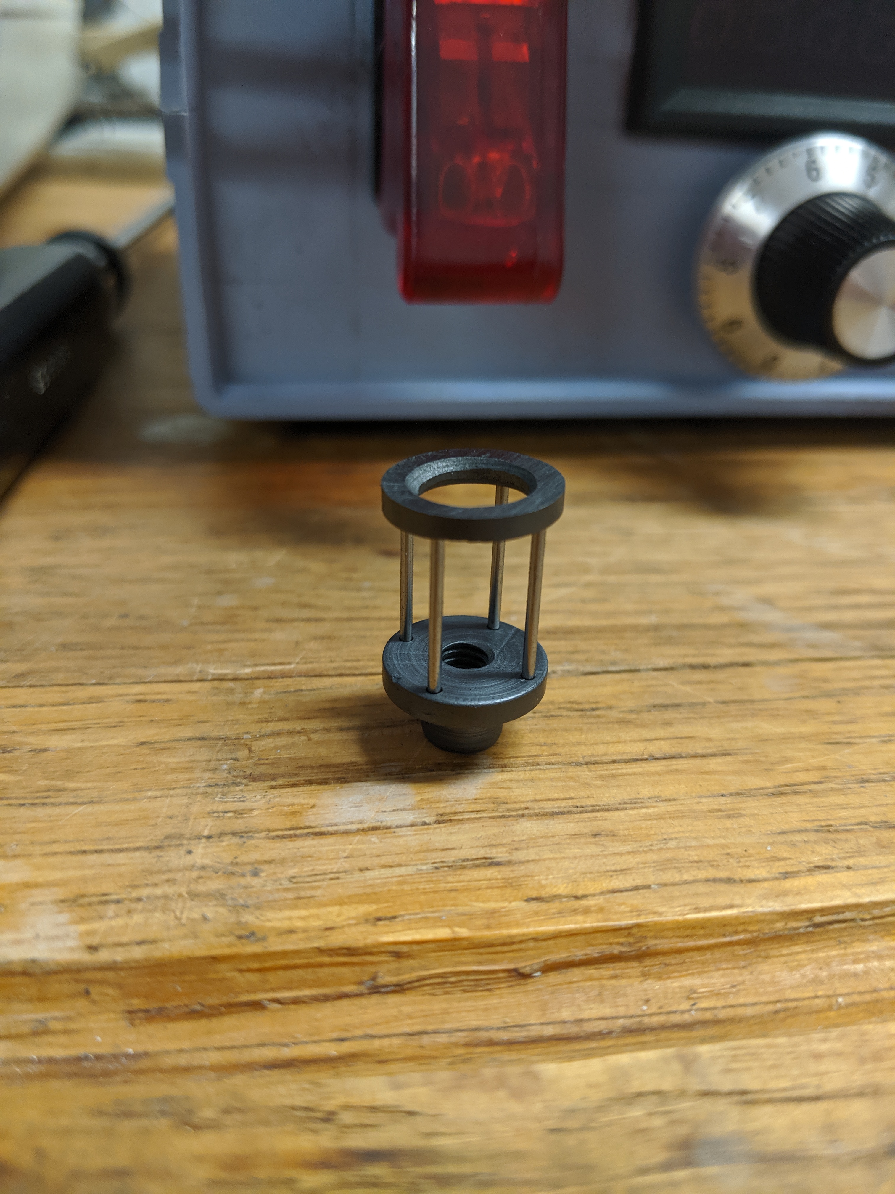

Grid
The grid is cylindrical and made of tungsten and graphite. It's handmade--as in without using a lathe or mill--and thus not particularly accurate, to say the least. Four 40mil pure tungsten welding electrodes connect via friction-fit 38mil holes in the graphite endcaps which are 0.5" OD. I made another 0.4" OD grid with 20mil tungsten, though I've had greater stability challenges with it and have mainly been using the former. I've gotten them red-hot without issue, so I think they'll continue to work well.

Gas Control
The 20sccm MFC I recently installed is a huge improvement over the needle valve I started with. It's calibrated for hydrogen, not that that's too important, and affords really nice, precise control of the pressure from the same box I control the Spellman with. I use a +-15 V supply powered from the main 24V fusor bus and a 5V regualator/potentiometer for control. I of course throttle the pumps to 66% speed and just barely crack the valves to save deuterium. The stuff in the regulator stem has been more than enough for hours of fusion, and it seems like it'll last several more.
As can be seen in the pictures, everything is mounted on a 3030 aluminum extrusion frame and some shelving brackets.

I really need to get around to a local machine shop and make better grids...

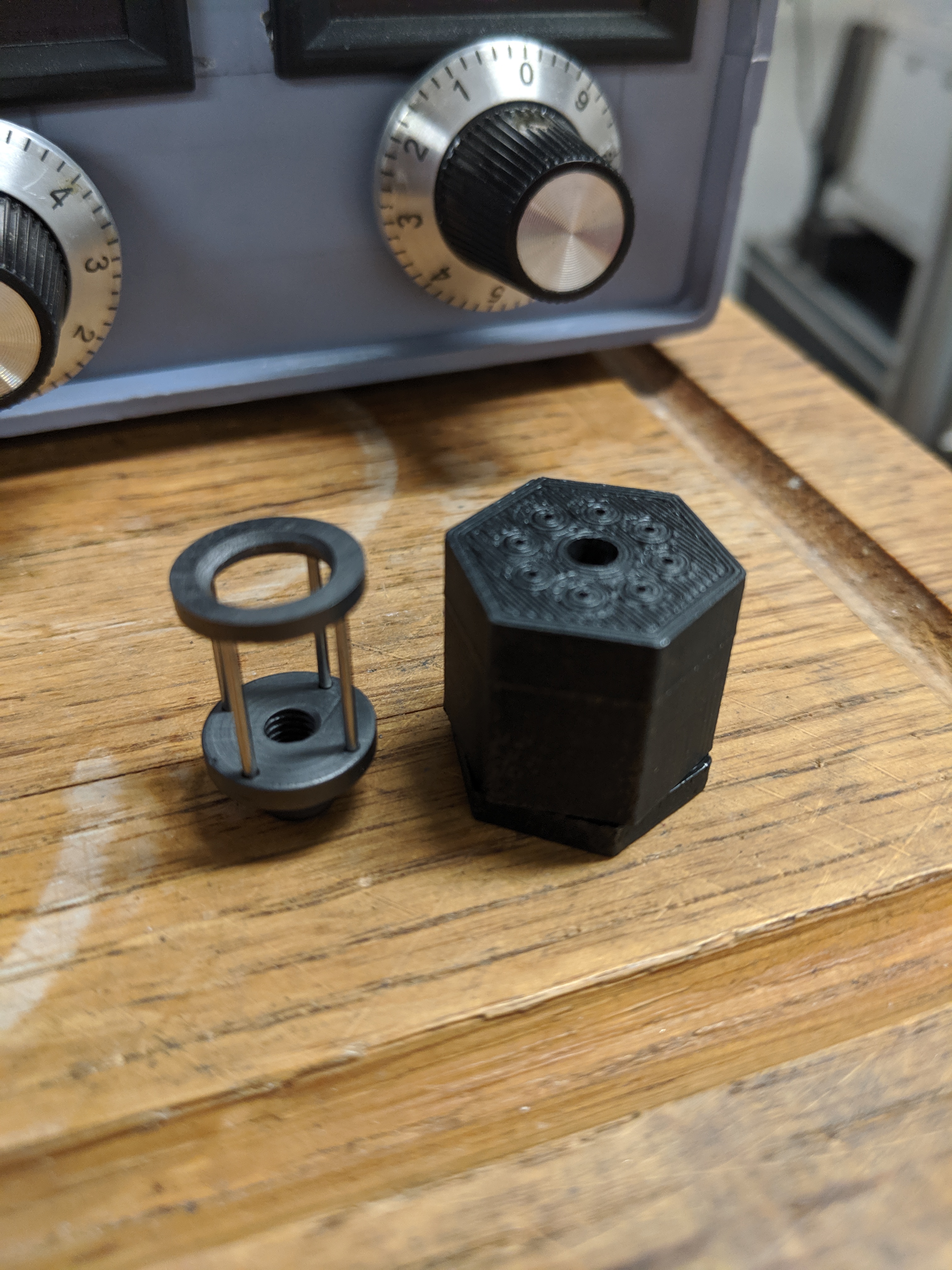

One of our earlier grids was kind of twisted, sort of like one of yours. It was precise, in that it was uniformly messed up that way. As luck would have it...it was one of the most stable grids we've ever run here - which has both up and downsides. All the beams were sharp looking, though. Cause of the twist was some tilt in the mount on the drilling table where I did the ends...sigh.
Improvements in accuracy seem to be worth it for beam collisions. That paper we were discussing said those were essentially negligible, but then I'm doing better at 50kv than they were in SS at 70, so perhaps those improvements I made actually improved something. Anyone here who machines things will tell you - making tools and jigs is way worth it for results.

I spent a couple hours today making a new grid. To step up the accuracy, I 3D printed a jig that accepts the 1/2" graphite stock and lays out the mounting hole as well as those for the tungsten rods. The center is tapped 8-32 and the holes for the rods are drilled with a 0.9mm bit to accept 0.04" ~ 1mm tungsten. While the filing and drilling is still done by hand, the results are far superior to what I've made before; the parallel rods speak for themselves. The most significant asymmetry is that the cap is slightly tilted relative to the base, though a little adjustment on the tungsten lengths should fix it. I'm mostly concerned about ruining the friction fit. Since the grid is hanging upside down, it can only handle so many disassembles before falling apart. Tests to come within the week.
12.8mm OD, 8.36mm rod spacing, 21.61mm OAL.
Jig and grid for comparison. Jig has 8 holes should I want more tungsten rods in the future.

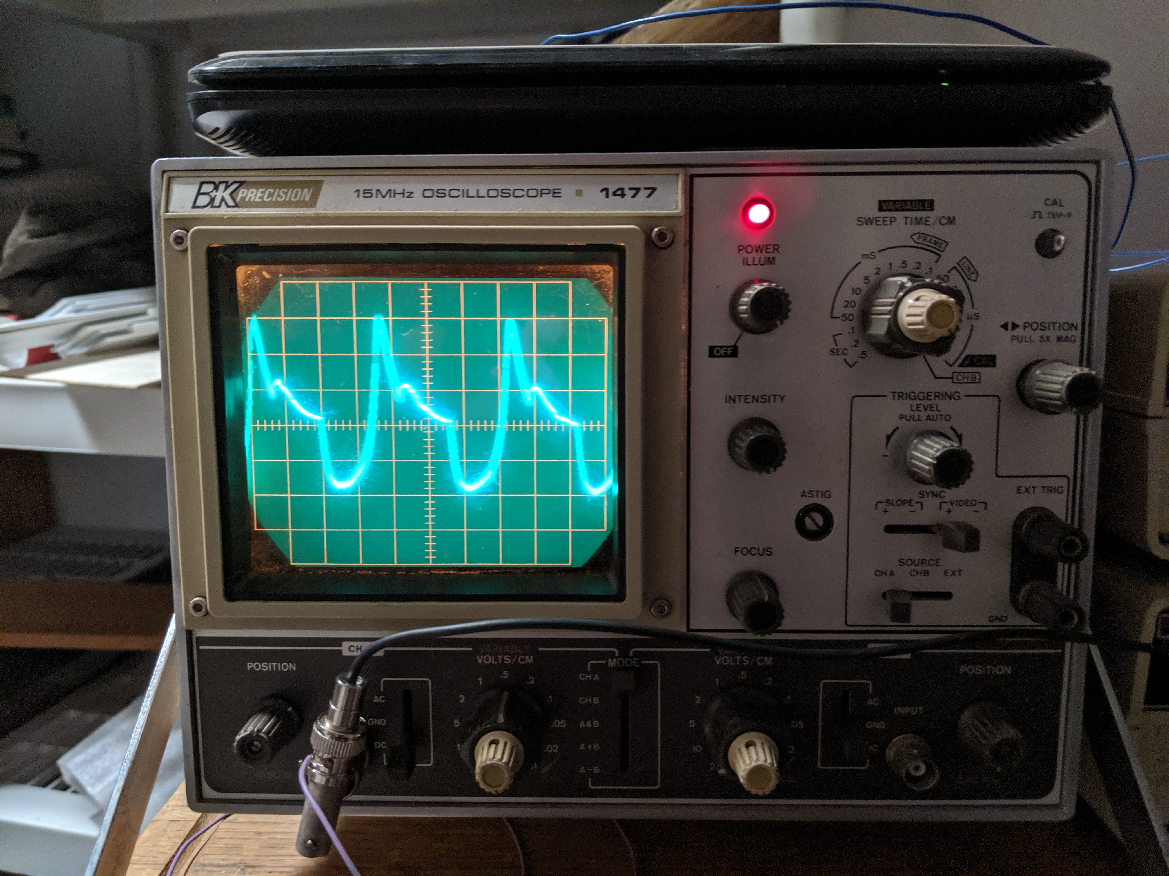

While I wait for some scope probes to arrive, a couple days ago I did a plasma cleaning run and used a wire coil to pickup whatever the fusor threw out. Whenever plasma was established there was a very strong signal at ~140Hz. It was about 2/3 negative and at higher voltages (~14kv versus 7kV) the sharp peaks on the positive 1/3 noticeably flattened out. The frequency did not change with voltage and the signal disappeared when the plasma extinguished but the Spellman was still on, so it must have something to do with the plasma. Has anyone noticed a similar signal?
Peaks at about 7kV.
Flattened peaks at 14kV along with pressure, voltage, and current readouts from left to right.

"A wire coil" isn't clear enough to know what it is you're picking up here - is it a current transformer, an antenna, or what? 140 is suspiciously close to 120 hz - which would indicate some weak filter capacitor in the power supply (and a scope that needs calibration!) - and would only show up under load, just a guess. It is possible to get a fusor to oscillate in that range, like a neon bulb relaxation oscillator, but it's really unstable and not that easy to make it consistent - the frequency wanders all over the place...

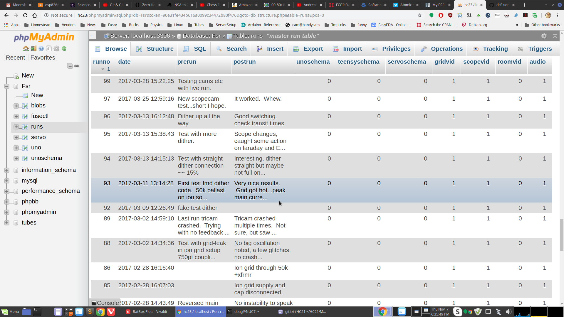

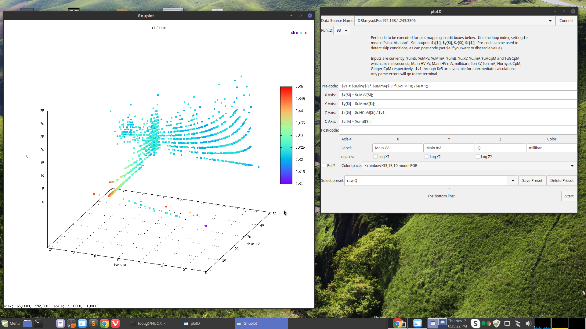

I use gnuplot (which I believe is what matlab uses under the hood?) and rolled my own database and plotting code - on process puts things in the database, another polls that and plots the data once a second or so - which gives you a built in error monitor - the data has to be getting in to that database to show up on a plot, so it's super obvious when something is wrong...and then that same plotting software also works on any previous run as well...and plenty of tools exist for managing and backing up databases. This is where something like a raspberry pi shines brightly, as it can be set to ignore the various other things that sometimes get a laptop etc too busy to really keep up.
FWIW, all my code is copyleft, but to set up a system takes some administration and adaptation to your setup details. For example, one has to set up MySQL or mariadb, I added a web server (nginx) and phpMyAdmin to fiddle in the database, things like that...it's all a job of it's own. It's pretty much all for linux - you can make it go on windows, but it's another layer of junk to make that happen.

The noise pickup on the scope was more for grins than anything at this point. I think it's calibrated, just based on the built-in square wave, but my question was more akin to "hey, what's that?" than "breakthrough!" Now I can see noise that was invisible before--things that the vast majority of fusioneers never see nor care about nowadays. The more I learn, the more I realize instrumentation can be a major limiting factor and not just the ability to make a good vacuum or HV.

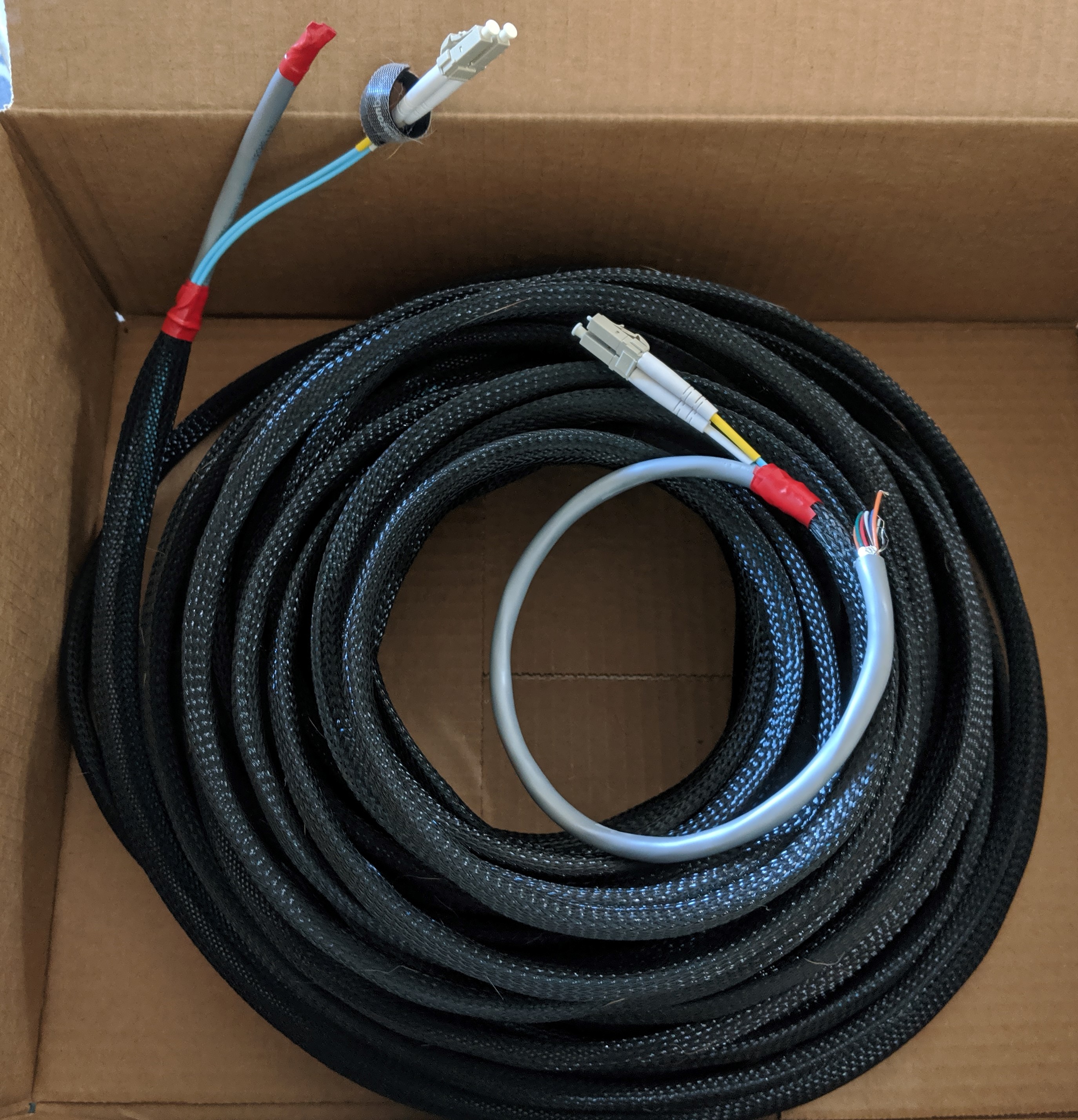

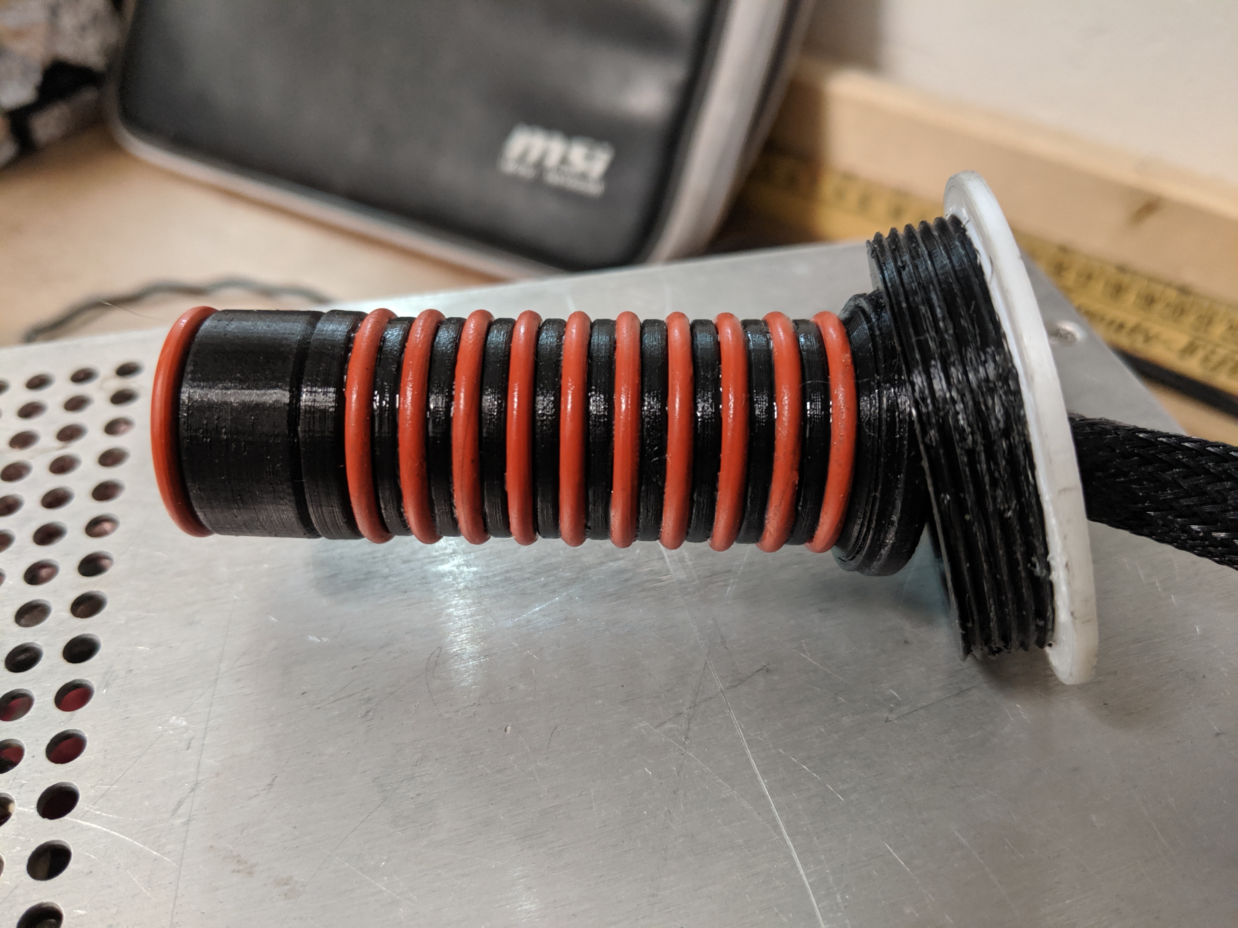

School's kept me busy but I've been making steady progress on the DAQ and control system.
I've opted for a fiber optic/ethernet system for data with a multicore, shielded cable for critical functions like HV enable, both of which pass through 30 meters of expandable sleeving to form an umbilical. My laptop connects via crossover cable to an ethernet/fiber converter and the hardwired connections will be controlled with toggle switches. On the fusor side in a metal box is another fiber converter, a network switch, and an arduino with ethernet shield. It communicates with two slave arduinos (Wire I2C) that perform measurements when the laptop program requests data. A relay board allows for switching of less-critical functions. I have yet to build the fancy enclosures but the electronics are fully functional--minus a few bugs.
Umbilical with LC/LC fiber and 15-core shielded cable

Good moves there. The fiber optic link stopped the frying of whatever machine was local to the fusor (a pi and a few unos in my case) as well as whatever was on the other end - some PC, and the stuff in between (switches). The hardwire cable is also very good for a safety. I've set mine up so that two wires carry 9v from my remote operator position to the fusor, and those are used to energize a power relay that the main fusor power is connected to. That way, all I have to do is turn off that control/enable power from my, safe, end, and the fusor is safe-ed immediately and for certain.

For example, I use a database (mysql) which is a little overkill but it's efficient code and I didn't have to write that database itself, just talk to it from my code.
The way things work is all the raw data goes into that database. Then, various things can plot it or display it - this way gives me an auto error detection mechanism, as I can't see anything happening if the first stage isn't working. In my case I wrote code that lets me get plots on some run number (defaults to the one in progress, but being able to see older ones is also good) and which can update around once per second, so the plots are near real time.
But then I also wrote a thing that can map entries in the database to axes of a plot using some interpreted code you can type into the gui, and make 3-d (really 4d as I have color as an independent variable) scatter plots you can rotate - and if your hardware is up to it, do that in real time too. In my case, the most useful mapping has volts and amps on x and y, and either raw neutrons on the z axis, or better - the neutron count divided by the volts*amps - Q, in other words. That's a most illuminating plot...
You might be able to do that kind of thing with the stuff you're using, I'm not knowledgeable with it. Definitely something to consider. One of the biggest advantages we have over say, Farnsworth, is that we have better data acquisition and analysis than he ever could have. The hope of course, is that if one of those high output "anomalies" should happen again, we get it recorded for analysis, so we can do it on command later, and don't have to wait for luck anymore.
So this is what I use - it's not perfect, but...it ain't bad either. I made various DB tables that let me put in comments so most database tools let me find things again.
Like this:
fishing for data
And then I can do useful later analysis, like this:
4 d rotatable plot (Q axis arbitrary units)
What this plot shows (and so do most of them) is that our Q goes up at lower pressure and lower current. The working theory is that less scattering helps us get the benefit of better focus.
That paper we looked at assumed there was no beam on beam - well, that's not true here, as that's what I've worked on making better and had some success.
We do also show in time-series plots that our neutron output and Q go down as the tank walls heat up. There is certainly some deuterium embedded in those walls, at least till heat drives it out...
