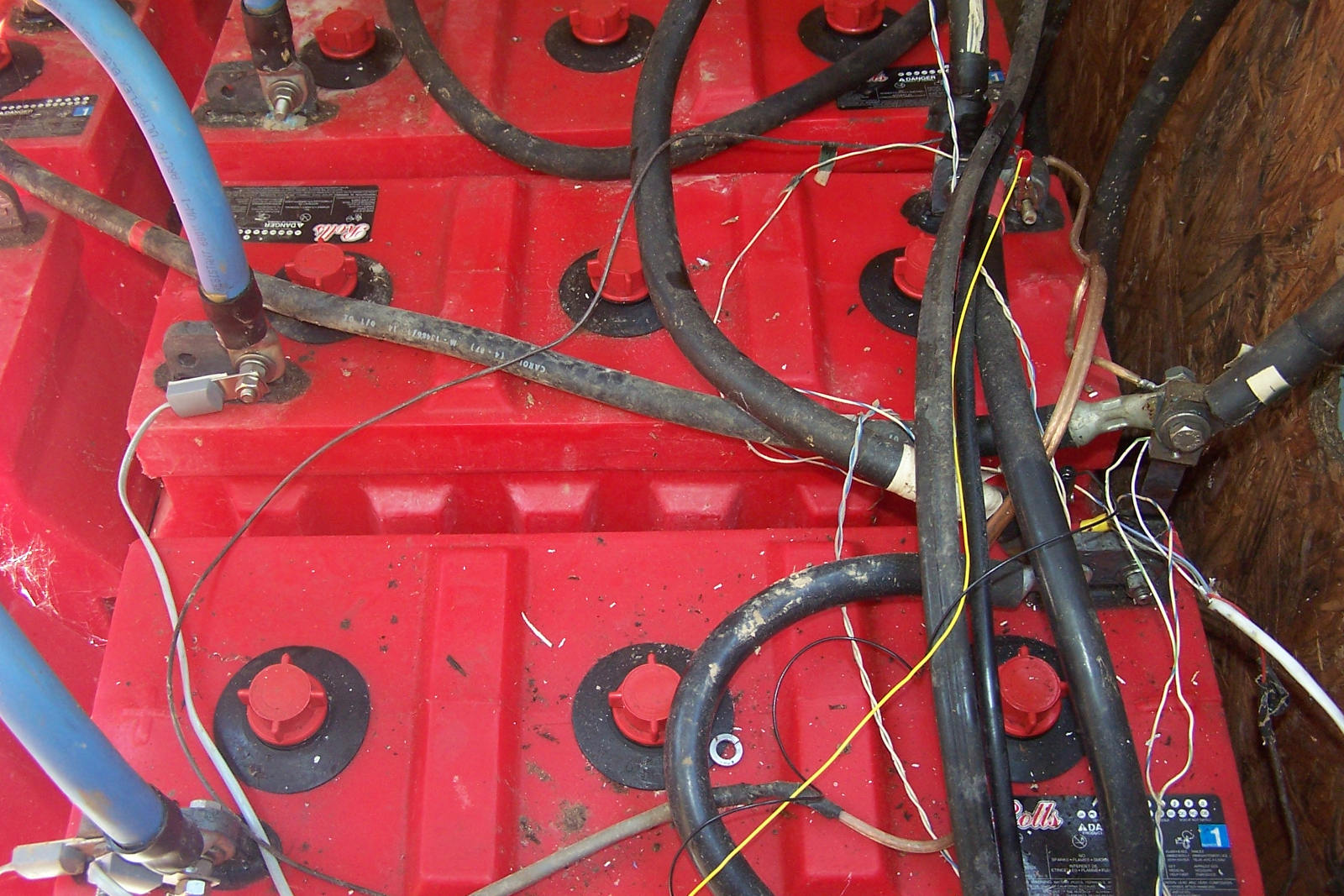

For fairly ridiculous reasons, I'm going to put a Pi in my battery box. Those reasons are - there is ethernet cable buried ?? years ago going there - and we want galvanic isolation for millivolt measurements at a current shunt, and well, I have a spare older pi (the new model 2 version will spoil you instantly) - so why not? Using the general scheme I've been using that slaves arduino's off pi's - I can later add the one that's going to control the Listeroid diesel backup generator, and of course, have CGI's etc for control, status, and manual over-ride of whatever I have this do automatically. To ID the pi to any user of tightVNC, I used this as its desktop pic:
Does anyone think this needs added text for ID?
I've added tellem and tellme from my landns thing to all my machines here, so once things have been up over a minute or two, you can just use machine names in browsers and vnc viewers etc. In the case of the pi, I started tellem and tellme from /etc/rc.local after just copying them to /usr/bin and doing a sudo chmod 6711 to them both. Since they daemonize, all you have to do is put for example /usr/bin/tellem in /etc/rc.local and that all works fine. The installer I originally put up has fallen afoul of the fight between sysV init and systemD on some machines, sigh. (It still works on most pc's with most linuxes).
This particular pi wants to be able to use a Dallas DS18B20 (sealed up as a soil temperature monitor) for battery temperature (redundant with the Xantrex stuff I can't scrape data from, darn).
