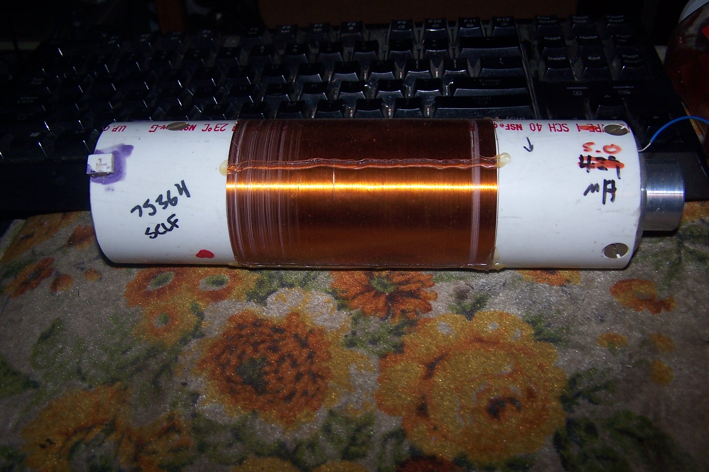

I had a medium Q inductor in series with the supply - I still have it and one or two others that produced results much more interesting than the usual ballast R (which I'd stopped using once I got rid of all feedthrough arc issues anyway). The measured resonance with no gas/ions tended to be in the 1.6 to 2.2 mhz range for some, but the "magic" one was much more inductance but lousy electrical Q, pictured below. (having a coil winding jig built for your lathe and tons of wire will encourage one to try stuff!)
I was running my full 50kv or very nearly, running an ion source (same one I'm using now - just a reduced size grid out in the big tank with DC on it - current limited to 2.5 ma and usually in the 10-20kv range) and running system gas pressure on the hairy edge of what would work under Paschen's law - and in fact in "the event" I had what seemed to be some kind of relaxation oscillation going on - huge kick back from the inductor re-accelerating a few ions might explain some things? But the (electrical) Q wasn't that great, even unloaded! Don't know, the numbers were "too fantastic" by normal fusor standards, though when thought about, still way not over unity either...just enough to be an issue to be in the room with. I've since re-instrumented with stuff that won't fry or blank from high count rates, and been slogging away trying to get this going as a driven thing....rather than as a lucky chance. hopefully I don't obsess too much and go alcoholic like that other Philo guy...

Here's the inductor. Several I built gave very roughly similar results, but this one hit it on the head. All resonated with the grid/ft somewhere. This one, at around 5 mh, should have been resonant at around 250khz. Another one that gave really good but not as spectacular results (in what looked like stable running) resonated at 1.8 mhz. I tried a couple in that range of varying (electrical) Q but never went anywhere much with that. They helped some compared to nothing.
The inductor in the main feed. I might have had a chunk of ferrite in there, but probably not.
