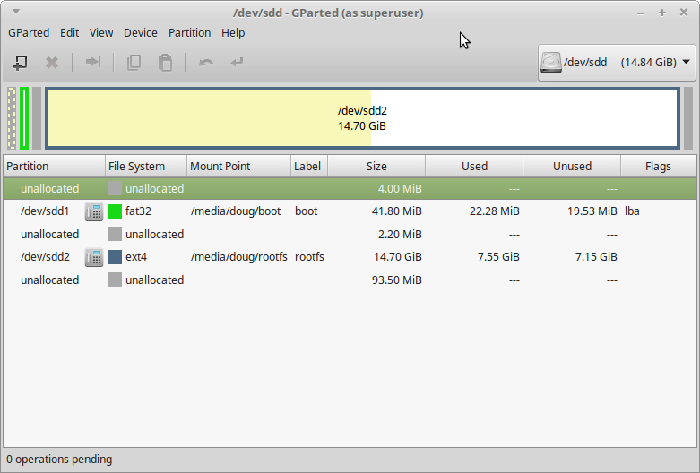

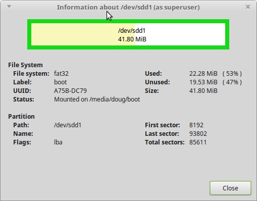

So, first I gathered some data from an existing working SD card in gedit, and here are the screenshots:
Overview of original SD card in gedit
And a little more detail - but not quite enough as I found out and worked around.
The original fat32 boot partition
The original ext4 root partition
Note that these show the start locations and so on as sectors - but when you're making new setup, gparted wants megabytes (MiB actually) and it won't take fractions as input, even though it will report them. This turns out to be overcome by simply using the old linux not-a-trick of telling the bootloader where root is, and setting up /etc/fstab to use the new locations as well - it gets read a bit later in the boot process and it all has to agree - that that big a deal if you know this.
