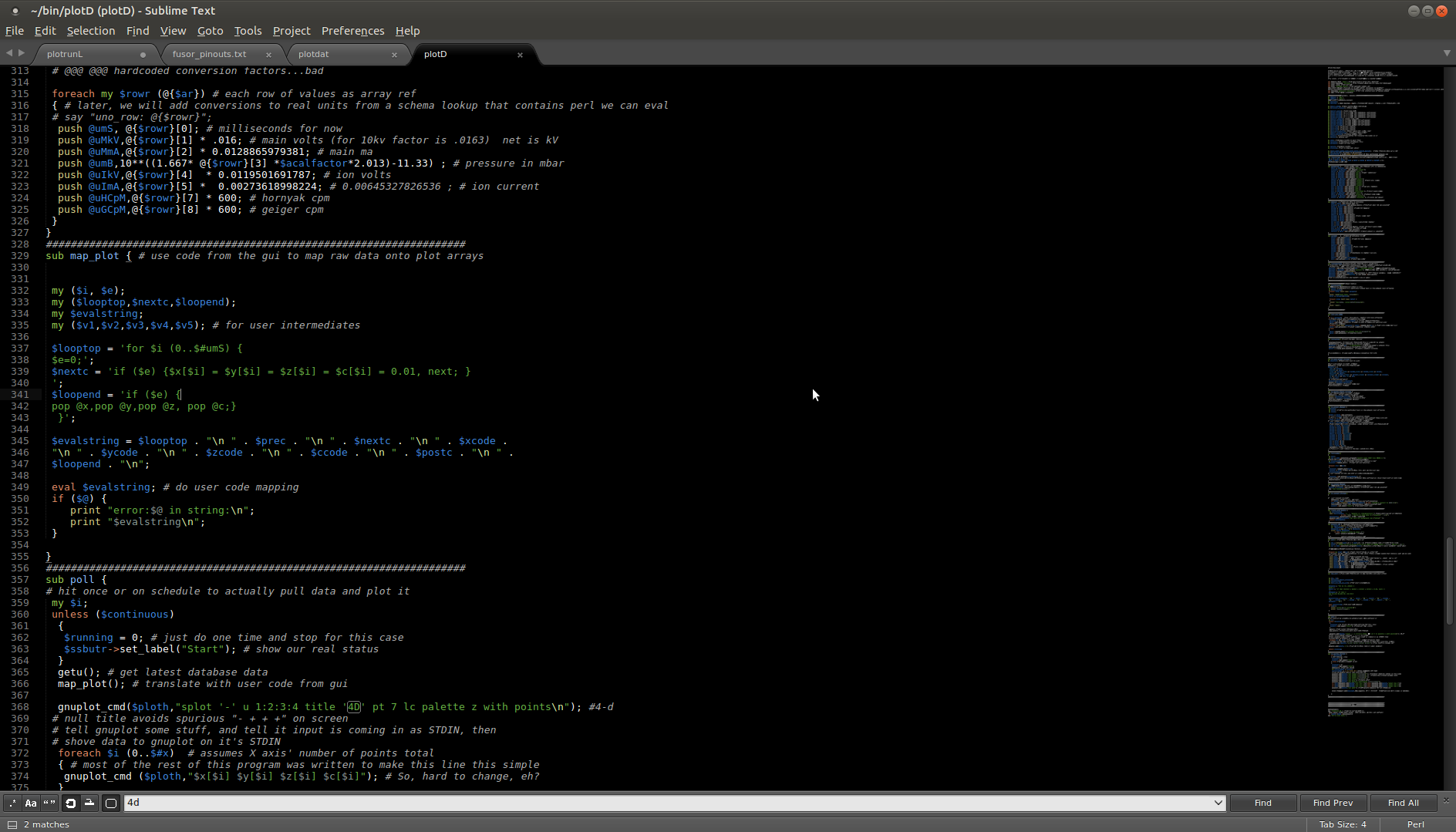

I succumbed to software lust and actually bought an editor. I think it was fair dinkum. Sublime text. While it doesn't handle my language of choice (perl) perfectly - and it seems nothing, even Padre does - it's darn good, and handles a lot of languages with really cool features (even column-select and editing), good customization, speed and grace. While it doesn't have the sidebar that lists all the symbols in a program, they are there in a dropdown for navigating.
Here's a picture of it in action:
Nice tool...
