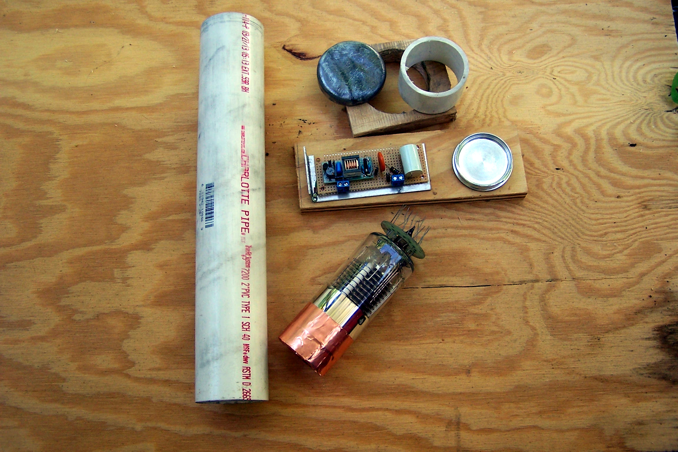

Some time(s) ago, BillF had brought me a hornyak button made I think by Jon Rosenstiel (fusor.org), and a couple nice 2" phototubes of unknown provenance. One was kind of wired up - with 40 megs per resistor in the dynode chain(!), and I decided to use the other one for this job - and I will probably use much lower values (like 100-200k) for this, since I have them. Even one meg seems too much per dynode for an 11 stage tube. If it's like the one it is supposed to be like....big if, they look similar but the one I have almost-specs on has a real base - gain of up to 107 is possible with these. Since my other hornyak is 1" (button from Eljen) and uses a 5 stage tube (surplus from a mass spec) that has 105 gain, I think I won't be pushing it too hard here.
I believe this tube is bi-alkali, which is good because IR is darned hard to stop. This sort is mostly blue sensitive, and the ZnS:Ag in a hornyak is...blue. Still, from prior experience, I'm going fairly hard at making a light tight enclosure. As you can see in the pic, I've already glued the button onto the tube (using Elgen's good optical epoxy, but really, only because I've got some) and covered it with copper tape (still around, search amazon, but be sitting down when you check the price). I used a piece of super thin PCB material (like they use for inner laminations in multilayer boards) for the end.
I will probably put Cu tape on the tube one more 2" extended from what's on there and connect them together. Not only for light, but because I plan to run the cathode negative of ground, so the floating anode will be at ground, and I've had leakage noise issues with other phototubes doing this. So the copper around the tube will be at the negative supply potential. I will wrap the PVC pipe with metallic tape also, but it'll just be grounded.
Here's what I have so far:
Most of the pieces
The Hornyak button can be lit up by gammas too, so I made a lead end cap for this similar to my other one, so as to at least slow them down a bit. As it worked out, the 2" pvc pipe is 2.4" OD, so I used a hole saw to put a sloppy 2.5" hole in some hardwood scrap I had. I cut off a little piece of 2" pvc to use as a punch and chamfered one end, and used a bit of plywood to adapt it to the pusher on my hydraulic press. Using a little rule of thumb and eyeball, I pushed the pipe through the wood block and formed the lead into a cap I'll be able to solder to the Cu tape on the outside of the housing later on. Did a nice job (don't try this at work, but for a one-shot job at home, fine). Not shown is the 1/4" long piece of 1.5" pvc I cut to space the end of the Hornyak back from the cap, as they will be 1000 or 2000 volts different in potential.
The HV board (the one shown will be modified a good bit, it was originally for some other use) will be on the aluminum bracket, and wrapped in EMI shield, so as not to put that nasty 50khz noise into the signal coax from the tube, which will pass underneath the aluminum bracket. I'll probably dedicate some sort of wall wart to this, and have a bnc output, but if I can manage it, I'll build in some audio too. Work in progress...you know how it is.
Oh, that aluminum end cap for the power input and signal output end came out nice on my lathe but didn't want to cut off clean with my tooling, so I brute forced it on the metal bandsaw. It left some real pretty artsy-fartsy marks on the end...so I left it that way. It's a tight press fit into the PVC.
