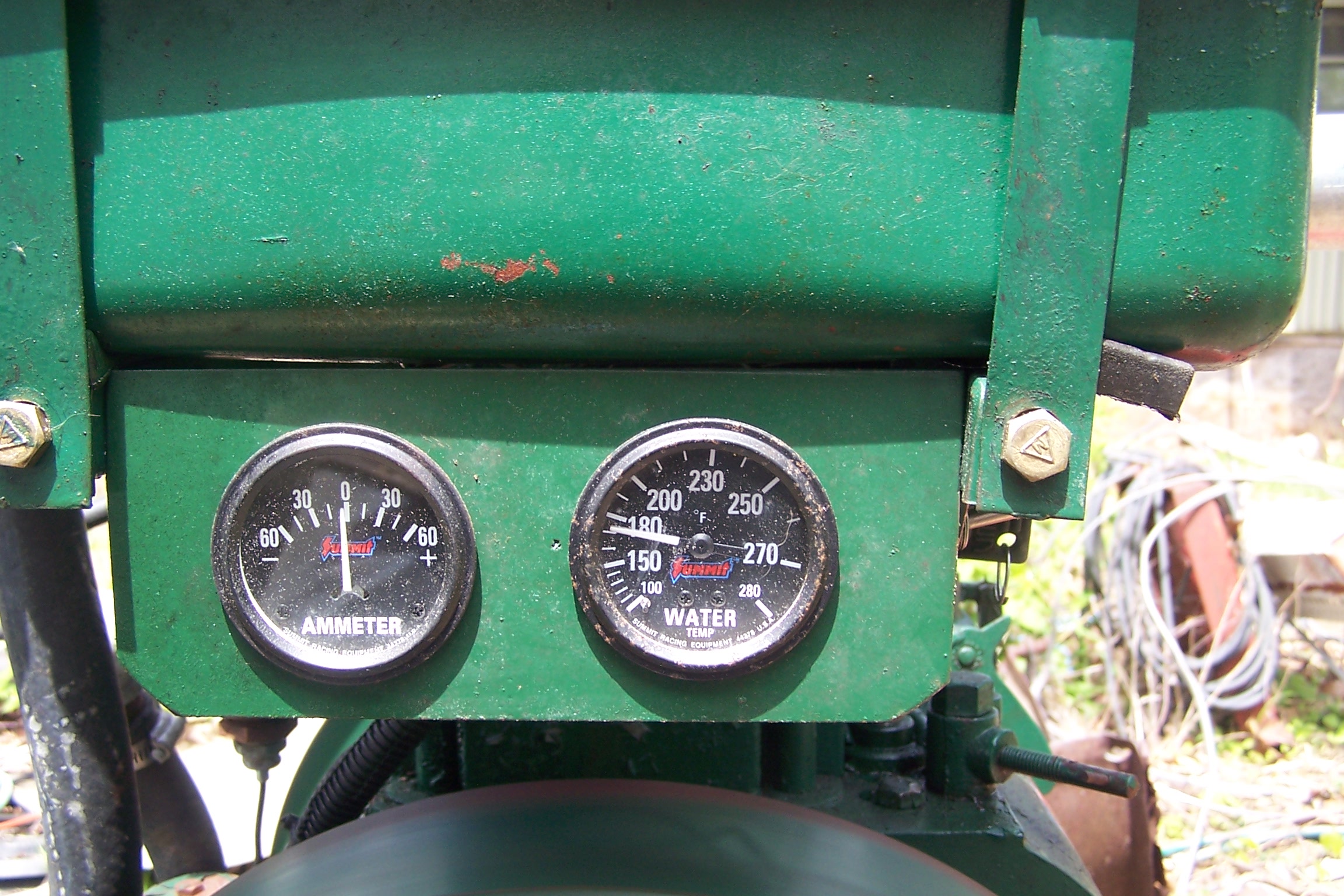

Now the temperature meter works...
Water temp working now
And it turns out the thing really likes to run on the warm side - 190f or so (I also tested another way). It actually speeds up when it's hot, despite the governor - I had to adjust some things for my charging system to work with the wider frequency range.

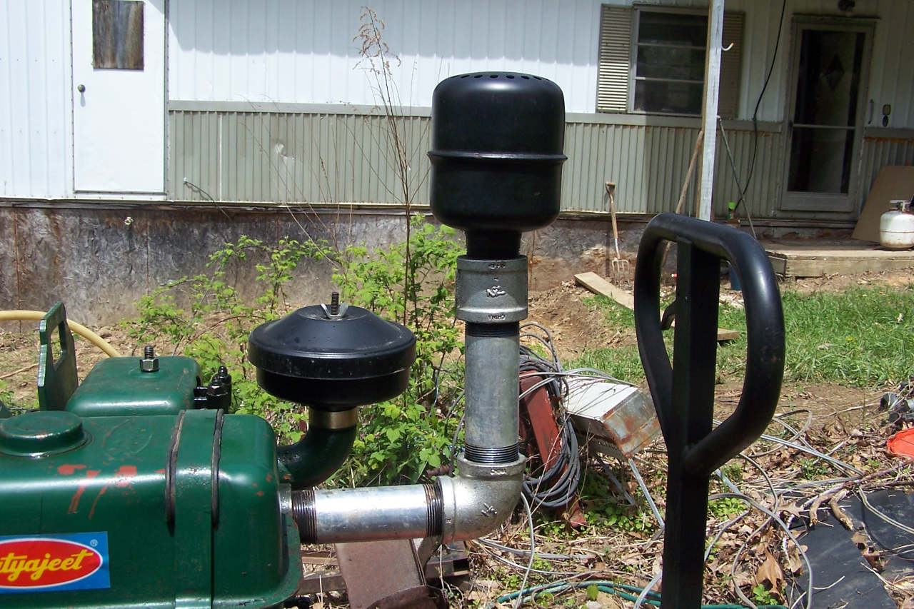

Also, with the muffler (if you can call it that) right on the engine, it blew those nasty fumes on you when you were starting - you have to be standing right there.
So I availed myself of a few fittings at Lowes and added a bit of pipe and an angle (as well as more volume) and now it puts the fumes up - and it's a lot quieter. I'll probably go further in that direction, this juist needs a longer pipe (for tuning/scavenging) and more volume in the exhaust system to keep things around 300 fpm instead of sometimes supersonic. But this is still a big improvement on a couple levels.

Help for the exhaust
It stinks less when hot as well. I think I'm on the right track with these mods.

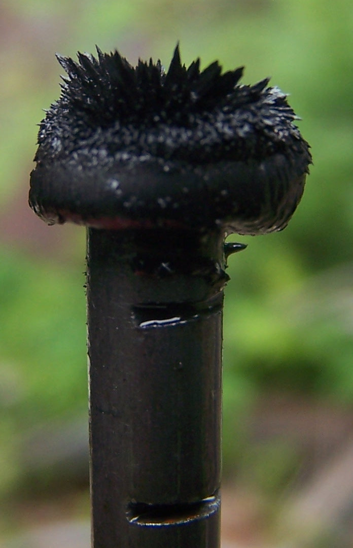

Well, after around 10 hours of just running the thing (luckily my inverter-charger is quite tolerant of voltage and frequency variations - 100-125v/phase and 55-65 hz), I pulled the dipstick - It had started with fresh clear oil, and I'd put a NeFeB magnet on the dipstick end. Here's what that looks like now (and the oil is black now).
Pretty big chips
Could be this thing had nearly zero hours on it as received, and this is break-in stuff. I'll definitely keep an eye on this. In cool (50F) weather, it seems to just hit 170-180F passively cooled. Whether I do a thermostat or just decide to put an electric motor on the water pump and only pump when needed, this thing wants some more-active temperature control. It does seem to be running better and cleaner with a few hours on it. I have also adjusted valve lash to near the factory specs. I hit around .010" - specs are variously .008" depending on who you read, and it was over .030" when I got it. Lash goes up as it warms up, as the pushrods stay cool out in the air, but the block gets warm.

The metal bits are a bit of concern
The black oil is not.
I run a toyota surf (forerunner)diesel it requires oil and filter change every 7000km
the oil goes black within 100km ---normal
diesel oil is very high detergent to keep the carbon in suspension ---ie black
and as a note to anyone reading this
If you want to clean out a gasoline engine from sludge a good diesel oil will loosen it all up pretty quick.
do not run it too long as the in suspension sludge will clog the oil filter. I do this to new to me second hand petrol cars and run the diesel engine oil for 1000km max (620 miles)

Doug from what I have read those are notorious for being full of trash from the factory. Change the oil and run it for another few hours to see what happens. If the trash persists of course then something is definitely wrong.

Yes, the forums on these mention they often come full of trash. What I'm seeing on the magnet is flakes, not powder (mostly) - it looks like "trimmings" from a really coarse cylinder honing job. Bill said he just put plain-jane multi-grade lube oil in it (wrong no matter who you ask). Most of the forums indicate one should use non-detergent straight 30 weight here (which is, BTW and from experience, probably right for any small engine with no filter). Clearances in these probably aren't tight enough to support that thin 10w-30 stuff, and no point keeping stuff in suspension since there's no filter to grab it anyway - best to let it settle out in a splash-oiled engine. The sump is huge - maybe over a gallon, FWIW. I'll see what it looks like after a few more hours runtime under load and decide what to do at that point.
If it's truly nasty (still), I'll take off the crankcase door and look for sand - some report leftover sand in the casting(!). And put a big honking magnet in there, instead of the little one on the end of the dipstick. I'll have to see how re-usable that door gasket turns out to be...

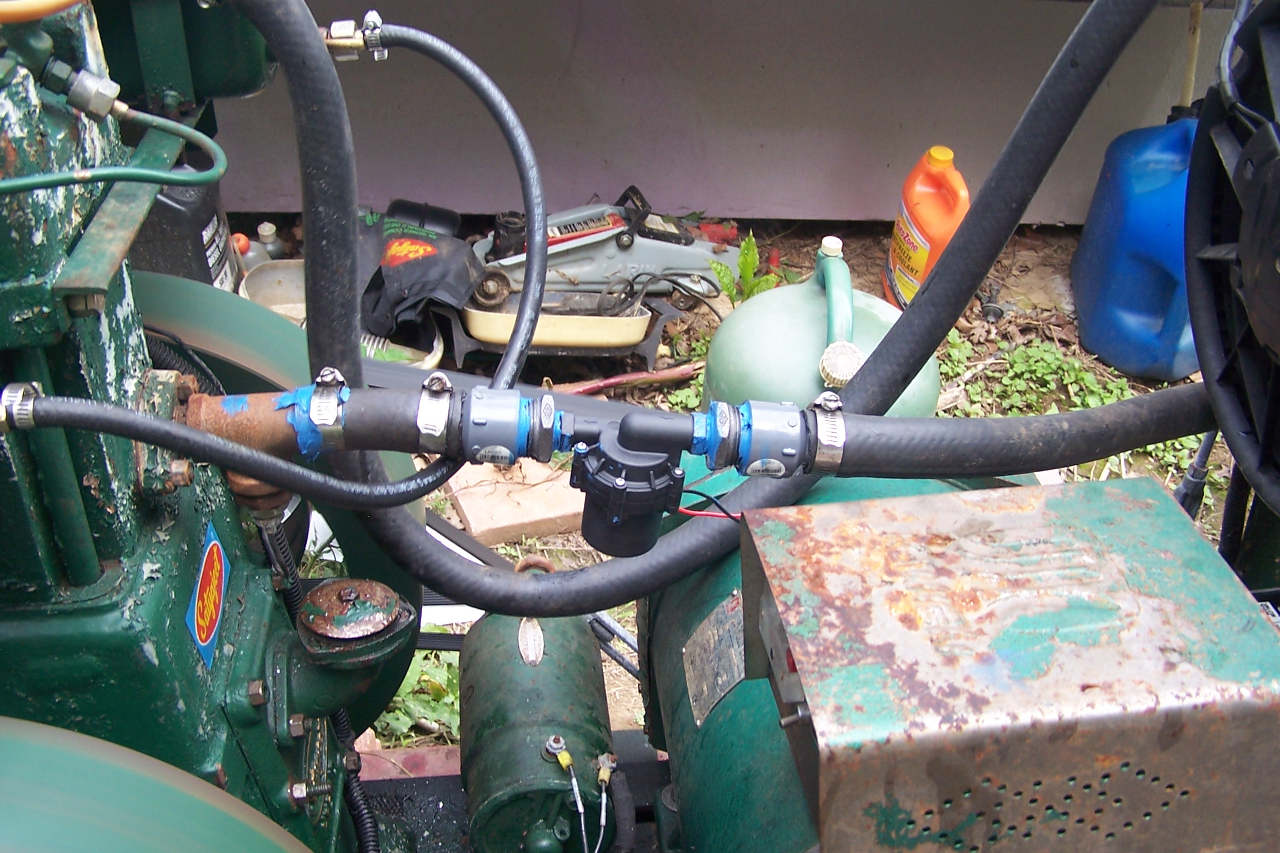

I found a small DC high temperature water pump on Amazon, and plan to incorporate that and a thermocouple-based switch for it and the fan ASAP. Right now, it's a belt driven, leaking water pump that runs all the time, and a too-powerful fan I almost never run at all. Even in 83f ambient temperatures, the heat loss from the piping and radiator (without the fan at all) holds this down to around 160f coming out of the cylinder head - it likes more like 190f. I don't have enough loads to get it that hot most of the time! Winter, of course, will be much more of a problem than summer - this really needs a thermostat, or the equivalent - a switched water pump. Saves a belt and a leak on top.
So, as soon as I can put together the adapters, I'll be adding a switched water pump and fan driven by an arduino (based on a thermocouple placed in the head) that may also do some better speed control stuff, battery charge control (for its starting battery) and so forth. But progress is progress, and now you can barely tell its running from indoors, which is nice.

And, it's here (the water pump, that is). Draws around 1 amp at 12v and actually pumps more water than the belt driven one did. Right now, it's just clip leads. I have an arduino sketch I'm testing on my bench, but have yet to mount a thermocouple on the engine head (tricky..) or the arduino in the nearby energy shed (along with a pi that's going in there to provide ethernet - I had an old model B that cost less than an ethernet shield for an arduino!).
Pretty soon, we'll have full automation on this puppy - maybe even auto-start if the house batteries get too low. We'll see...
Anyway, here's the pump, mounted, not leaking and working great.
I didn't cheap-out on the permatax, of course.
The arduino sketch currently decides to turn on the pump at 185 F, off at 180f, turn on the fan at 190F and off at 185. It's tunable, of course - it's all just #defines in C. I plan other things for this arduino, and am getting the pi ready to build and burn arduino sketches so I can do this remotely via tightvnc. The pi needs a bit more sysadmin work on it before it's ready to go headless...thinks like mount a USB stick over /var for database and web content, things you'd rather have it in your hand for doing rather than taking a display out there. I will then have a battery monitor out there serving web and filling its own database for later capture and analysis, much like the system here in the old office trailer, which has been working swimmingly.
