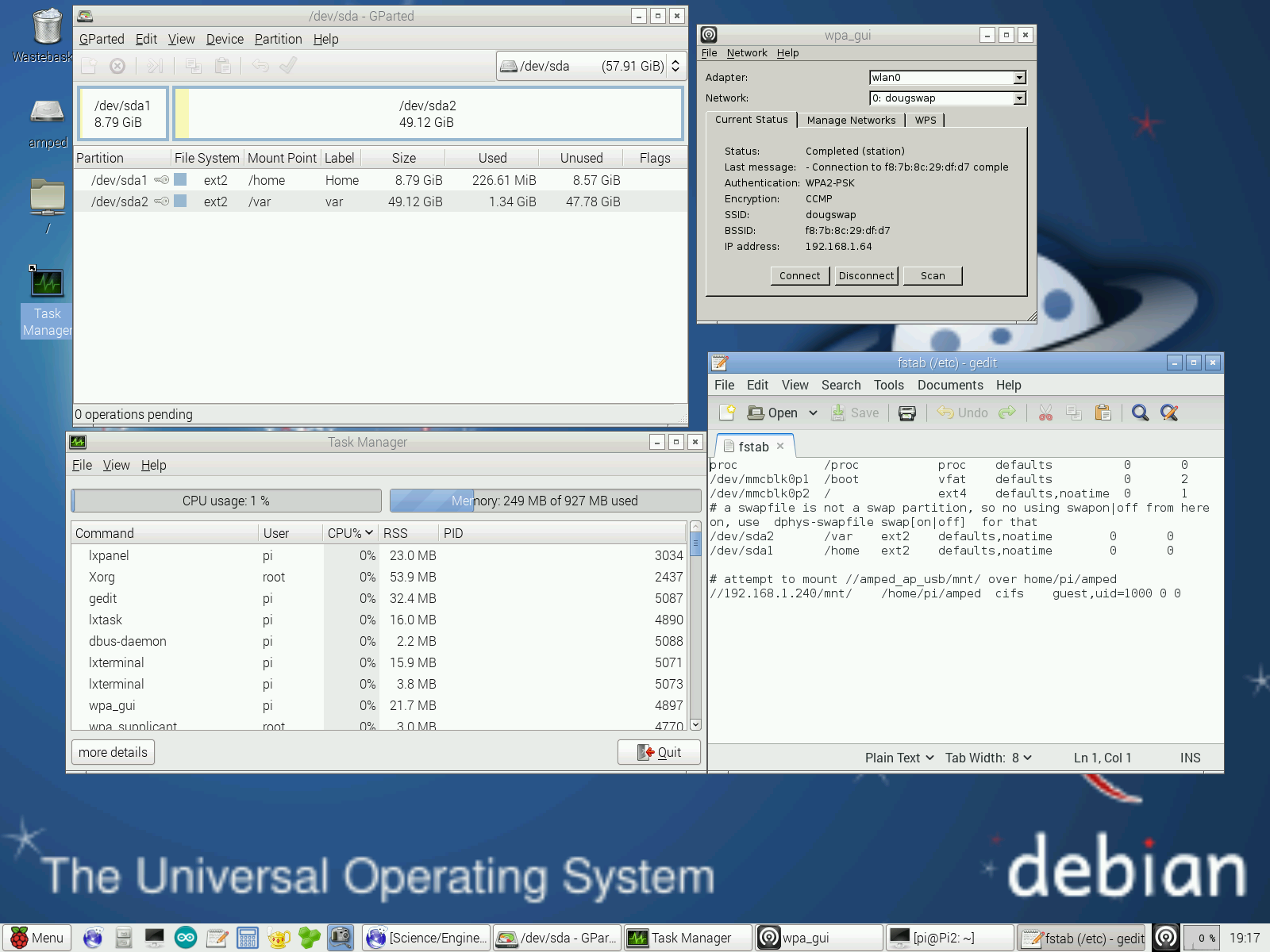

Re: Pi cheat-sheet (extended storage and wireless)
Postby Doug Coulter » Fri Mar 06, 2015 7:27 pm
Wireless was a snap - just follow the directions after plugging in your dongle. My WAP has a share on it, which I mount later in fstab (where linux keeps track of how to map available storage onto the directory structure at boot time).
The other thing of interest here, is that I've added a 64 gb (well, nominal, you know how they lie) USB stick, partitioned into two chunks, and mounted then over /home and over /var.
Those are the two most written-on places in a normal linux box that is running things like webservers, development stuff, and basic regular usage.
In this case, what I did first was make a directory under /home/pi called /home/pi/amped to have something to mount the share over. The basic install already has a /var and a /home.
But the tricky part is that once you mount something over a dir, what might have been "underneath" in the first place is now invisible. So before I could mount the nice new USB stick, I had to put the existing content of /home and /var on the two partitions, so they'd not be lost (well, hidden as long as the stick was there, kind of giving one a chicken-egg situation for copying them). You have to do this and then edit fstab with no intervening writing if you don't want to lose anything, it's usually best to do this right after the initial opsys install.
Only then could I mount the USB stick (from /etc/fstab), and then the wireless share, since it's under home and would have been hidden itself, thus the order of things in the fstab file shown here. I note the pi is more or less loafing, with this browser (iceweasel), gparted (to show the USB partitions), task manager (actually a cycle hog), wpa_gui to set up the wireless, a terminal, gedit (to show fstab) and a file browser...could be worse.
Here's what it all looks like. Don't hesitate to ask for more detail if you need it. The object of all this is to avoid ruining the SD card we boot from - they are fragile when written too often. Not that USB sticks are super-robust, but without the requirements for special UEFI boots and special partitions, they're a lot easier to backup and restore if/when they go bad.
Screen shot of a really expanded pi...it's also running NGINX and MySQL among other things...
In case someone sharp-eyed notices and questions why I used ext2 as the USB file system - it writes less - not being a journaling file system. The "noatime" also writes less, since it doesn't keep track of the last time a file was read by WRITING on something so as to remember that. Duh. Someday we'll have a flash-friendly file system that works - they've been saying we have for a couple years now, but then say "oops, not yet".
