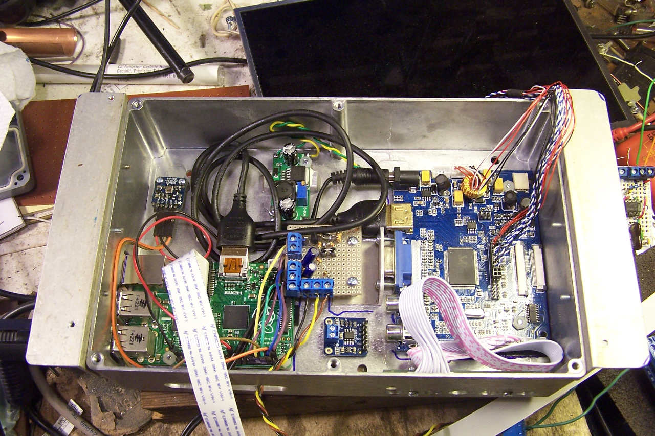

Back on topic (mostly). Here's the Pi box with some peripherals in it. I haven't yet drilled and tapped the holes for the thermocouple breakout board, but will, and get that working right off the Pi as well, also using HiPi modules. The barometer/temp board is in the upper left, the Pi is below that. To the right is the switcher which creates 5.1v for the Pi (most of the issues with Pi have to do with crummy power, I skipped the inadequate micro-USB connector here for that reason) - the box itself run on ~12v, the HDMI DVI display driver is on the right and will take the usual "car battery" range of voltages, so that's what we input from a temperature compensated deep cycle 60 Ah UPS system I built already, which will run this for a few days in the event of a power down situation - I'm likely to want that data even more than when things are normal, after all. In the center is the serial line driver on perfboard to adapt the Pi TX output to 5v - with drive up to 2 amps(!). I could even power the slaves from it, but I won't. It actually does that now, via the protection diodes in the arduinos. That's not a good thing, they could get fried if there are other big loads on them.
The Pi chassis, to be mounted in a wall in my remote location - I'm moving from this man-cave to there.
The white cable is for the Pi camera - this unit can stream HD video with lower latency and higher rez than even a normal desktop computer/tower and a webcam - it's about twice the rez, and half the latency of typcial PC streaming tools. And I can get a camera (have one) that also sees in IR and does motion detection...(this will be a link to that part of the project at some point).
