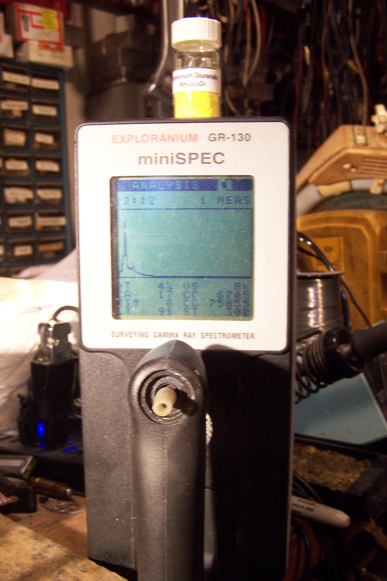

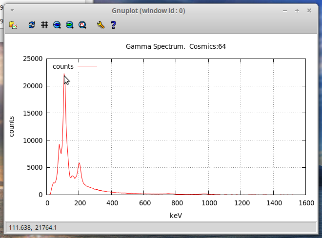

Here it is with a sample of recently refined U ore on top, taking a spectrum.
MiniSpec at work, running on two D batteries with U on top.

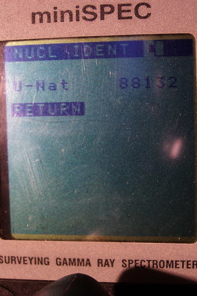

I then asked to identify what it was:
It gets it right.

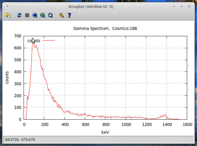

And here's the resulting spectrum after plotting with my linux software. I could have blown this up much larger, but since there are only 256 bins (one special for "out of range" or "cosmics" there's really not much point at least for posting, looking at it carefully and using the cursor to get gnuplot to ID the lines accurately, that's another story. Here's the result (I will be posting the source code someplace under software real soon - check back if this hasn't had a link to it added yet).
Result plotted on a linux PC (Mint-Mate 17.1 FYI), using gnuplot and my perl code.

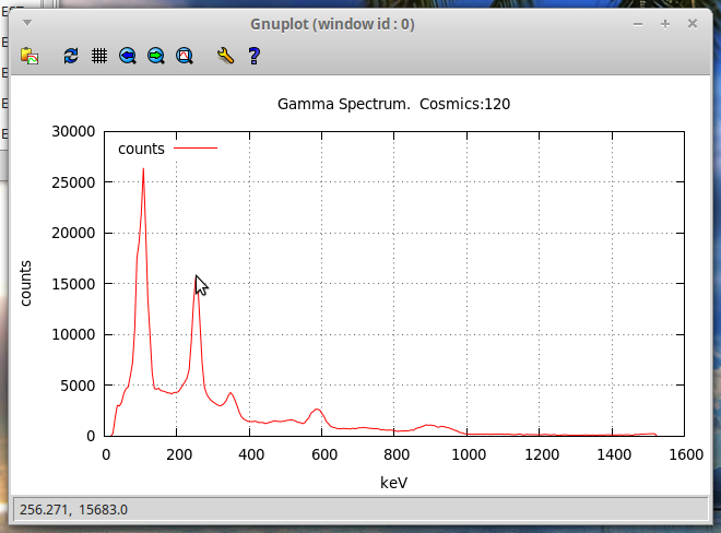

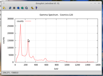

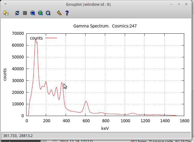

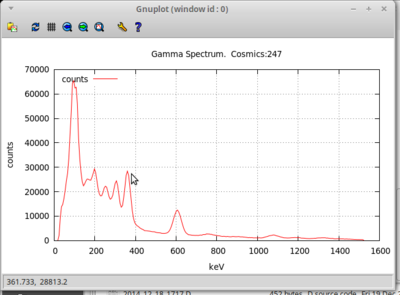

Now for something really hot. We scored some torbernite, this is a fist-sized chunk placed green side down on the detector. It overflowed and quit after 200 seconds. I don't keep this one indoors! You can see it out on the porch with any gamma detector right through the lead pig I keep it in! The unit identifies it as natural U and radium. The theory is this is from Oklo and is very old natural reactor waste, more or less. It's not something you want real close to you for long, it's also giving off tons of radon and has contaminated the inside of the pig with radon daughters. Wash hands after handling with gloves, this stuff.
Really "rich" ore.

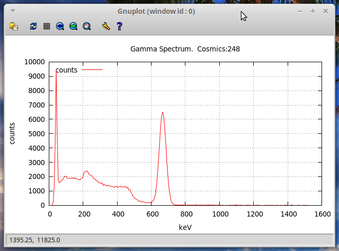

Of course, this wouldn't be complete without showing Cs-137 from our .25 uC calibration source:
Standard source, you need this to calibrate the unit.

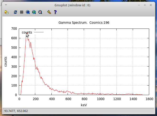

Now to really put it through the grinder. I took two spectra, one with a pound of potassium nitrate on it, and one just background. Here they are. It takes a good examination to see the difference, but it's there. FWIW, it ID's the KNO3 correctly, but also ID's my background the same. Who knows? It's a wood shop and not that far from a woodstove...but I do see a difference here with a known sample on it. Barely.
Background taken in the same spot/conditions as the other spectra.
And here it is with that pound of "stump remover" on top:
KNO3 sample
These posts aren't yet showing all this can do. It also has survey and dose modes (your choice of Gy, Sv, and Rem), which my software handles, but enough for one post right now. I plan to put on a coat and take it for a ride in survey mode along with a vidcam so we can look at my campus and see what's hot (I already know - we have some pretty hot rocks here sticking out of the sides of the hills). Most of the "hot" stuff we've collected is kept far away from living quarters...I only keep some very small samples in the shop, and even those are in lead pigs, and kept away from where I usually am.
All these were taken with the setting at 1.5 MeV full scale. Our unit also has a 3 MeV full scale...might be interesting on the fusor later on.
