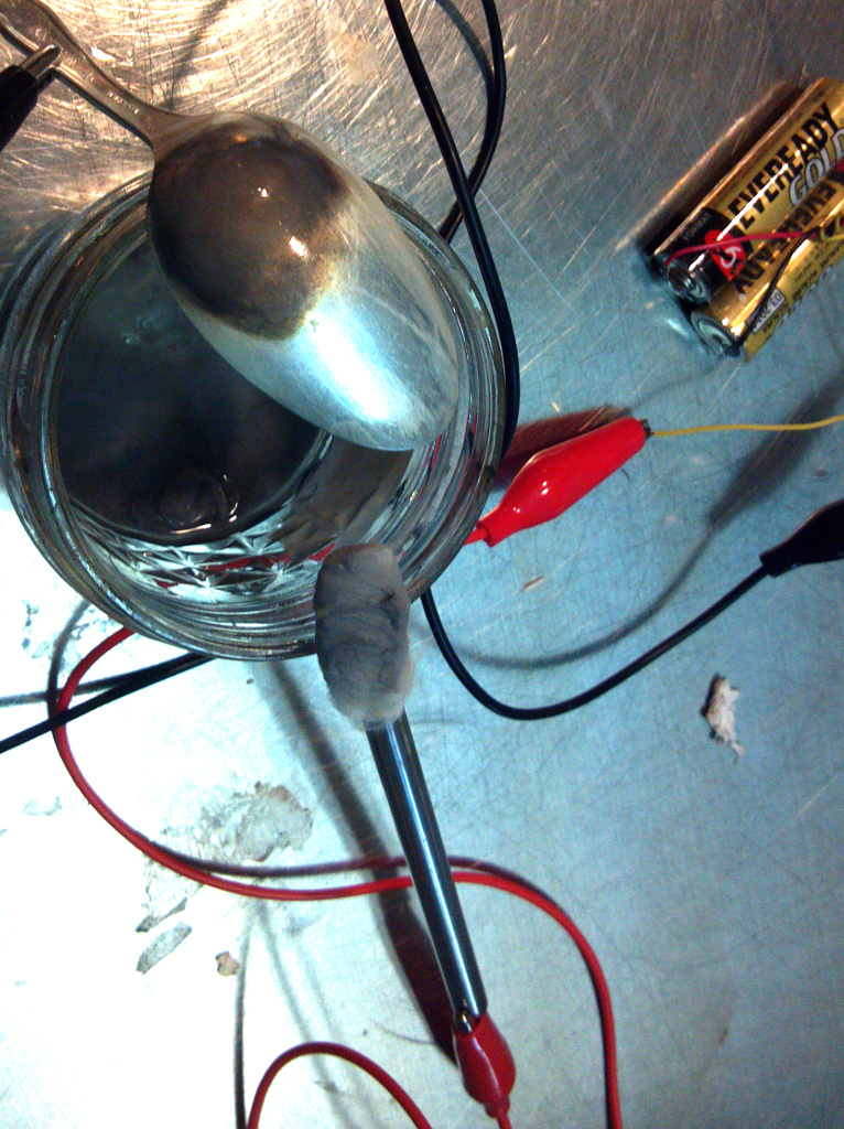

2 - to increase the thickness of the Ag layer, attach battery (-)
to workpiece (cathode), and the battery (+) to the stainless wand
(anode) the flattened end wrapped with 1/2 a cotton ball & thoroughly
wet with the 0.6 M AgNO3 solution and slowly, but firmly, rub the
prepared area in a circular pattern or brush-strokes for about 60 to
90 seconds. The workpiece color will progress from yellowish, to tan,
brown, milky gray, and darker gray.
after electroplating (1.5v from one of the AA batteries)

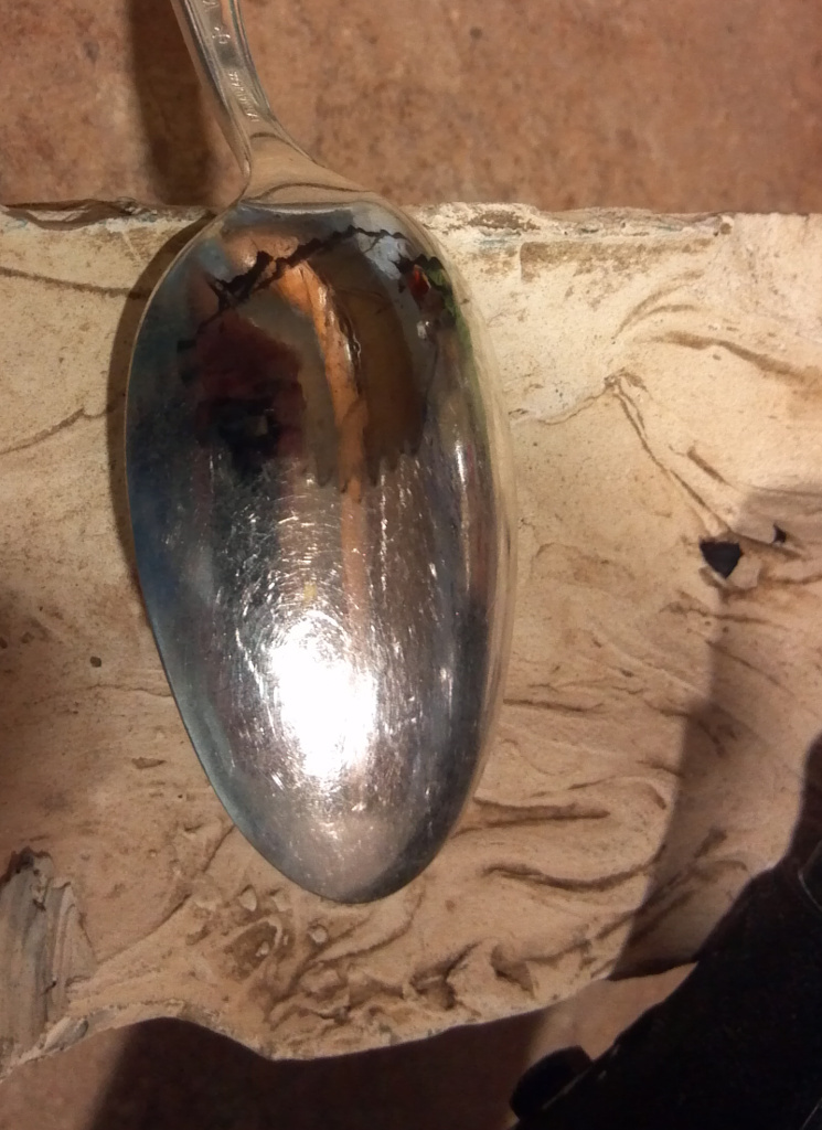

3 - disconnect workpiece from battery and polish with Wright's
Silver Cream.
After final polish - it's not perfect, but hey, it's "used". The 90% Ag dime is a size reference
