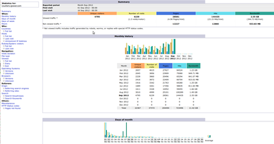

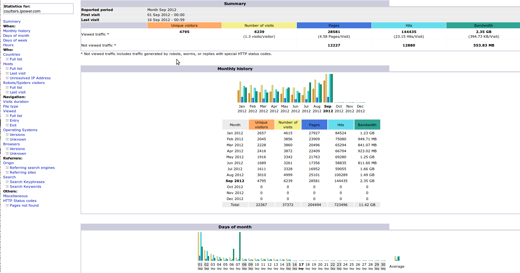

I didn't get the entire thing (it's multiple pages), but here's what this one writeup did for our site stats. Evidently, hackaday is a real good place to get a link from.
Part of our site stats
Hits from my sig on Slashdot and GM-Volt.com are 2nd and third. Quite a few also coming from G+ people I talk to (did a live fusor demo last night) but....this simply swamped them all.
