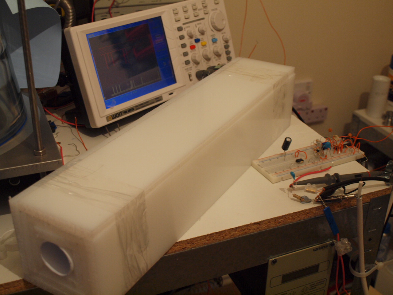

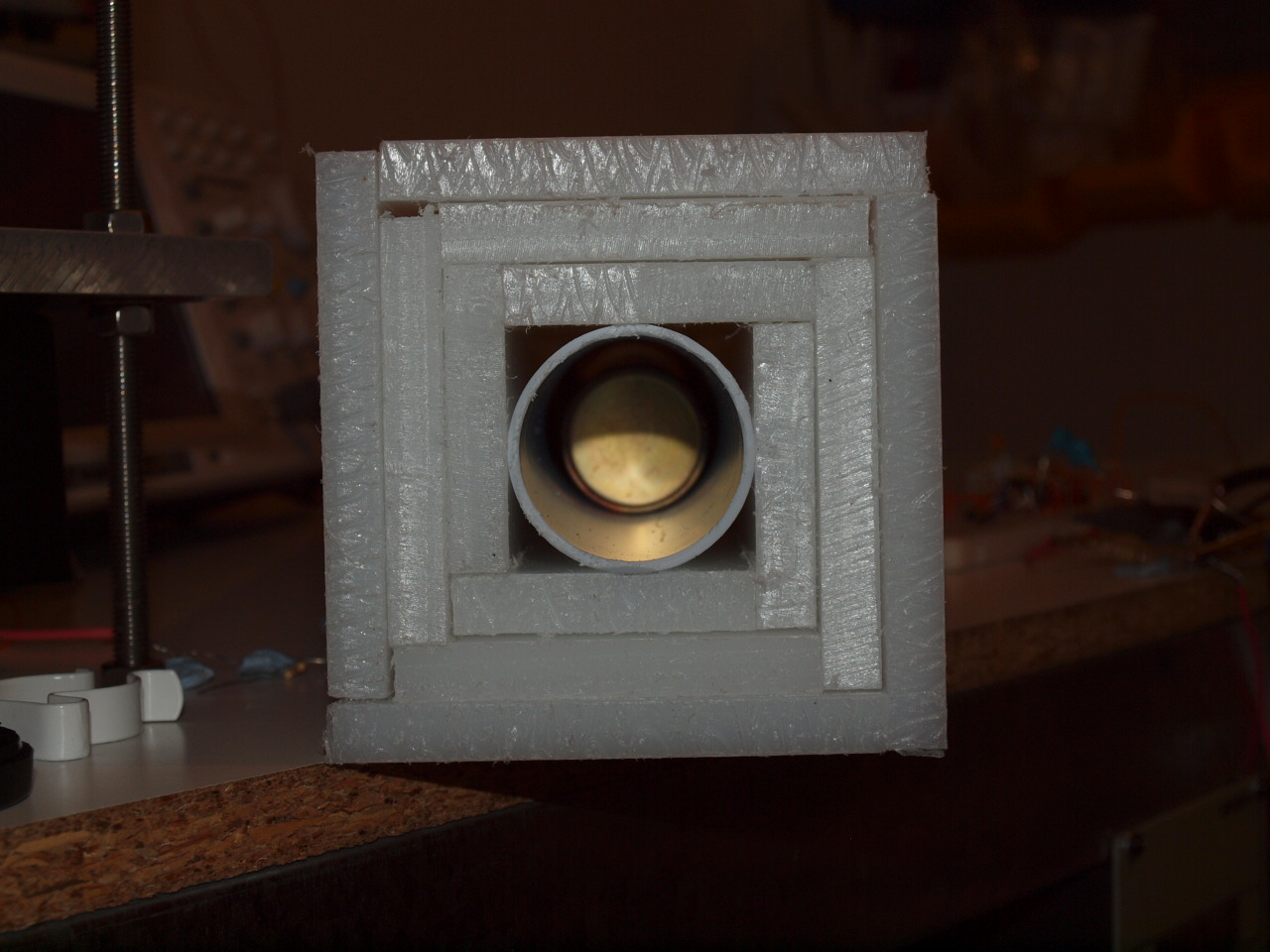

I made up a moderator for the tube. I have been cutting down to size a 2m x 1m piece of 10mm thick HDPE sheet. (cuts easy with a jig-saw, at that thickness).
There does appear to be a higher count. It's a bit 'bursty', but as per prior discussions on fusor.net, background neutron counts with moderator are generally muon stuff generated in the moderator, rather than 'fast neutrons' being moderated, because it's mostly thermal neutrons at sea level - presumably on account of all the water in the air.

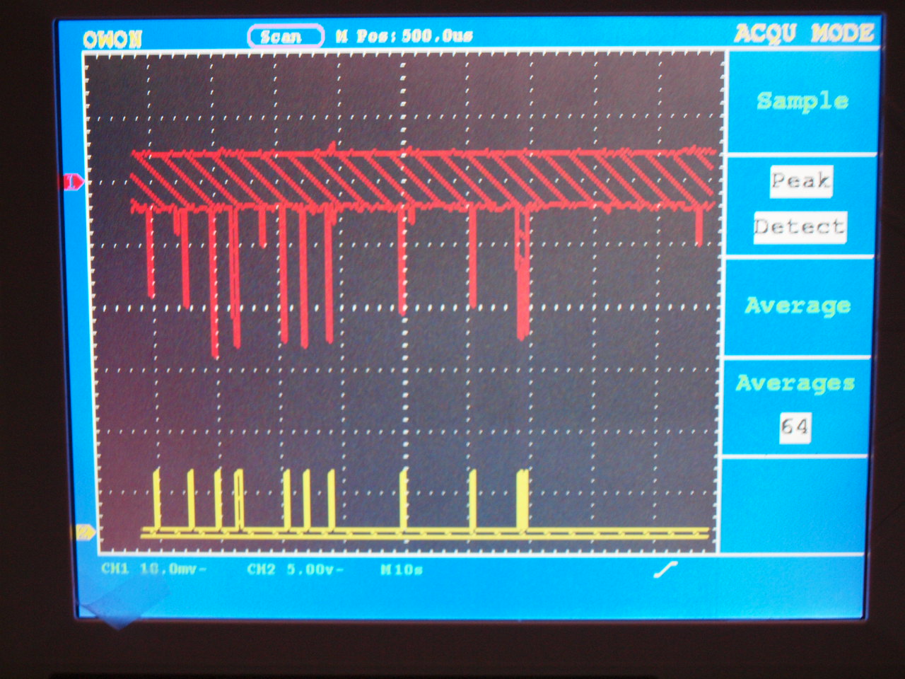

I'd say this morning it went from around 4-6 counts per min (2~3 per min after my aggressive thresholding), to around 7-12 (4~6 with thresholding). Watching the 'scope, I got the impression it wan't quite 'double', as those figures suggest, but that was the actual count from 5 mins of each came up with. On 'rate' I'd have estimated a 50% increase.
I'll do some long runs once the circuit is made up.
My original plan was to have 4 layers with an aim of 4cm worth of moderator, which I might move towards, but there again if I point the 'diagonal' towards a neutron source, then any neutron reaching the tube would've had to go through 4 cm worth of moderator for most paths to there. So, for now, I think I'll see how this goes and chop up more HDPE only if needed/feel like experimenting.

Most people use them end on (according to the books). The moderator acts like a scatterer - as many neutrons bounce straight back as any other way. To get to thermal, you need much more than 2" of thickness, more like 4-5 inches -- and it will make the tube more sensitive to do that, as it will also pick up more neutrons being bigger.
You do get muons - with or without the moderator. However, you also get knocked out neutrons from any in the moderator, the air, your roof, the bench, etc. Double isn't a surprise, I'd expect about that, maybe a little more.
As far as the tube goes, a muon is about like a beta ray, and high energy ones don't leave much energy behind -- they might not count this tube, dunno. Betas have low counting efficiency in geiger tubes unless they're enhanced for that -- special gas mix and so on (our standard counter tubes have that, which is good for that use, since most activated things are beta emitters).
Some metals eat neutrons at some energies, Al being among those - if that's a metal tube in there, make it steel, but better, make it nothing.

Doug Coulter wrote:To get to thermal, you need much more than 2" of thickness, more like 4-5 inches -- and it will make the tube more sensitive to do that, as it will also pick up more neutrons being bigger.
Better than nothing. I can only afford so much, and there is also a space issue if there is to be another foot of space required around my device.
I was looking at trying to judge the effectiveness of such thicknesses of moderator, but there doesn't seem to be a straight-forward plot of neutron distribution heading away on the other side, for a given input distribution and thickness.

Either should work. The pulses are several uS wide in most cases. However, the scopes and probes won't take the couple kv dc at that point, and you'll have to still provide your own coupling capacitor before the scope to protect it and the probe (and allow the couple kv on the tube to be there). Most scopes/probes won't do HV anymore. The pulses themselves are only a few millivolts, so you need to make sure you've got the gain to even see that.
