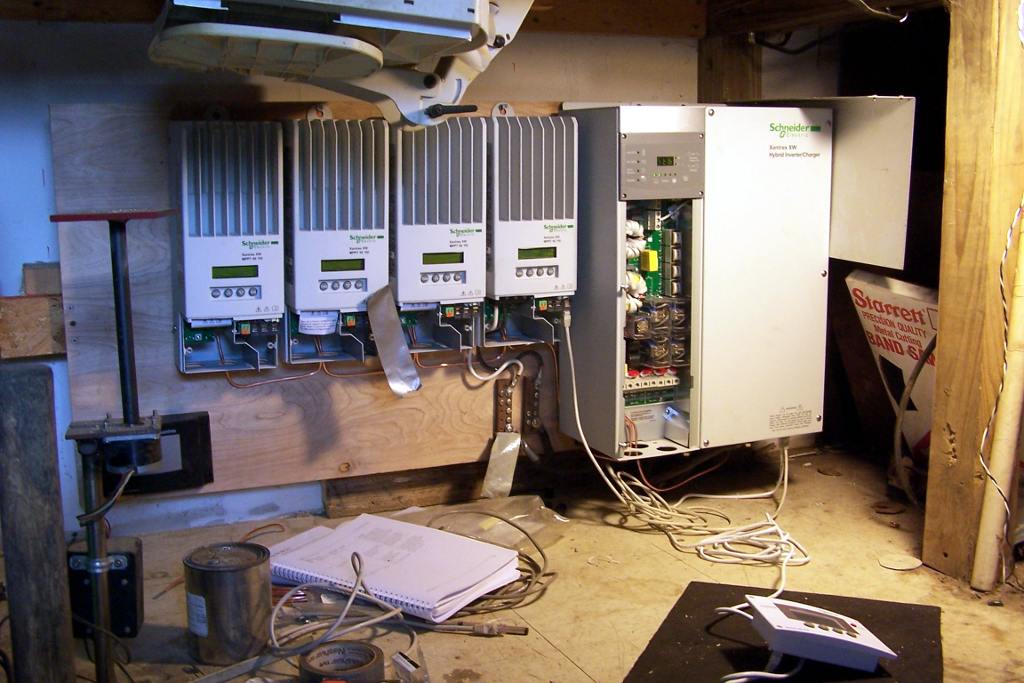

I'm making some major improvements on what was already a pretty nice system. There'll be a lot more to come on this thread, but I've just bought another 2.5kw worth of panels that have to be mounted along with the other 2kw I've gotten recently that aren't mounted yet - but which work fairly well just leaned on the wall. This time, I've added some real charge controllers to replace the frankenstein knife switch I've been using manually, and another inverter, this one a new Schneider XW-4024. I'll have to add at least one more charge controller to what is shown here to actually get all the panels under control and logged, but you know how building a big system sometimes goes - you do some of it on the fly.
Here's some of the new electronics. I probably already had plenty of inverters, but this one integrates in the new data aq system and puts out 240v unlike the others. I had one SQ wave inverter (3524) driving my air compressor and used as a charger off a generator, and the main SW-4024 which will continue to run "everything else" for now. The new one is going to run my Volt charger (for quicker charges), the welders, the lathe, and the fusor, all of which like 240v - I was using a fairly cheezy autotransformer before on those, and it kind of stinks as a solution. Having a bunch of inverters is nice, actually, as they regulate better when one gets a huge load spike. The various electronics here, including a web gateway, all talk, and have a lot of nifty features indeed, like programmable logic outputs to control other stuff, the ability to grow almost without limit (though I think I'm probably near the limit of what I'll ever want, much less need, now) and just plain efficiency. These solar controllers can harvest about 30% more energy from the panels than a straight hookup to the batteries, by using a fancy switcher to "impedance match" the panel output at it's max power output voltage to whatever the batteries happen to be at the moment, for example - most "24V" panels for example might make peak power at something like 35v or more, while the batteries might be run down to 23V - there's a lot of extra energy to be had there by using a buck conveter that regulates its input voltage down the the panel array max power (panels act kind of like a constant current source up to a voltage that is determined by the temperature of the panels - they act like forward biased diodes when open circuited).
So, while wiring is almost as much fun as plumbing (not!), I'm enjoying doing this. Now I can run more nasty loads with less noise to the delicate ones, and charge my car faster too! It was already better than power company power in those regards, but there was a little more possible, so I'm going for it!

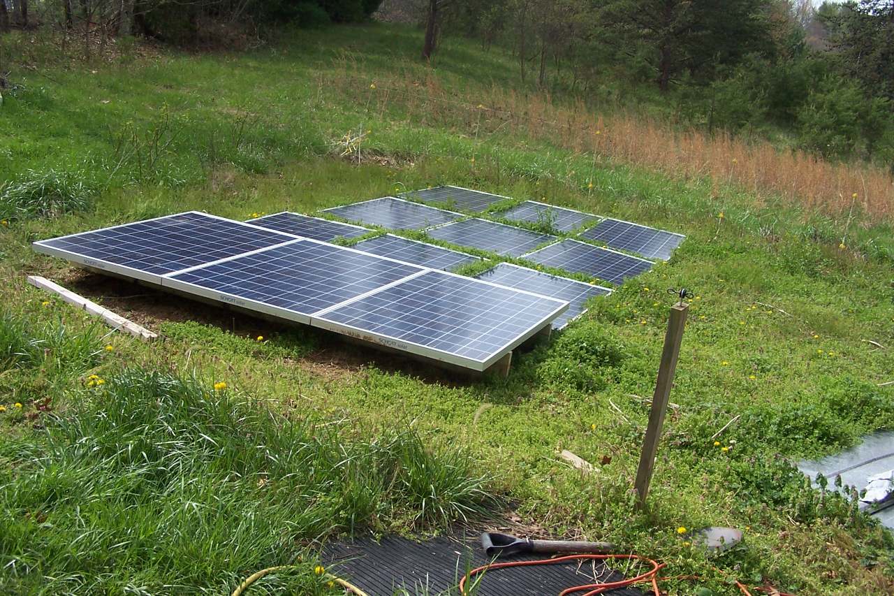

New panels - now to put them into the sky

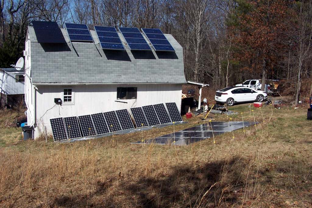

This reminds me of a story of some good ol boys around here who needed work and applied at a chicken farm. They were loggers by trade, but there was no work doing that, but they figured they could do almost anything (largely true). So they show up at the farm, and say we want work, what's the job. They get taken into this many acre warehouse utterly full of chickens - pretty much all touching. The guy points at the chickens and says - put these in those trucks over there, and you can go home with a paycheck. Needless to say, they were real happy to quit at the end of the day!

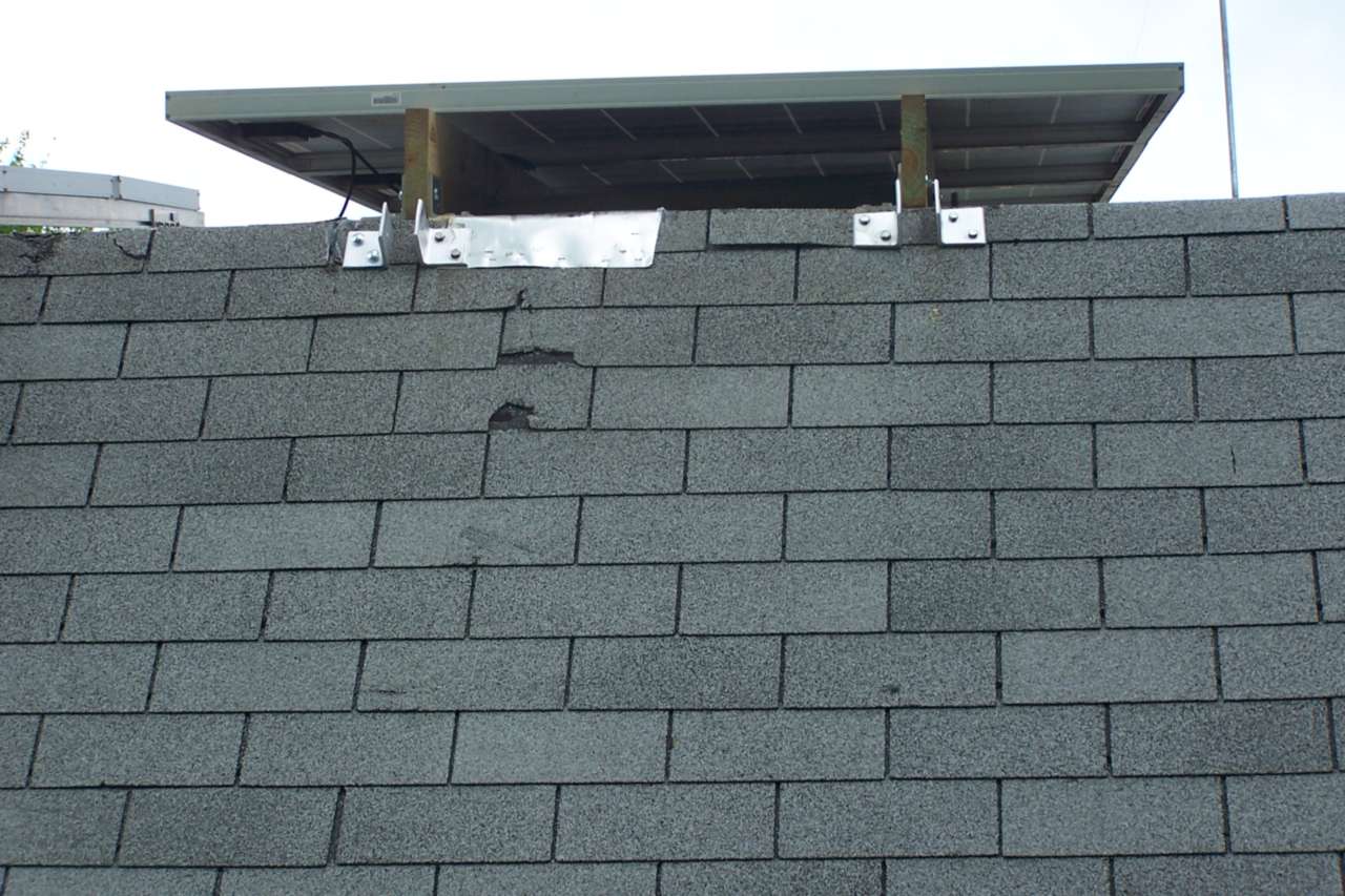

Same here - take that solar garden and put it in the sky. Easily said. This will pretty much cover the whole roof - the plan is to have top racks going back past the peak, and front racks going down over the steep part of the roof, but levered out some, and hopefully, all strong enough to handle the odd hurricane that comes through, while no one gets hurt doing this. I'm sure there will be some amusing video to come of this.

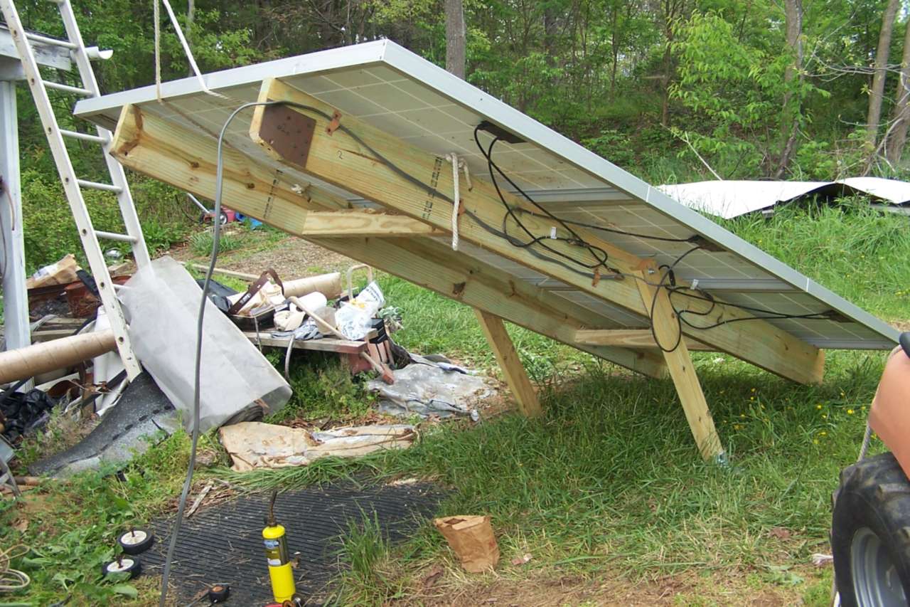

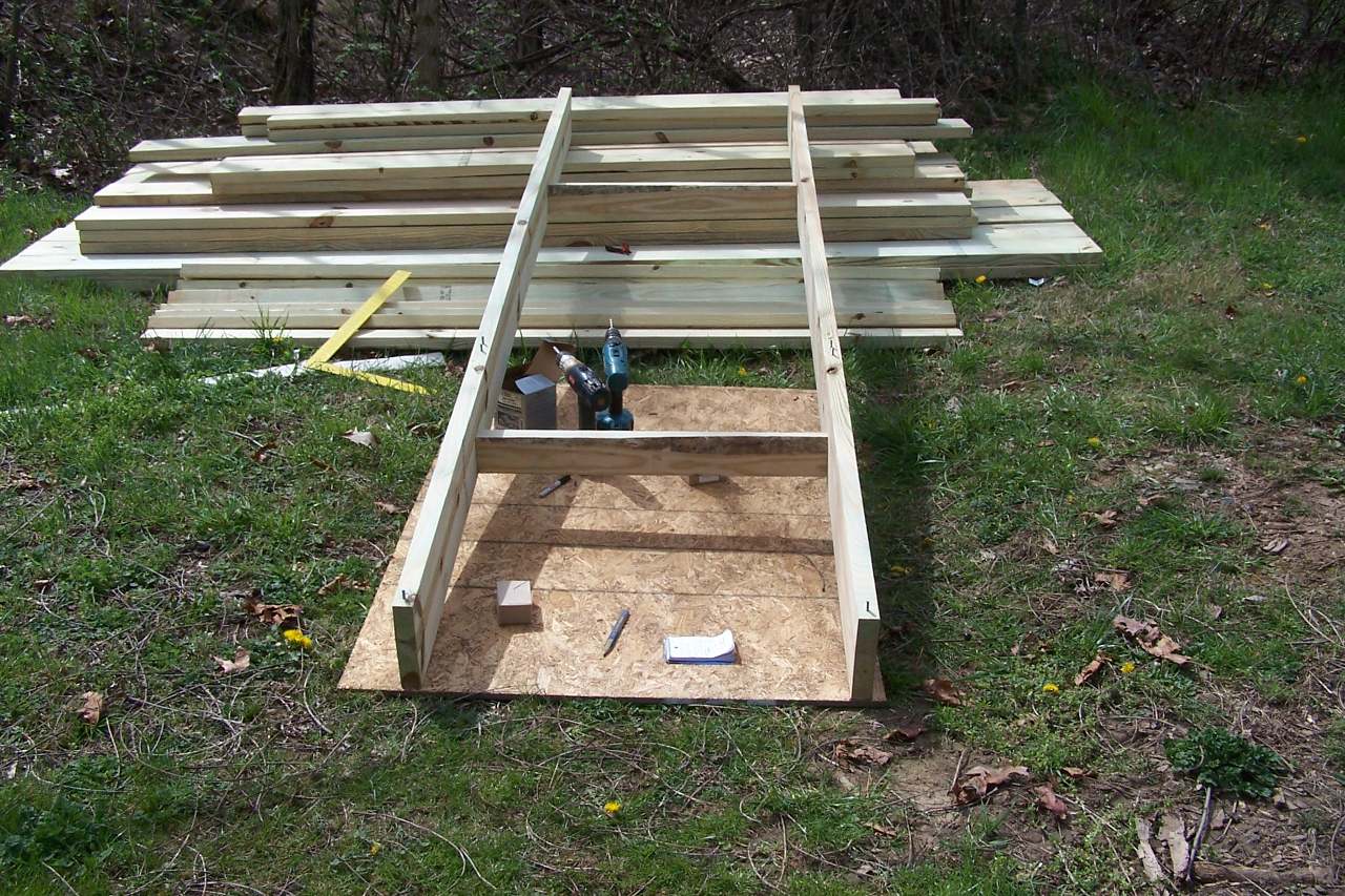

Just some pix of the work in progress. I decided (hopefully not-stupid) to make wood racks for all the panels. Nice and heavy (we get wind), treated wood, and a heck of a lot less expensive than aluminum ones, which these days are getting pretty flimsy to hold prices down. I can predict it's not going to be too much fun hoisting these up there with a winch, and going to the steep dropoffs to put in the roof bolts, but sigh, you gotta do it. Hopefully only the once.
Rack in process. I got stainless steel studs with lag threads on one end, 1/4-20 on the other to mount the panels with.
One set on its half-rack. It will take two sets to complete one "bay" on the roof, one over the peak, the other down in front.

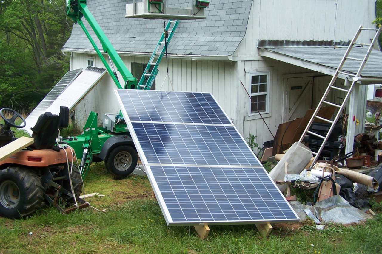

Now we're really getting serious. Rented this cool electric/hydraulic lift for about $670/week at Sunbelt rentals and towed it in. What a neat toy! It's not in just the right spot, but as you can see, it was pretty amazing to get the truck through there at all, and once we've mounted a few of the new racks up on the roof, we'll be able to position it better. More to come, of course.
http://www.youtube.com/watch?v=DfRHljKd8-s

Well, the thing wasn't stable enough to suit me hung out to the ends of its booms, so we moved it:
http://youtu.be/8XCRlMhUlU4
This was problematic. Had to drag off some racks with the tractor. Had to get the truck in there - never got it quite angled right, pulled the thing towards the east end of the house, tried to turn it tounge to south, and almost made it before the usually unstoppable Honda Ridgeline just couldn't do it - garden dirt. So, we chocked a wheel and pushed it the rest of the way straight with the lawn tractor (this one's real serious as those go, though, hydrostatic drive, fluid filled ag tires). Hope I can get it pulled to the next spot, which seems like the plan at the moment. And oh yes, back when the rental is up - I'd love to have one, but the terms probably wouldn't suit.

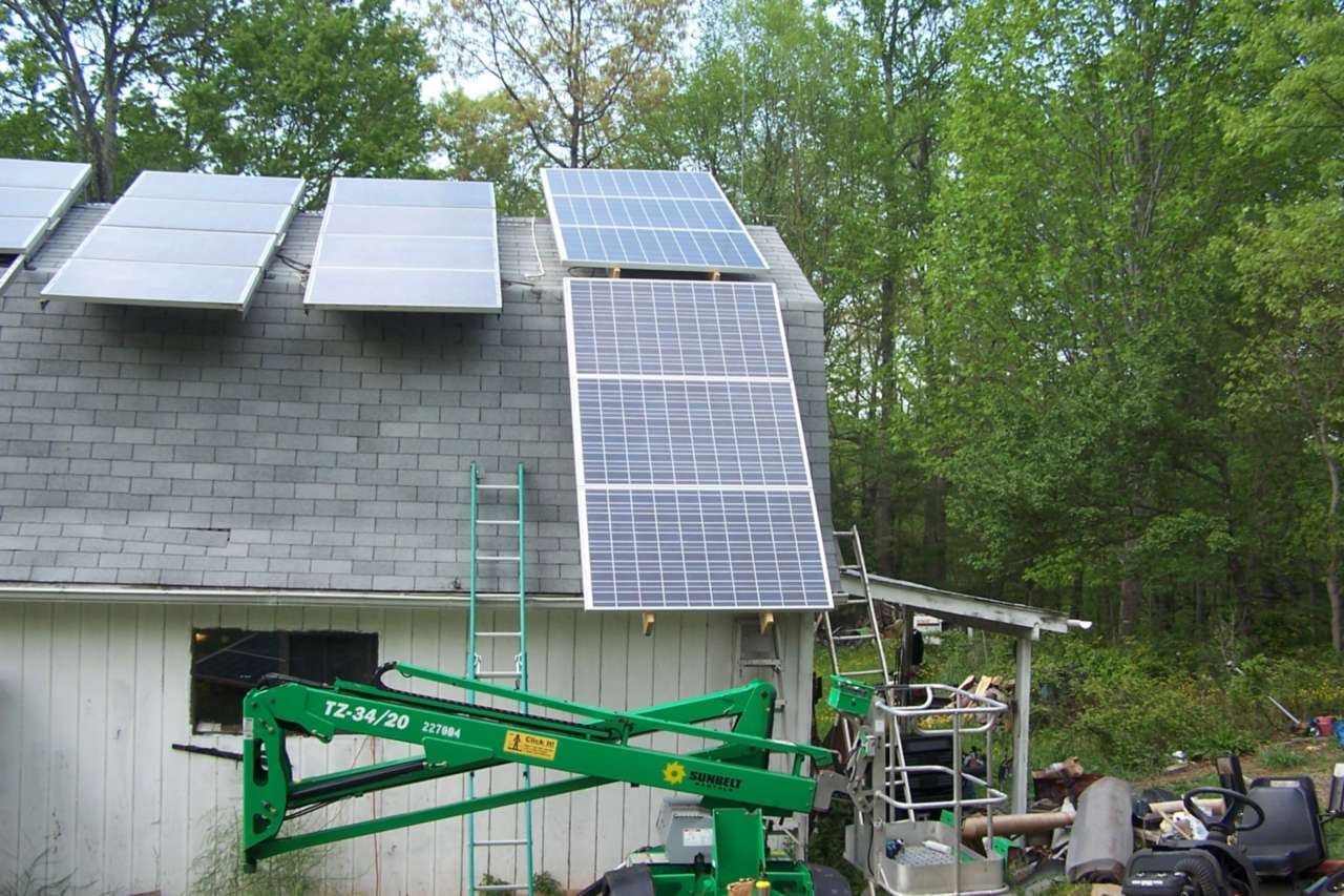

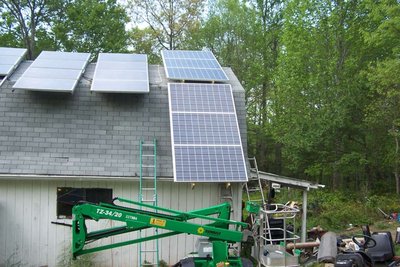

A little more progress - one full rack, 720w x 2, now up and in place, all the bolts tight. I'll probably add some trussing to that bottom half rack to handle the odd hurricane, but it's pretty decent - you can stand on things and no wiggles. As soon as I finish this post, I get to go up on the roof and do a bit of wiring. Having this one done means I worry less about disconnecting the other panels while working, as this is 1440 w, and is replacing 4x120, or 480 watts that were in that slot. Looks like I got it a little crooked, sigh - may have to leave gaps between the racks anyhow to be able to get in there to put in bolts and such. Had a plan, but I'm not crazy enough to stick with a plan that is showing too many problems either. Pix:
Wish it was miller time already, and it is almost 5:30, but just a bit of wiring and I've got power tomorrow as soon as there's sun...and then it's really miller time.
