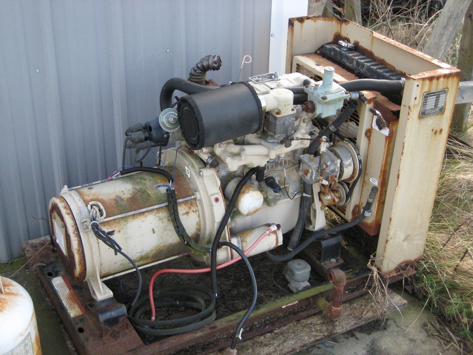

A neighbor has that Generac, I might be able to borrow his manual for you. His only troubles with it are carb icing in winter, and well, what it costs to run it.

Bill, my 8kw Onan was such overkill for my house - all loads combined, that I couldn't keep using it, too much fuel wasted. All you should have to turn off is electric heating/cooling, the rest should be fine. I'll be glad to help move the thing into place, just let me know - I can probably bring PaulS along, or one of my other strong pals with a good record of "getting 'er done".
I'd bet that Lister will do more than you think, if the ancient generator you have on there is up to it and has decent load regulation. New units 10kw size aren't too expensive (and weigh a tithe of what that one does). It's good to have a generator rated higher than the engine can drive, as this gets you less copper and iron losses. And brush-less.

This is my Generac generator. I could probably find an aftermarket regulator for it to use in a new system. I'll have to work on getting it apart to check the overall condition.
16kW Generac generator
