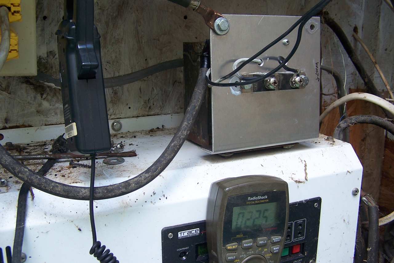

So, (and BillF found this) I ripped apart an old industrial forklift battery charger we got surplus, because its computer stuff had failed. It had a really nice ferro-resonant transformer good for 24v battery charging with about 30 amps max output when the output voltage is low. I swiped the transformer out of it, and replaced its original diodes with some nice 200 amp shottkys, and am now testing that. It seems made to order for this job so far, quiet (when under load, which it's hardwired to be), efficient, predictable load on the input, nice taper charge on the batteries, the current goes down with rising voltage a lot more than it would with an unregulated charger. The Honda nicely throttles down when driving this, and is nearly silent, while using almost no gasoline (something like 12 hours per gallon) and everything runs nicely cool.
The charger. Amps are low because I did this on a fairly sunny day and battery volts were high already.

I just found out what happens when the sun comes out while that Honda + ferro resonant charger is running, as I was outside making a trunk fitting for the Cruze. The thing just goes to idle, as the charger stops drawing current right as the battery voltage hits 29.5 -- perfect! That one's a winner. I may make another to parallel with it for those times I need a little more juice.
