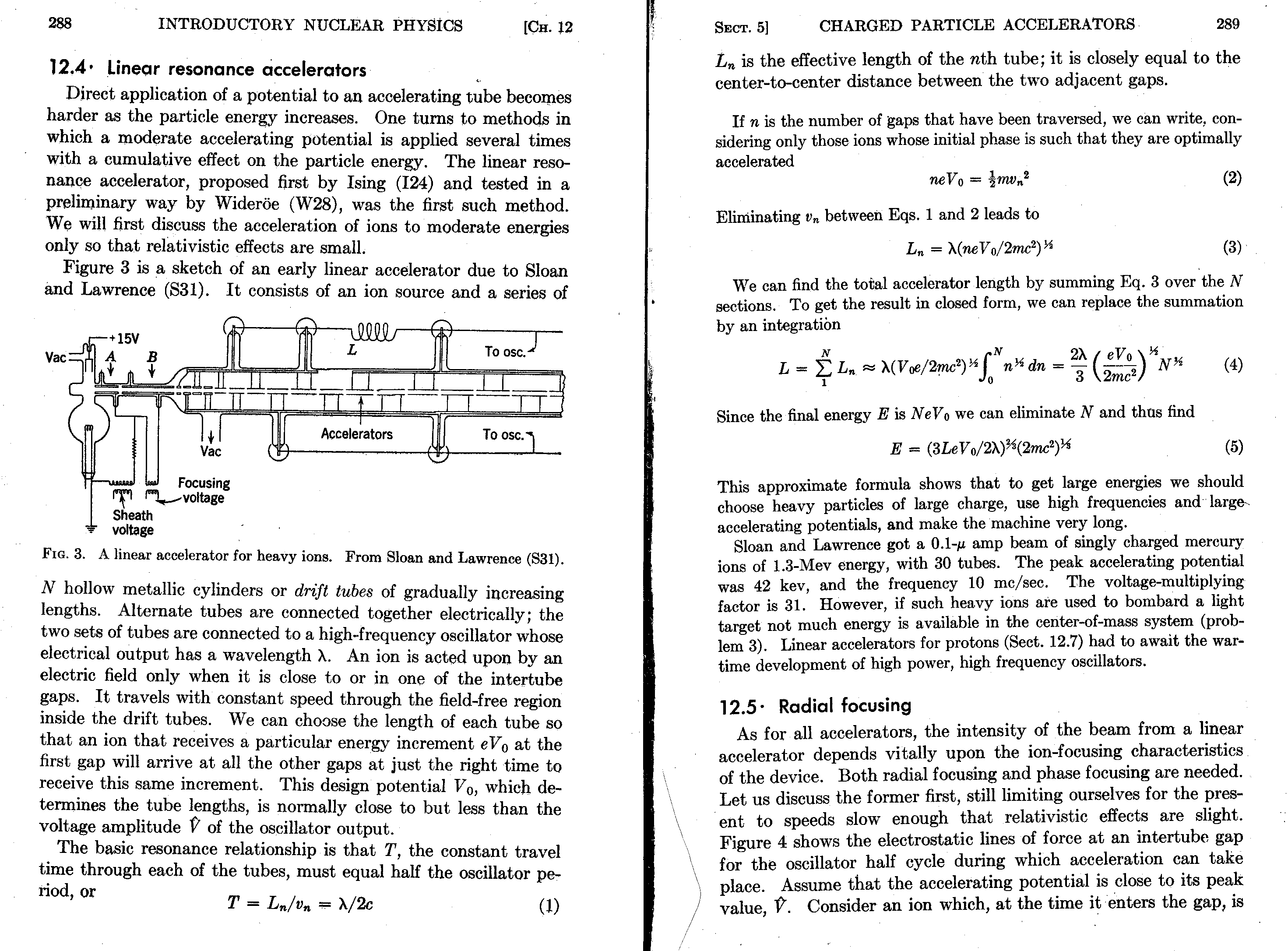

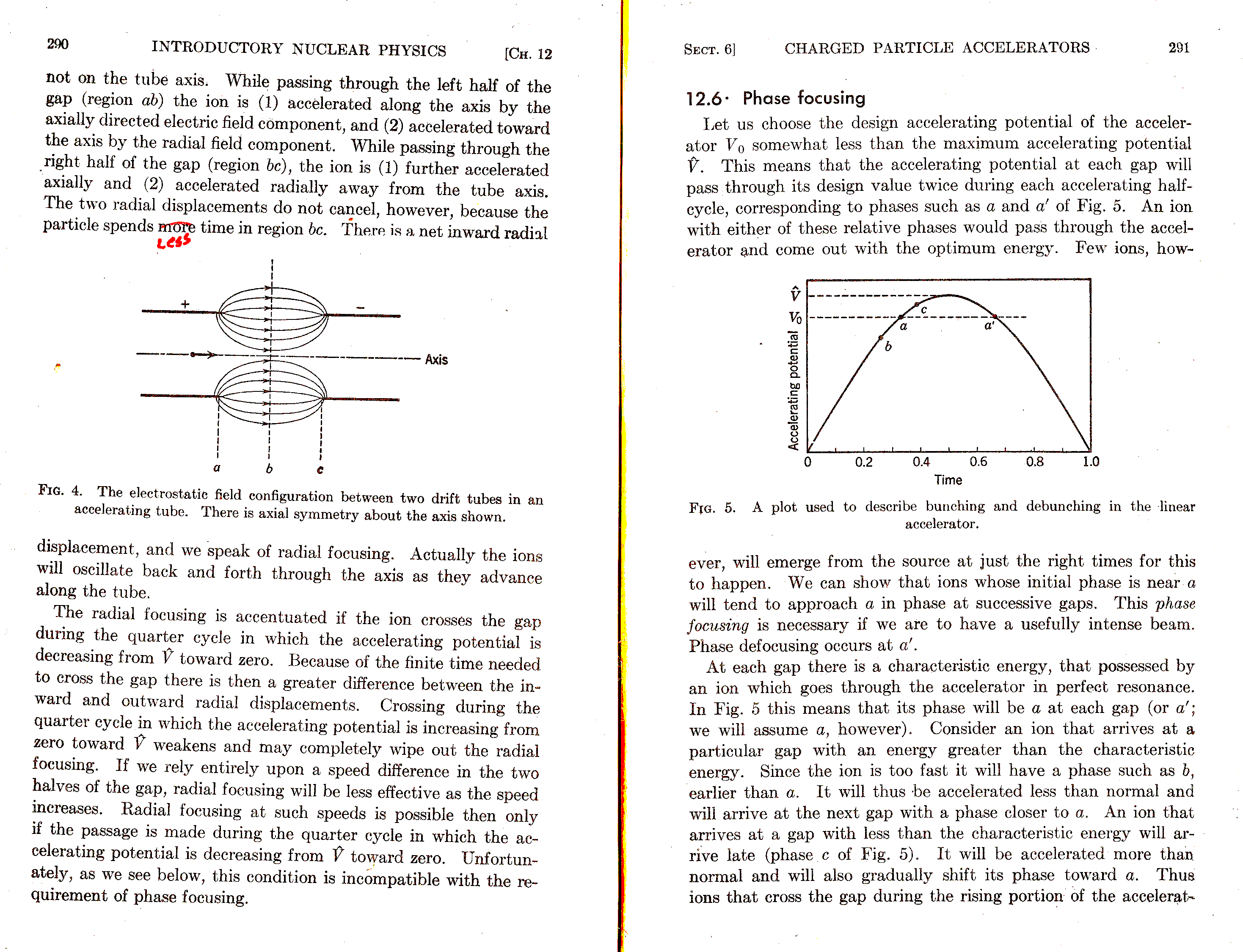

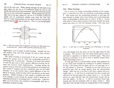

For those wondering what in the world we're talking about, a few pages from Haliday here on it. I will probably use my uwave ion source, and handle radial focusing like Alvarez did via lens aperature design (taken from Terman, of course). Just a couple books from back in the day that don't seem to have lost relevance.
Haliday on resonant linac drift tube design
More on drift tube accel issues
This is spread out over a few threads here. I'm using speed of particle calculations from another thread to get tube lengths and speeds/feeds, and detailing the physical construction of the device in yet another one (or a few, if I've not posted the design for the magnetic wiggle stick, that gets a thread too). That thread needs updating, as I've made a target/probe holder and some targets for it. Funny how one project really won't fit into any one thread and keep true to the title and organization, but that's just how science, and especially research is -- a little from here, a little there and then tying it all together.
