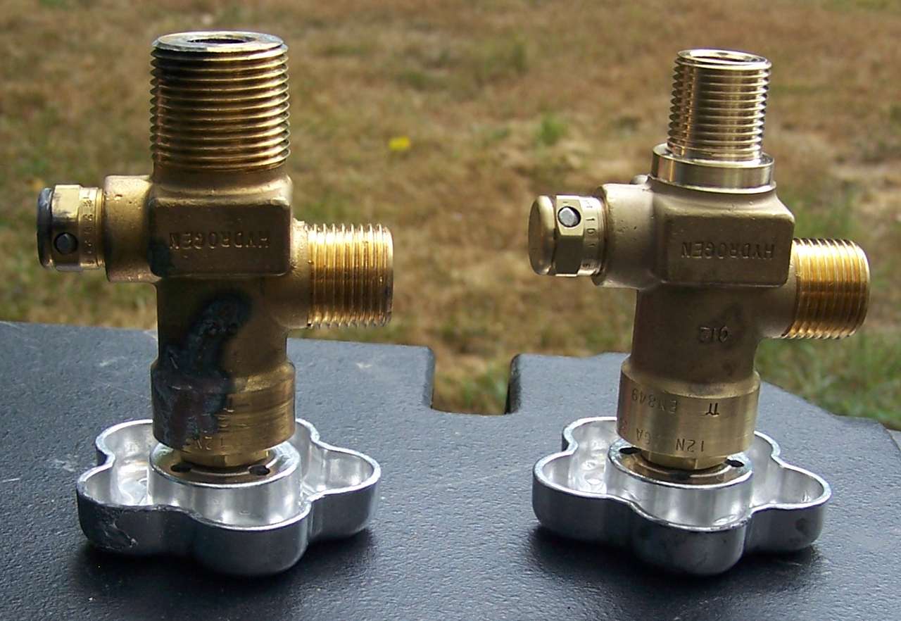

Bill Fain found all this stuff - some very nice aluminum tanks originally for medical oxygen or firemen breathing apparatus, and some correct valves for hydrogen. The tanks were pretty "used" and nasty looking, while the valves were threaded for a larger tank, while the oxygen tanks have a thread "all their own". Obviously a little machining and fab has to be done to get to the goal.
Since Joe Jarski does precise machine work better than I, and this is a place where that really matters, Joe did the valves.
Valves before and after Joe's work
Luckily, these had enough extra meat on the stems to allow this. Now they fit perfectly. "Like buttah". He won't brag, so I'll do it for him.

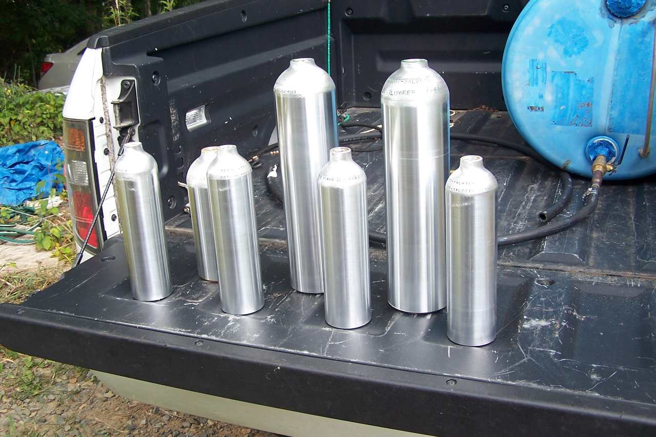

Then I took a bunch of those ratty tanks, and cleaned them up on my lathe:
Tanks, outsides cleaned up.
I now have to make a little punch/die to make the teflon gaskets - many were lost before the tanks got to me, and we found (the hard way) that viton isn't good enough -- slow permeation by the hydrogen. I will also be detail-cleaning the insides of these tanks, and then baking under vacuum before doing the gas transfers, to keep at least 4-5 of the 6 nines purity of the gas we have.
It's not easy to get these outgassed -- takes a long time through the valve. About a week of heating (not too hot!) and pumping each is required. Since we're working with hydrogen, I may put a few pellets of lithium into each to act as getters for residual air and water as well.
We like working with the small tanks for a variety of reasons. For one thing, in case of accident, you don't lose too much, or create the possibility of an enormous explosion. It also makes it much easier to keep track of how much you're using (or wasting). Further, those interested in getting some now have a way (or will shortly) though these can't ship legally at this point. They are mostly out of hydro for one thing, not rated for flammable gas and so forth. But better than nothing, and we've already jumped through the paperwork hoops to get the gases in the first place.

They were something over 1/4" thick originally, or .250"+. I took off about .050" (they weren't perfectly round) to clean them up. They started out rated at 2500 fill pressure. I'll be using them not over 400psi. That's partly because that's as far as I trust my other plumbing to do the transfer, but it's a happy number in general. As the big tanks get drawn down, I won't be able to even hit that -- my big D tank is about 550-600 psi now. Not sure what you mean by "test gas" though of course that's what they are now! Gas to test fusors and accelerators with! I've gotten the valves into a few of them, letting the thread seal goop get hard, might try to test-fill one tomorrow (for a bubble leak test) or the next day. Patience seems a good idea where glue type things are involved. I'll see how bad they outgas once the goop is good and solid. I really cleaned up the insides today. Water+ detergent, 4 rinses, rinse with ethyl alk, then put in front of a heater with compressed air blowing into them for a few hours.

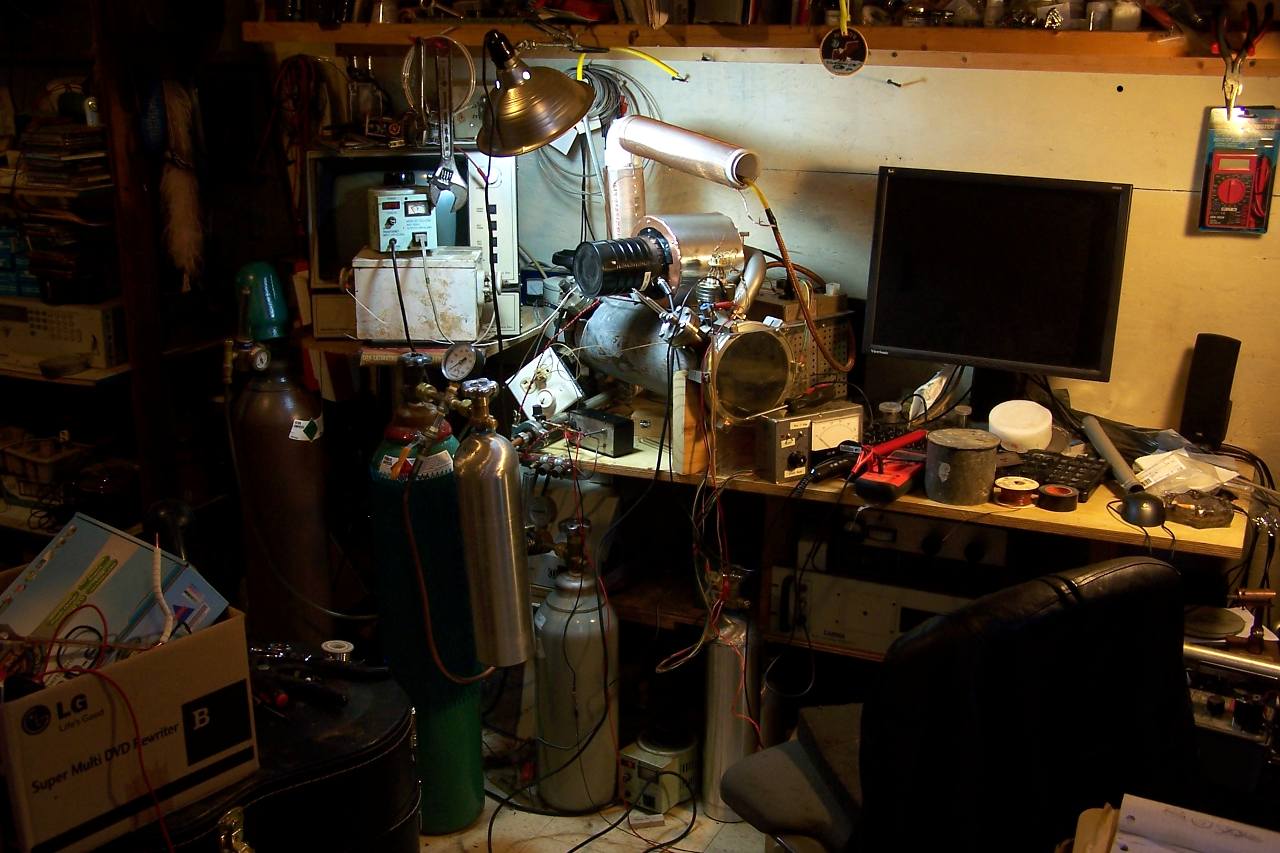

REady for action real soon on this. Here's the setup. I used a stainless steel cross, a ball valve in a vacuum line (hooks to the upstairs small fusor system) and some CGA fittings to make a gas transfer setup. The drill is, you open the ball valve, and the valve on the recipient tank, and pull vacuum on the whole thing. Once satisfied you're done outgassing (perhaps heating the new tank to make that go faster), you close the ball valve and open the supply tank valve -- slooowwwlly. To reduce the inrush (and let me control the pressure to within what the 400psi gage will take), I've drilled and tapped the CGA fitting on the supply side 1/4-20 and put a bolt in there, tight. That's still enough leak to flow a lot of gas, plenty fast enough. Right now, after 20 min, the vacuum system is reporting 1.4e-4 mbar. This system has a base of 4e-7, so there's a couple decades to go before gas transfer would be good -- if I want to keep the purity, which of course I do. Like in stock trading -- hurry up and wait is still the fastest way even if it's sometimes excruciating to do.
Gas setup and upstairs fusor
I might put a space heater or IR heating lamp on that small tank to speed things up a little...next time I get a sunny day, that is.
