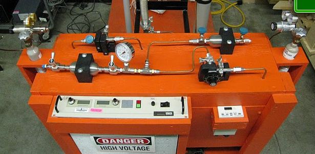

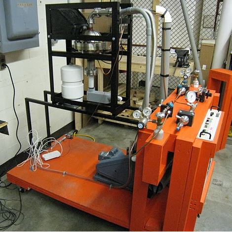

Alright, we've been EXTREMELY busy since my last post, so this is going to be a long one. Our radiation shielding team decided to orient he reactor vertically now versus the previous horizontal arrangement. So we had to re-run all of our fill and vacuum lines after we had them fixed. Its their part of the project and it looks so much better now, so I'm okay with that. So our new setup is shown below.
The new setup; the black box on the top left is lead shielding for the camera.
Fill components and the power supply

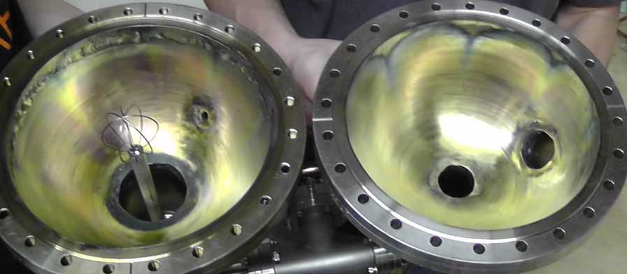

To put the reactor in that new cage structure, we had to take apart the hemispheres. This was the first time it had been open since we got our first plasma back on March 1st. We found that the 304 Stainless Steel was now a golden color on this inside. From my research, I have only been able to find that 304 SS turns "gold" at 400 C, orange at 500 C, and so on and so forth. I don't really have a better explanation than that, does anyone else?
Inner shell of the Sphere.
