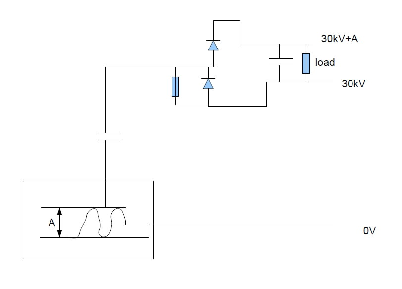

Can you give a bit more on what you're trying to do, Joe? If it is for AC on top of the DC, you may be able to use a charge-pump arrangement, isolated with a cap.

Like this Joe. [Is this right?]
You can run a charge pump on top of an isolation capacitor to get your voltage bias, recitfying the AC up at the high voltage [or add -ve signs, to taste!!]. If you want AC, just delete the upper diode and parallel cap.
(Turn the volts up slow, so you don't roast the diode)
Re: WTB - Isolation tranformer...
That should work if the stored charge on the initial series cap doesn't make troubles. If the 30kv is arced to ground bad things can happen at the AC supply end...

Quite so. Yes, best to add some sort of transient coupling from the top of that AC to ground as a sacrificial short circuit in case the isolation cap has a breakdown, or gets pushed to -ve polarity under a breakdown on the other side. A spark gap or transient diode maybe?

Chris, my intentions right now are to just provide a negative DC bias voltage (relative to the cathode potential) to a "suppressor grid". In the future I may be looking at using AC in a similar setup for bunching, but not until I have something operational.
