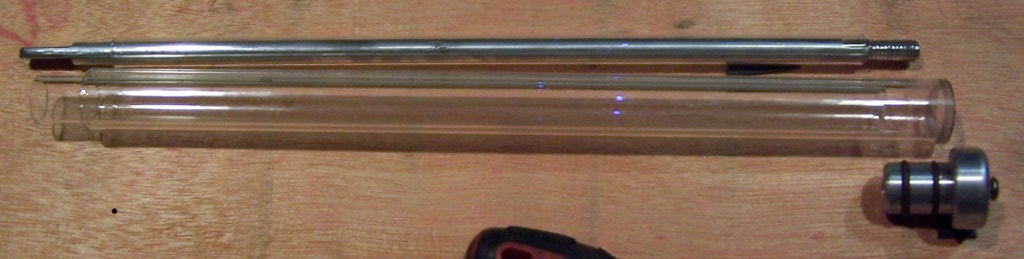

Well, I finally got one that doesn't seem to have any of these problems, finally, and right now it's in the big tank where I can't easily take its picture. But we are preparing another fusor on the upstairs smaller system, so it needed a good feedthrough too. Made one (or did most of the work) today, and since it's not mounted anywhere, I have pictures.

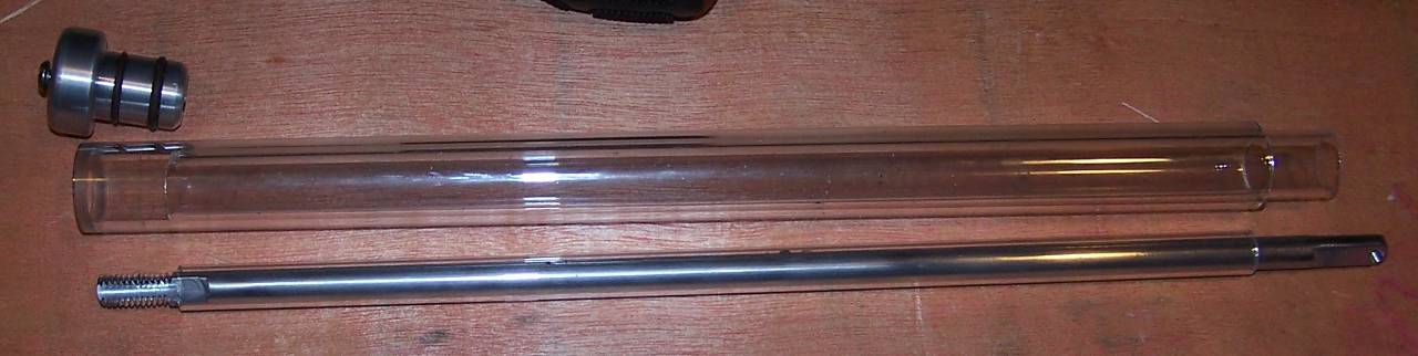

Feedthrough parts
The other side of things
There are three layers here. The outermost is pyrex. It has kind of a high dielectric constant, but is also a lousy insulator as these things go. That turns out to be a "feature" rather than a bug. On the outside of the tank, it acts like a voltage divider, obiviating the need for corona rings to make sure the voltage gradient doesn't get too high somewhere. On the inside of the tank, the whole thing sits at ground so it doesn't attract ions. Just inside that is a tight fitting thick wall quartz tube -- the main insulation. It only touches high voltage at the outside of the tank end. It does not contact the central rod. It also extends further than the pyrex into the tank. That part can become conductive (due to chemical reduction) and it doesn't hurt a thing, but extending it past the pyrex protects the outer layer, and keeps losses due to ions just smacking the conductor down. Tightly fitting over the center conductor is another piece of quartz tubing, kind of a belt and suspenders arrangement. It would be quickly ruined (shattered) if it extended out to where the ions would hit it, and it would arc through at the voltages I want to run anyway, due to the dielectric constant and charge collection. I know, the usual way -- seen them explode and try to dump shards into my turbo pump.
The conductive parts of this are 6061 aluminum, which will be anodized before use. I've found that this adds a few KV worth of goodness, and prevents high current density sparks to a point on the surface. I'd suppose a coating of carbon black might do that about as well, but anodizing is easy and more permanent.
The main "plug" was turned on the lathe to be 20 mils or so smaller than the ID of the pyrex tubing (in this case, about .79") and O ring grooves turned into it. Only the one near the vacuum end actually seals, the other one is just to help things stay straight. There will be a third larger O ring cushioning the end of the plug and pyrex so it doesn't see too much stress. In this case, I might not use an O ring, but a big chunk of teflon with a hole punched in it, maybe about 2-3" diameter, to insulate the HV air side from the tank area, and prevent (or attempt to) arcs down the length to the tubing coupler/clamp on the tank.
My upstairs tank, originally designed for beam on target work, is 6" diameter and 2.2 feet long, with the feedthrough flanges coming in through the sides, in this case the top of the main tank, which is lying horizontally itself. This means I need a 90 degree turn at the inside end to mount a grid on the tank axis. So, as you can see, I milled some flats on that end of the 3/8" rod and tapped through it sideways with my usual 10-32 hole for a grid mount screw. The other end of the rod is tapped 3/8-16, as is the end of the plug it screws into. I milled a flat on those threads so as not to have a trapped gas pocket in that part. I tapped the other end of the plug 10-32 for the HV lead to bolt onto.
So, all this goes in the ultrasonic cleaner overnight, and tomorrow I anodize the rod (at least), and make the clamp/collar needed to keep it from creeping into the tank through the tubing coupler, and we're done with this. Or almost. There will be some tiny dabs of high temperature silicone to keep the glass pieces from sliding around, up near the plug end of things.
The beauty of this design is that it costs less, works better, lasts longer than commercial ones, and on top -- to fix it when it breaks (if it does, these are getting pretty good) all you need is to cut some more tubing. The $70 tubing coupler lasts forever, as do the machined parts, and fixing one of these is a snap and costs very little should you need to.
This has been almost as long and hard a chase as the gas control stuff, but the other one I made just like this (except it's tapped into the end of the rod for the other system) has already gone more hours with less trouble than anything else yet tried, and looks like living "forever", at least in this context.
This is something you machinist guys can copy with some confidence it's not a waste of your time and materials. With this, you only need a 1" tubing coupler for the tank, which is also something a machinist can make (I have, but it's less trouble to buy one).
This one is expected to stand off 60kv on the little system, and the aluminum should help it carry off heat. Should I get back to the beam-target stuff (likely) I only need to make another like this to fit the flange on the other end of the tank, put the other polarity on it, and have 120 kv for that....
Now, we think we have a 160kv supply coming. I kind of doubt this design will do that as is. Stay tuned!

Doug, thanks for the update on your latest feedthrough. That's one of the things that I've been putting off for a while, but will have to make soon. It looks like this new one is a lot easier to make - no more quartz blowing, just cut the tubes and stick them together.
Re: Getting high voltage into a vacuum
Postby Doug Coulter » Wed Apr 06, 2011 8:47 am
The only parts hard to get right are machining that plug, and I forgot to mention that I chamfer the inside of the pyrex at the plug end to make pushing the plug in easier and not nick the O ring.
I'm using about a 15 degree angle, and cutting out about half or a third the pyrex thickness there, to about 100 mils into the pipe. I always do that ad hoc after measuring the actual ID of that piece of pyrex, as it varies a little.
I very gently flame polished that chamfer with an attempt at annealing after grinding it on there. If you make the O ring groove too tight or too shallow, you break the glass, if too loose, it doesn't seal well. You can't really polish it smooth with flame, or you wind up shrinking it, but you can round off all the really sharp little corners due to the uneven diamonds on the stone you use to do the chamfer -- kind of dull it a little so it doesn't cut viton and doesn't have an easy place to break under insertion pressure. I use my grease, which is 80% beeswax and 20% forepump oil to lube the O ring, or you can't put it together. It gets gone after awhile...
I've also done the plug and rod with OHFC copper and just brazed the rod through the plug -- works great (this is what's on the big tank) but is harder to do. The other variant on that is to turn the whole thing out of one chunk of aluminum -- also works great, but wow does that fill the shop with lathe swarf. This last one wastes less stuff. So far, I've not manage to melt the Al versions I've made, even with the head of the bolt screwed into it orange hot -- carrying out the heat is a moderately big deal and all these do that well. I've been known to add a little surface area (drilled pipe cap held on by the main connection bolt) to the air end to help with that. The big tank now has all that inside a PVC pipe with an air feed that blows over it. Else you can get the end so hot the viton starts to gas.
The real trick/magic here is at the end where the rod gets into the tank. You just have to leave a little of it completely bare it seems. I'd tried having a tight fitting piece of alumina there, but it was nothing but trouble. In this design, the outer quartz doesn't touch the rod, and the inner quartz ends fairly far back in there as it's not thick enough to handle the full voltage (and it may not even be needed, actually, but...seems good to have as much insulation as you can around the area that goes through the grounded clamp).

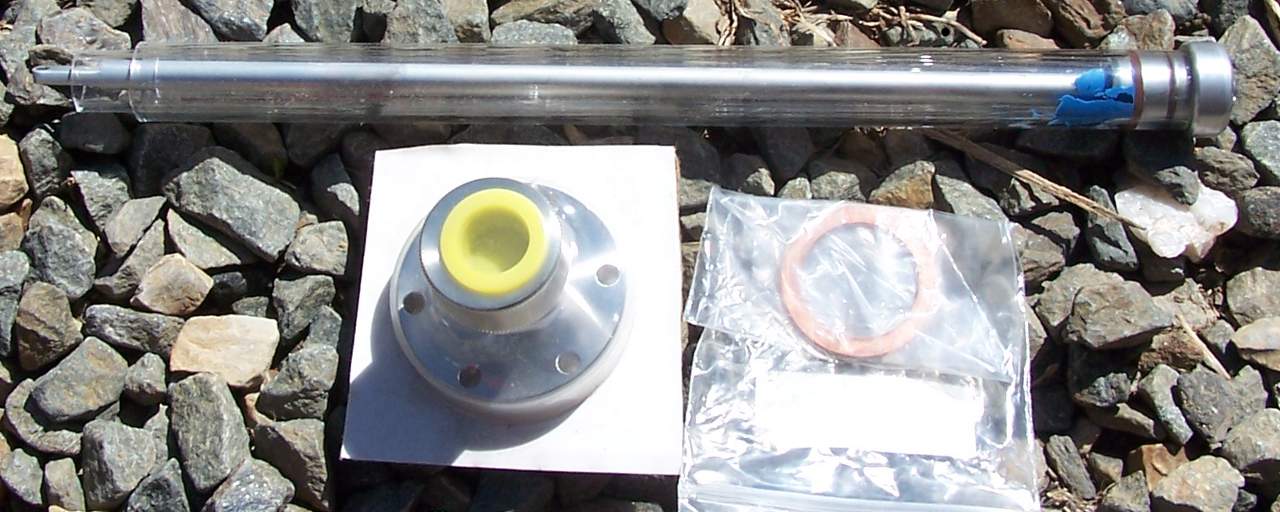

One final picture. Here's what all those parts look like assembled. The blue gunk is some special silicone from the autoparts store. This is the good permatex stuff, medium high temperature, and it doesn't give off acetic acid on cure -- it's some different chemical from the normal goop. The real high temp stuff (orange) does give off vinegar, and takes forever to get hard, this is a test compromise. It's in there to keep the inner two pieces of quartz from sliding out, as this one will be used vertically.
Final assembly, ready to put into use.
