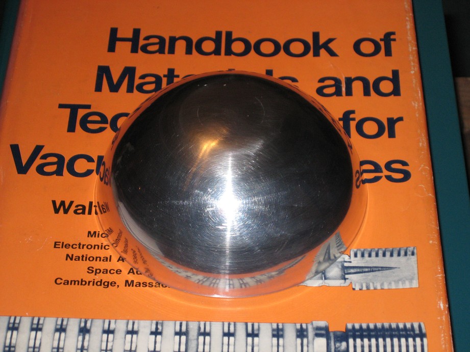

I'm just beginning to get started on my fusor and thought it'd be convenient if I could make my own hemispheres or whatever else I might need to make. So I decided to try and take a shot at spinning some parts. This is my first try - it's spun from 3003 aluminum, .050" thick. The finish is excellent - it looks like it's been buffed. The material is too thin at the edge so I need a little more practice at controlling how the metal flows, but it's a start. I have some 304 SS on the way also to see how that works.

Wow! Nice work Joe. Presumably you formed this over some sort of mandrel? Can you tell us about that - was it made from wood? Sounds like the metal experienced some radial elongation, if the lip is thinner than the original thickness. And there is no hole in the centre, so you must have pressure clamped it?

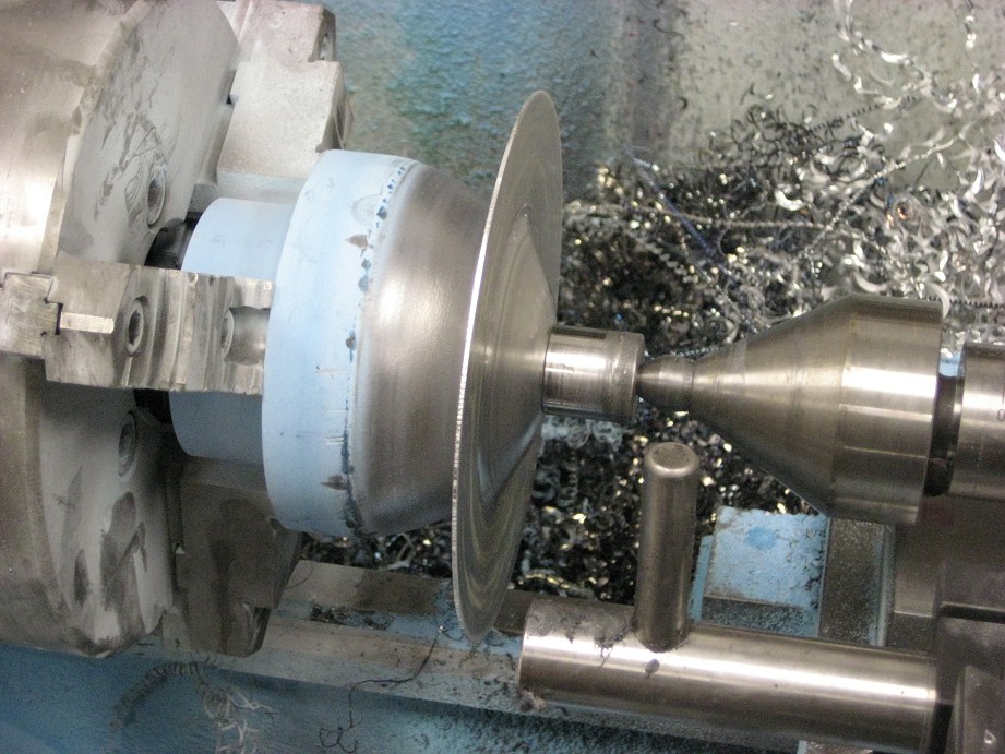

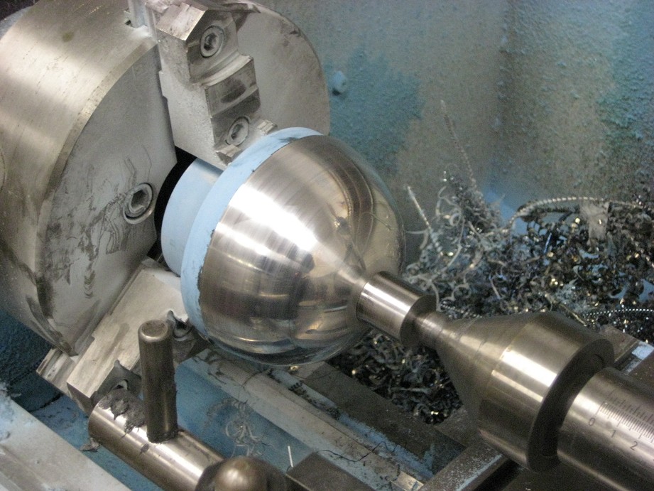

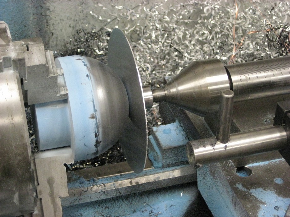

I spun about 7 more parts this afternoon trying different techniques, some for the better, some for the worse. I'm getting a wall thickness of about .030"-.035" now which I think is pretty good. I may be able to improve a little more, but probably not much. These are some pix of my setup...
This is the mandrel with a new blank clamped in place.

This was just after doing the initial set of the part on the mandrel.
The finished hemisphere still on the mandrel.

Nice lashup! Do you just push real hard with the tail-stock to keep the piece in there?

The part is clamped pretty hard, but the RenShape is a little on the mushy side so there is some give. I'm still waiting for one of the parts to fly across the shop like Oddjob's hat - I just don't want to be in the way.
