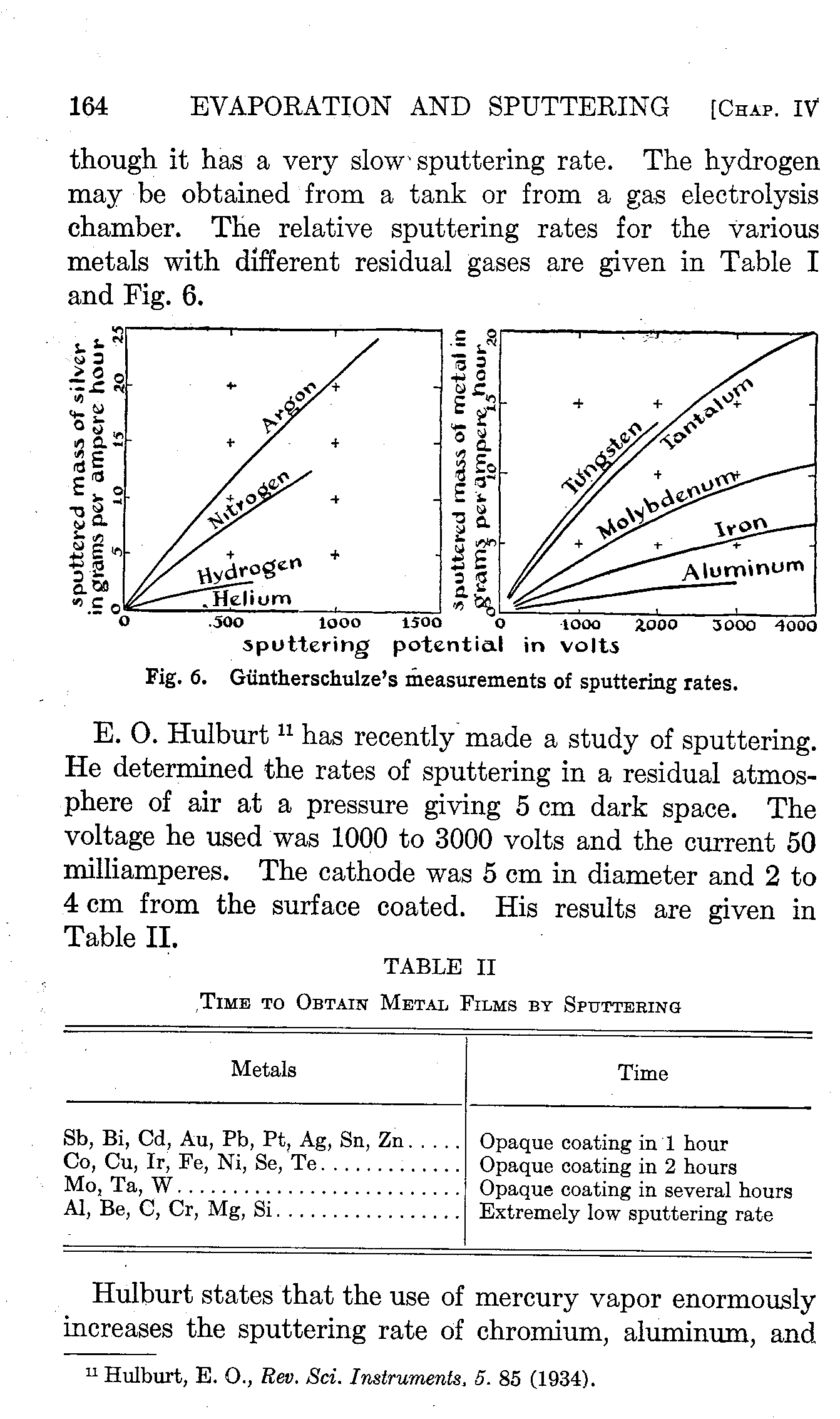

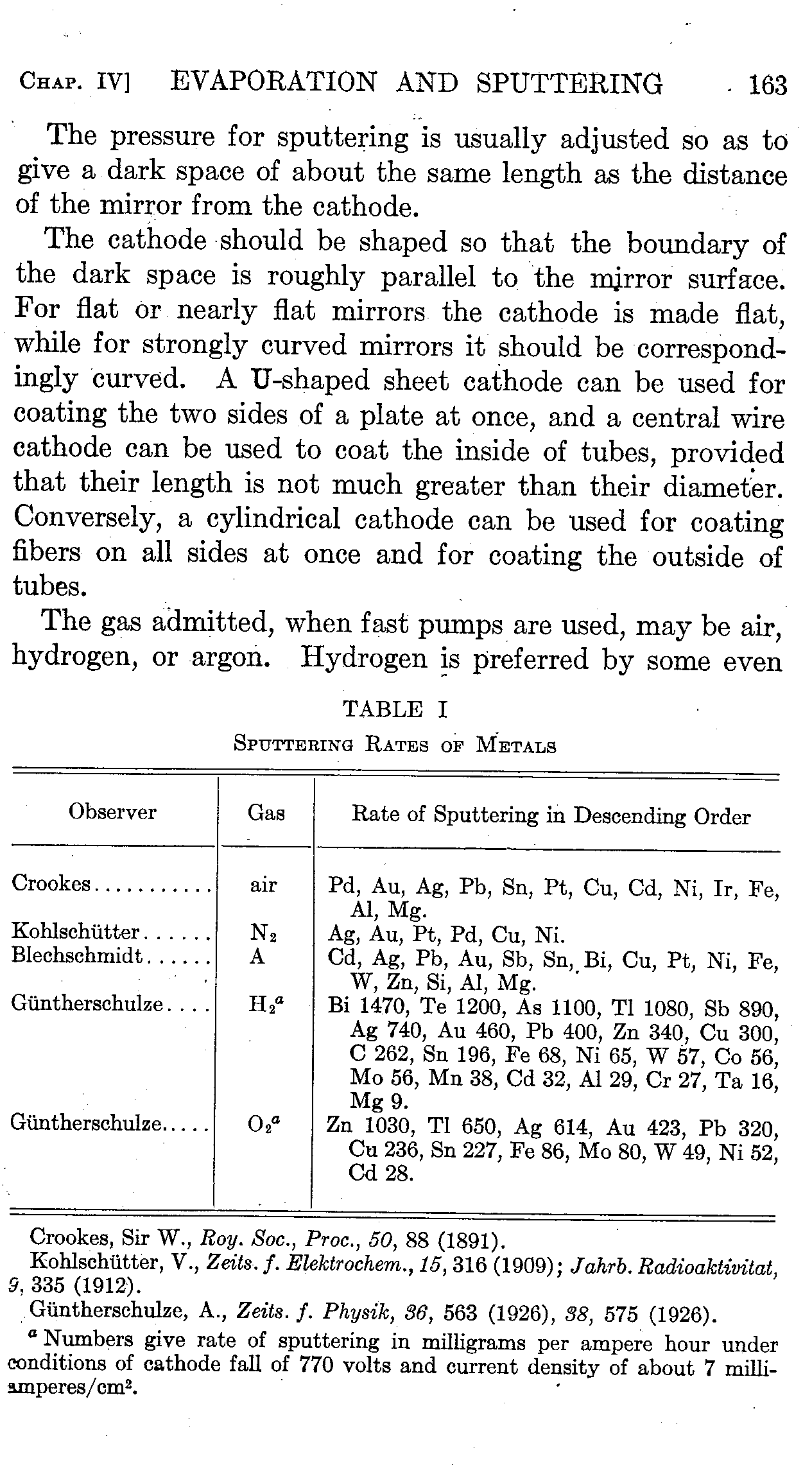

Here some ancient but nevertheless accurate info on sputtering and evaporation. As always, click the pic to get a bigger version so you can read it.
Sputtering info
Note, to our advantage, that most things don't sputter as well in the lighter gases. But beware of any heavy gas you have in there to do glow discharge cleaning or just contamination.

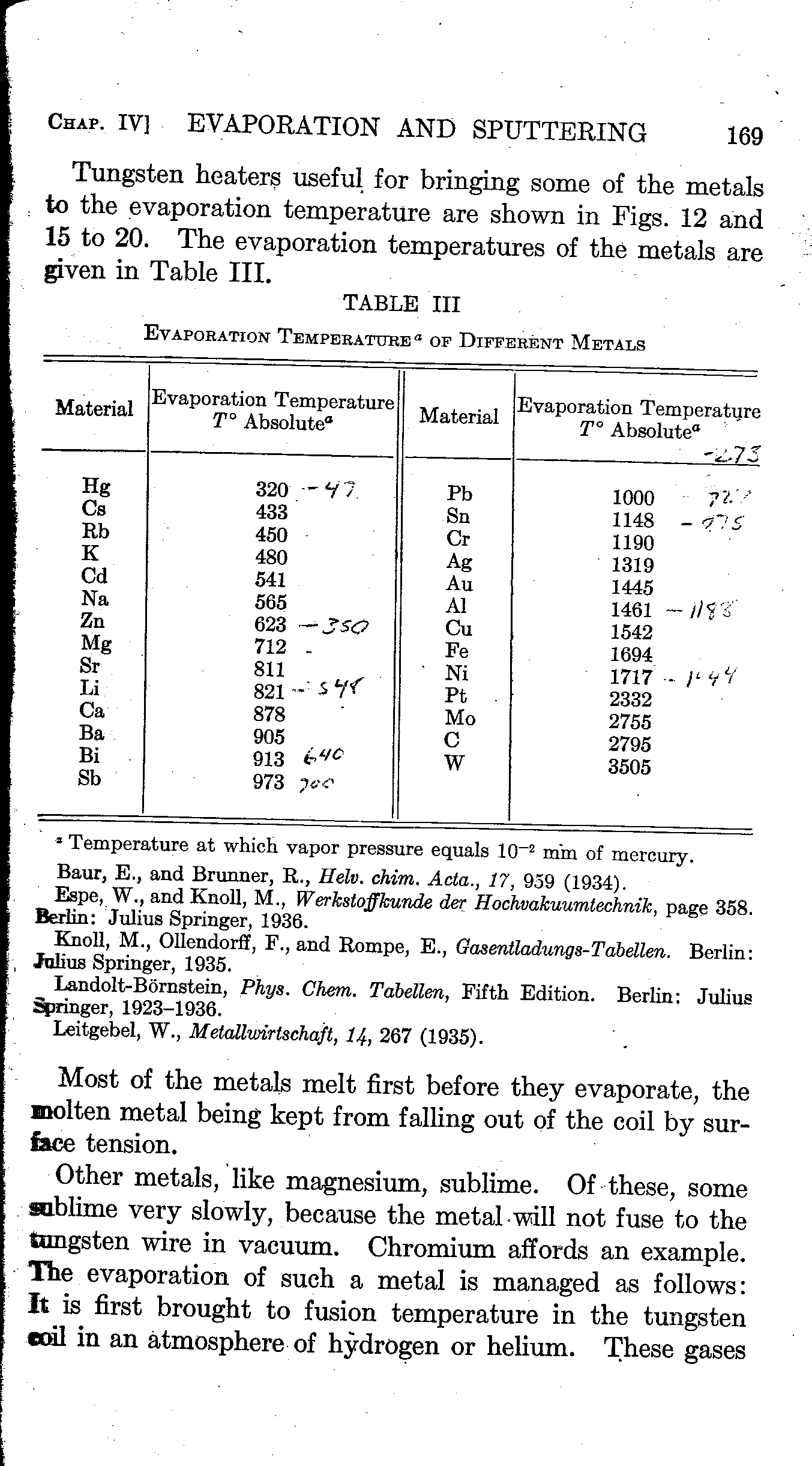

Evap info
Here's a list of how hot in Kelivn (some C numbers penciled in) things have to be to really evaporate fast -- as in pressures around e-2 mbar for the metals.
So, you can see what to avoid, and what works well.
