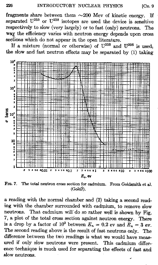

Cd cross section, log plot
Here is a plot of the neutron cross section of Cd. Click the pic to make it readable. Note how at low energies the cross section is 10k barns, but only
less than 10 to the point the plot stops.
Despite some people freaking, I even machine this stuff with high Cd content -- it machines nicely and just throws the usual stringy swarf onto a sheet of paper

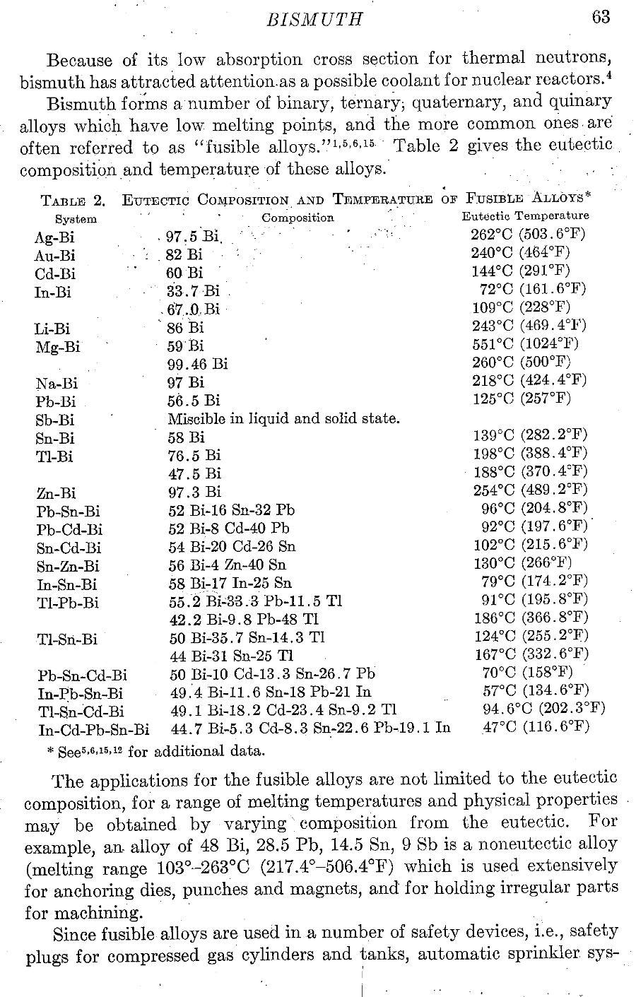

At any rate, since we're talking about Bi here, this is a useful page from the Rare Metals Handbook.
Bi Alloys table
Many Bi alloys expand on hardening, or soon thereafter, which is something that makes them good holder for delicate things you want to machine. The following page of the same book mentions that an alloy of 56 Bi, 20 Sn, 24 Pb (most of these are by weight, not mole). This one expands 1% in linear size.
