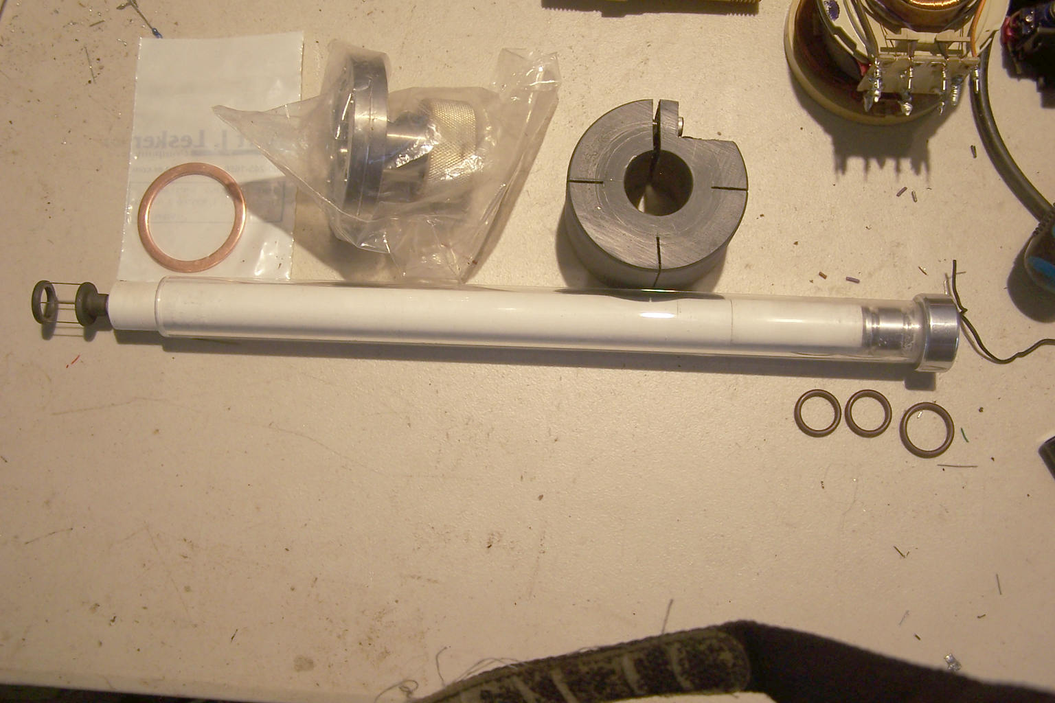

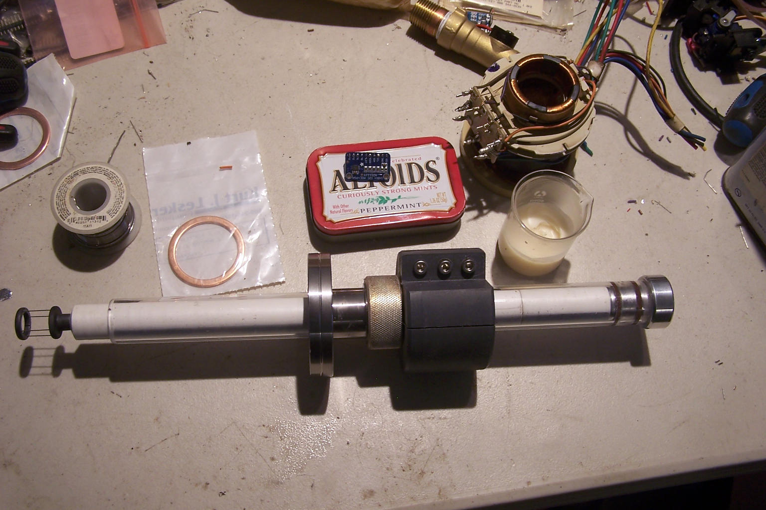

OK, here's the latest on this one (ion grid feed through). I changed the "stick out" of the copper part to near-zero, since it "didn't look right" and we know that things that aren't the grid sitting at HV in there just attract ions and waste power (as well as sputtering onto insulators). Since this grid design has plenty of offset already, and this rod is "tunable" by threading in and out of the cap...this looked right. The back half of the grid is bad enough, and I've thought I might cut vees between the rods, but you know, the real thing that gets hot is the center screw where the axial beam hits. In this case that's stainless steel, not perhaps the best choice, but it won't weld to the copper. I've used Ti, but then you have even less thermal conductivity to take away heat. It's a tough spot. At least the graphite is a good black body and radiates heat really well by itself.
While I did round over the corners and polish the end cap, this isn't the full corona ball treatment (it's not long enough for one thing). This will be at relatively low (for me) voltages and inside a pipe inside a pipe inside copper mesh that's grounded. It should do, we'll find out, of course.
The next step is to clean it as perfectly as I can manage (large ultrasonic cleaner for the not-BN parts), and put it together for real. Should I need it, "*Doug's magic vacuum grease" will lube the end cap O rings, but I may not need it. One definitely does not grease the O ring in the tubing coupler! It has enough creep issues already - and here I show an end view of the fancy clamp for the glass, which also centers the outermost insulating pipe and holds some of the weight.
*Doug's magic vacuum grease is a mix of beeswax (pure, from McMaster) and some low vapor pressure pump oil (Diffoil-20). Mostly wax, it's a solid at room temperature. Comes in handy now and then.
Doug's magic sealant is often the blue permatex gasket maker - this is a non-acetic acid curing silicone and has very low vapor pressure. If you're more patient and don't need this amount of flex, elmer's glue is even better(!). Sure, there are some epoxies *nearly* as good, but it's almost impossible to mix them perfectly enough for the results to not be horrible and outgas for months.
*Credit John Futter for that elmers tip. John also mentions that you should remove the BN from your tooling at first opportunity, and he's right. If on your lathe ways, your tailstock will soon lose the will to clamp. This stuff is really slippery, and becomes more so over time. It makes graphite look like silicon carbide.
Here's what it looks like now - that rightmost O ring just cushions the glass from the end cap as nothing is ever a perfect force distribution as is. Not strictly required, but this isn't a fun place to fix if things chip or break.
Will be cleaned and assembled and installed next.

Here it is, more or less ready to install.
I had to make up another batch of "grease" as I temporarily lost my other jar. About 60:20 beeswax:diffoil.
I didn't wind up using that last cushioning O ring as my "pull it out of my butt" machining put the second seal/locating O ring too far back, and the chamfer in the glass let the 3rd o ring eject the glass from over the second. Probably don't need two there anymore since the BN supports things fine, but habit...And half the chance of a leak I'd have to fix.
Note that the seal O rings are pretty squished in there tight...that's one reason to handle the glass well, and use a little lube - maybe 5 milligrams worth (which should also help the O ring to Al seal). In theory, none would be better, but this seems to work in all my setups. No grease on the tubing coupler (other than lubing the threads for the nut).
Ready to install, I hope.

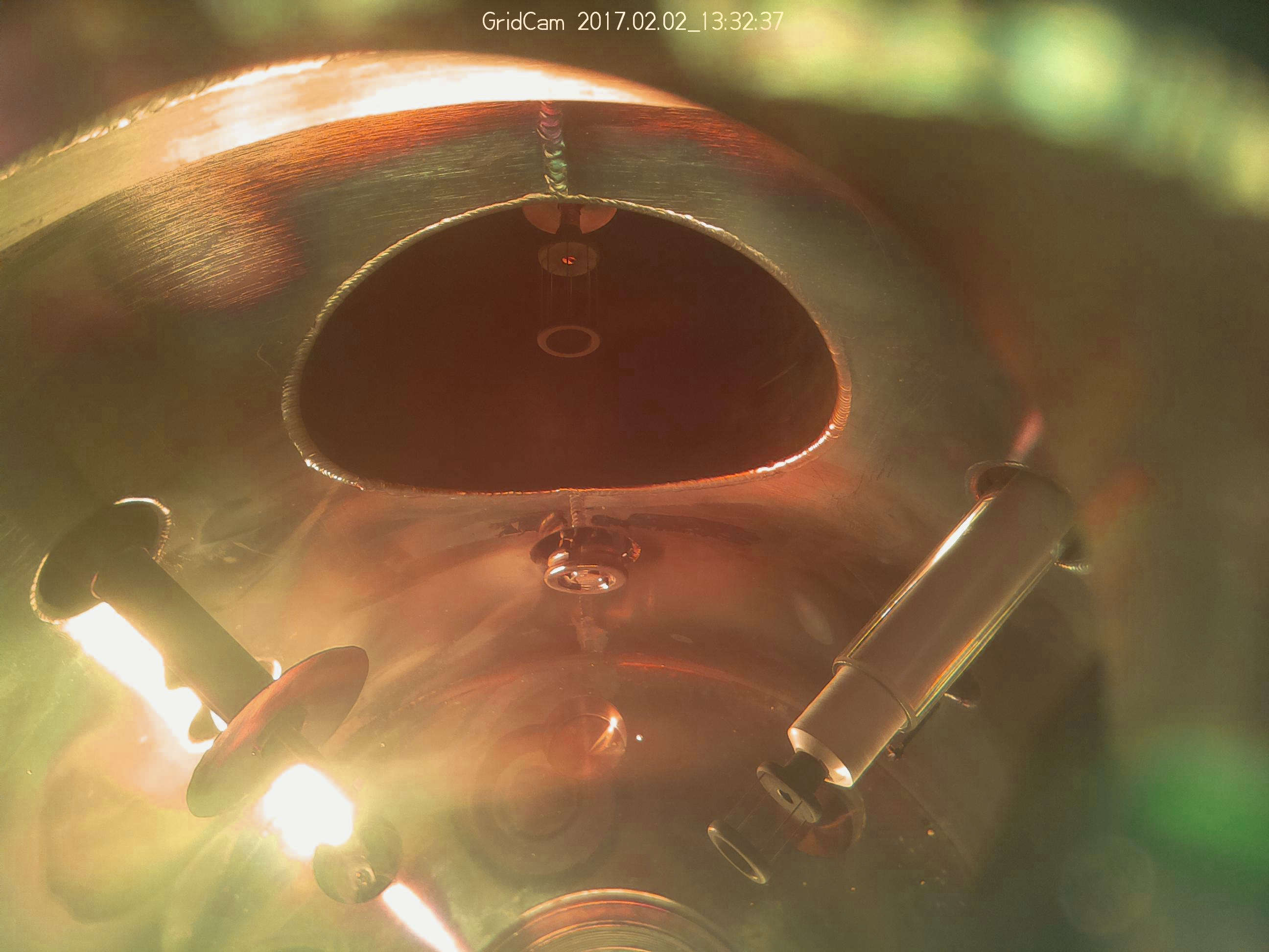

Postby Doug Coulter » Thu Feb 02, 2017 3:20 pm
Installed! Looking good. More pix and post mortem of the old one in a link.
Yes, I've already run a discharge on this and the pressure's coming down nicely.
Slipped right in through the side door.
