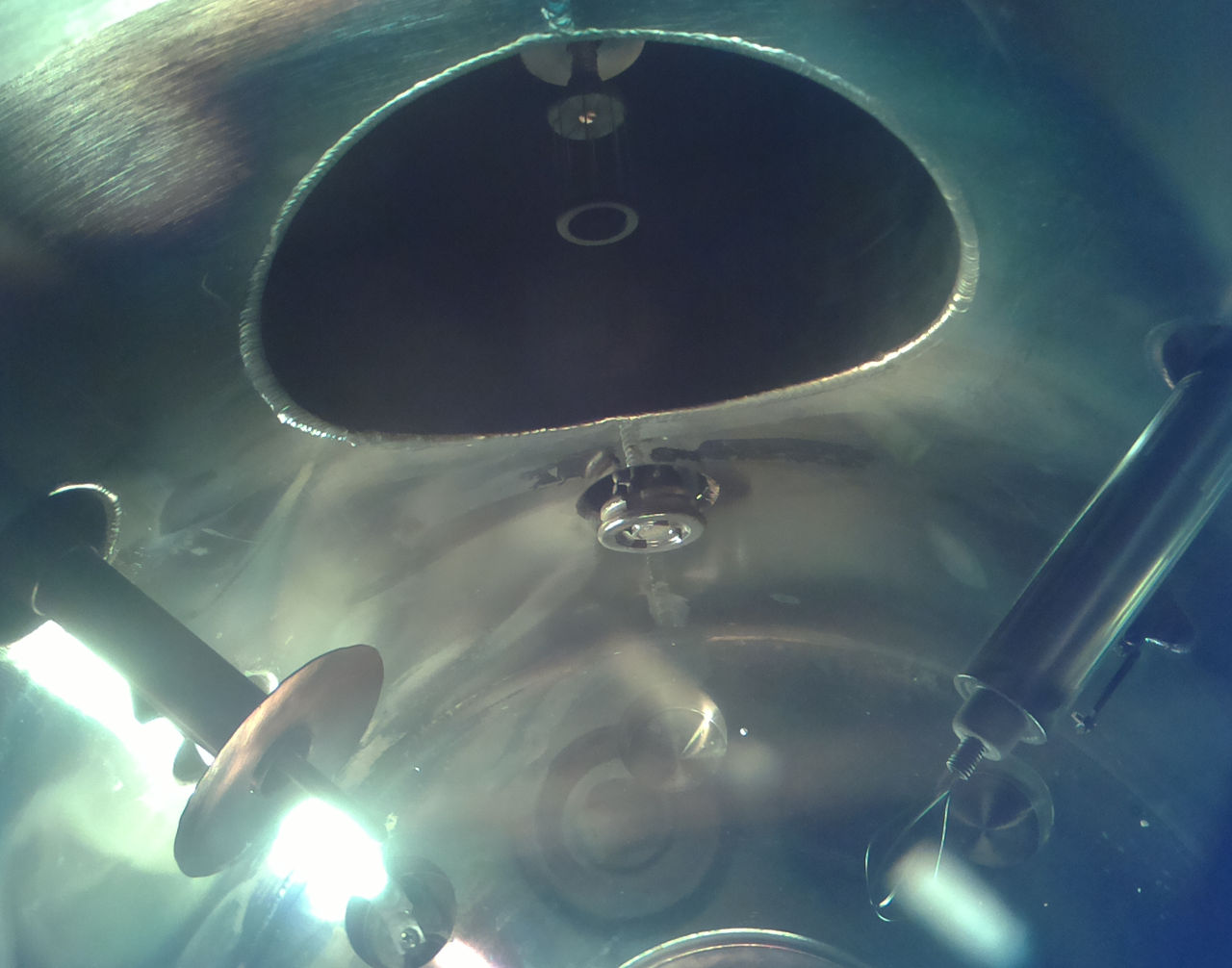

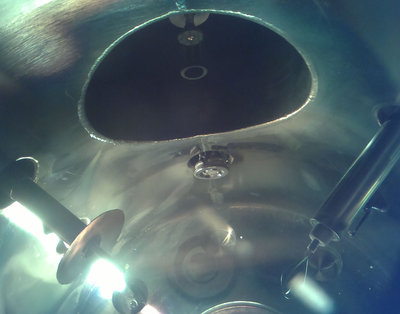

Sadly, the protective front SS screen and my dumb camera's autofocus prevented me from getting a "full frontal" on the feedtrough, but I was able to get a picture from above using the raspi project. It sadly does not show the end of the glass, which doesn't get in there as far as the BN does, which actually is why this works...but you can get an idea of the overall scale of things from this. The main grid is in that sidearm which is 5.9" ID.
Fusor innards from above
At the lower left we see the end of a 2.4 ghz ground plane antenna which we thought might be interesting. Fail, but it makes a good faraday probel In the lower right is the end of the ion-source grid, basically another fusor type grid, but without the accuracy, and much smaller (to match the power I have for that). That one runs at fairly low voltage, and so far, the dual layer hand-blown quartz over anodized aluminum is holding up. Since it's in a much larger space, it only takes 5-10kv to "light off" when even 50kv won't do the same for the main grid in its smaller confines (Paschen's law). This gives us a plasma "tube" (or you could model it as a high threshold super high voltage high power gain enhancement mode p mosfet) that has a lot of gain and some interesting possibilities, though initially we just used this to be able to run lower gas pressures so as to reduce scattering pre-focus and increase the net Q of the fusor. Turns out there's more you can do, but I'm not ready to report much on that yet - it was enough of an increase that I have to go to remote control to run in that mode...and I'm doing the boring work to remote it over this winter.
At least you can see the end of the fat BN rod I bored as the main insulator here. Funny how after years of trying things that "should work" the "overnight sensation" came via a rather boring experiment (pun intended) ;) .
