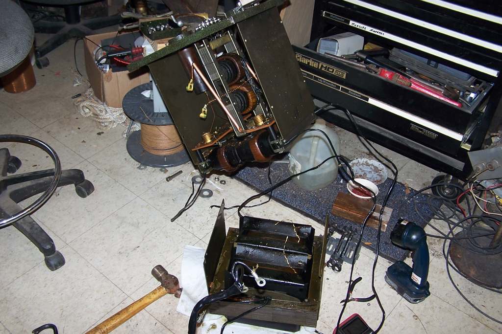

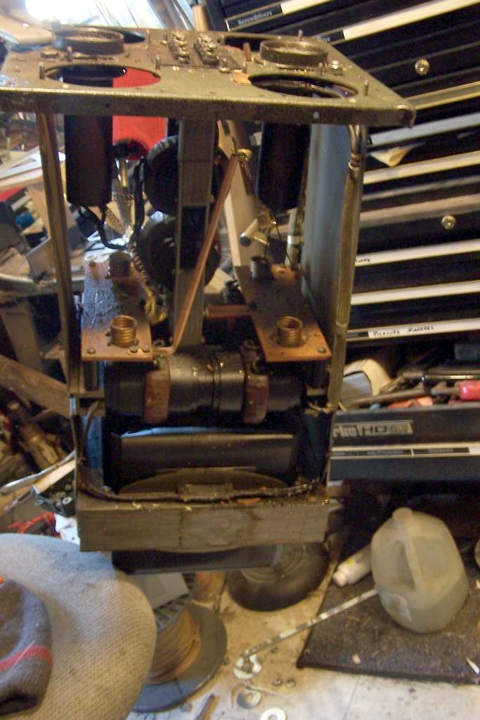

I'm taking apart a very old X ray power supply (WWII?) that BillF found us. This had been hit so hard with forklifts and so on, the case was so dented it just wouldn't come apart. Heck, that just doesn't happen on my watch...Time to get brutal. After screw-jacking the case off as far as we could, trying to drill out and pull the dents - not enough...time to get real.
http://youtu.be/-gdPzZRNaFA

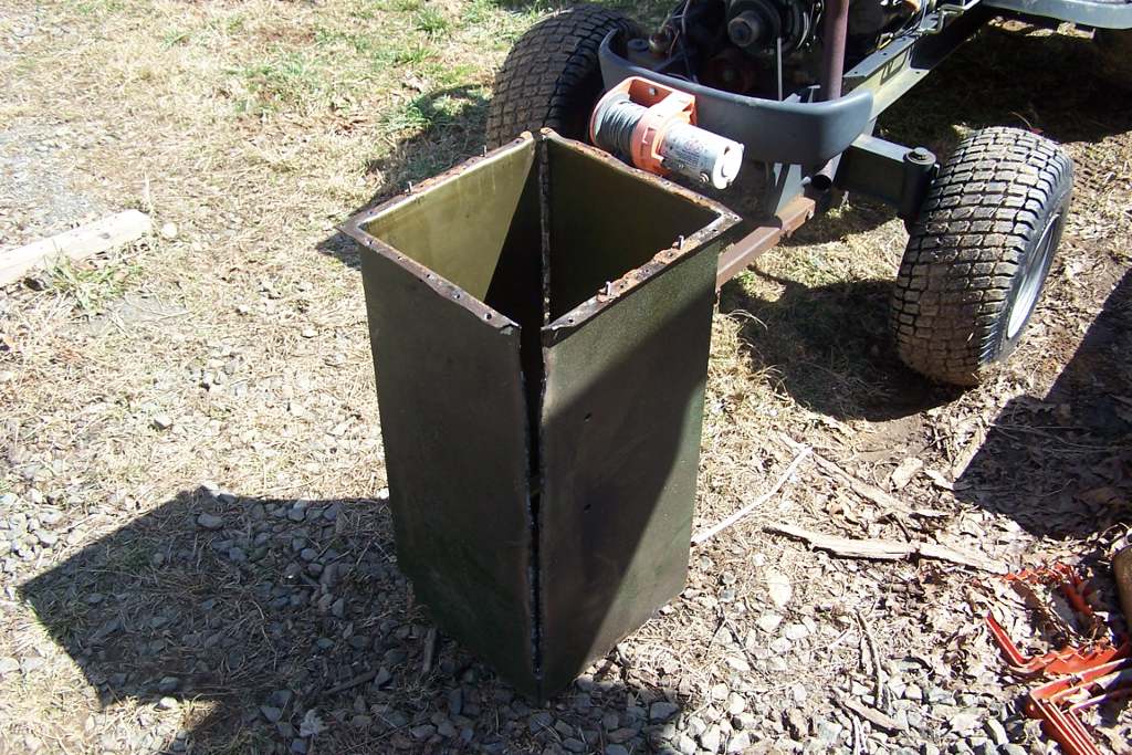

It took grinding off two edges to spring this thing far enough to make the innards come out. Whew, that was a lot of sparks and stink, but I didn't hurt anything other than the outer box doing it. If I was crazier, I'd fix the dents and weld it back up, but I'm not - I'll find something else to put the supply and oil into. And so - we now have the innards. One of the edison base tubes was internally broken - but I don't plan to use any of them. Anyone need big old tube HV rectifiers? 3 are good. We're not going to need all those filament transformers etc, so apart it comes. I'm just going to use the transformers, and some diodes I bought from JerryB (another member here). Sadly, I can't get full volts - the transformer is two windings, in series, but the CT has to be near ground...there's not enough insulation to series them up. Still...we'll see what we can get out of this. Maybe I'll make some nice real HV caps and a voltage doubler. This time I won't be so dumb as to try real volts/power on this before getting it back under real, fresh, oil. The stuff in there - yuck, rancid and high sulfur. Sickening smell. More when I make some progress...

Got some testing done today. Looks like these were meant for 240v input. All the transformers seem good, and the big boy has a 169::1 turns ratio between the primary and either secondary. With a one stage full wave doubler (4 diodes, 3 caps), I calculate 57kv for 120v input, or 114 for 240. Zowie! #8 wire for the primary makes me think those tube ratings of 125kv and 300 ma are real...I ordered 3 100kv .06uf maxwell caps off ebay - it's too darn many joules (and much higher quality than needed), but it's what I could find. Now in the hunt for some really horsey 125kv or so diodes. This is going to be a real monster. As luck would have it, we have cables and receptacles that match that will let it all be under oil with a cable sticking out, so that end, no problems. Obviously we will have to put some ballast R right there in the tank to avoid arcs with all those joules, we don't want flying molten metal in the lab.

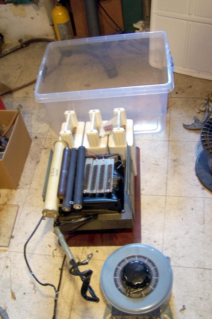

Got some cool new parts today. Looks like I'll be giving some real positive feedback to ebay sellers on these. Imagine - maxwell caps, .06 at 100kv, 6nh series L - $75 each.
I paid a bit more for the variac (20 amps, 240v) - about $300, which is about 1/3 of what everyone else wanted - and this one is for all intents, new and perfect. I plan to use the two 50k 200w resistors as a ballast - under the oil. The big 30k will be in series with the transformer CT to help protect the diodes should the main ballast not be enough - I just don't need all this thing can possibly give. Diodes rated at 110ma continuous, 10a peak, 150kv or so. Transformer, who knows, but calculates out to 117kv out of a full wave doubler...and the input wires are #6...zowie! I expect the variac to be the "weak link" if there is one, since my inverter for this will happily put out 4kw continuous (doesn't even make the fan run) or about 10 times that for 10-20 minutes...
Since the pic was so shabby (should have used a tripod), I thought I'd try a movie off my new Nexus 10 tablet...Not that it's a ton better, but at least the motion gives more angles. It's not as high rez as my "real" vidcam, but then there's this tradeoff - the real vidcam takes over 150 mb/minute to upload...this one has lower rez and is already in the right format for youtube. http://youtu.be/1kxlb365yNw
Looks like a real challenge to fit this into the box I selected at Lowes with decent spacing for the volts involved, even under oil. The upside is that if I can make it fit - I won't need much oil at all to fill in the empty space, since there won't be much of that at all. Most of the tricky stuff will go elsewhere in a main control box that will be remote from the supply - the supply will be placed right next to the HV input for the fusor, of course, and I don't like to be back there when its running - I like to be in front and behind the lead shielding. Which I'll have to add a lot more of at 100kv - it was already marginal at 50kv. I may even have to plug up the deliberate leak I left in the back to measure things, since there is a lot of scattering of X rays off the air, the ceiling and so on as is. It's only going to be worse at higher energies I suppose, though there is a chance that what I measure in front includes things like 2.2 mev X rays from neutron capture in all the moderators around and things like that - and I simply don't have the tons of lead required to stop all those. Luckily, this is getting to be mundane enough to consider operating it remotely with some automation, so I can put it someplace I'm far away from during a run!
The reason behind all this is what I saw in the parametric sweep plots I took earlier. It looked like a sweet spot for Q was developing from about 40kv on up, increasing in current (and Q, and output) as the volts went up in very good agreement with the rules for space charge limits on focus I've never been able to convince the people at fusor.net are real and well worked out long ago for electrons - a couple constants have to change for the different e/m ratio is all...nice to have the theory agree with what I measure!

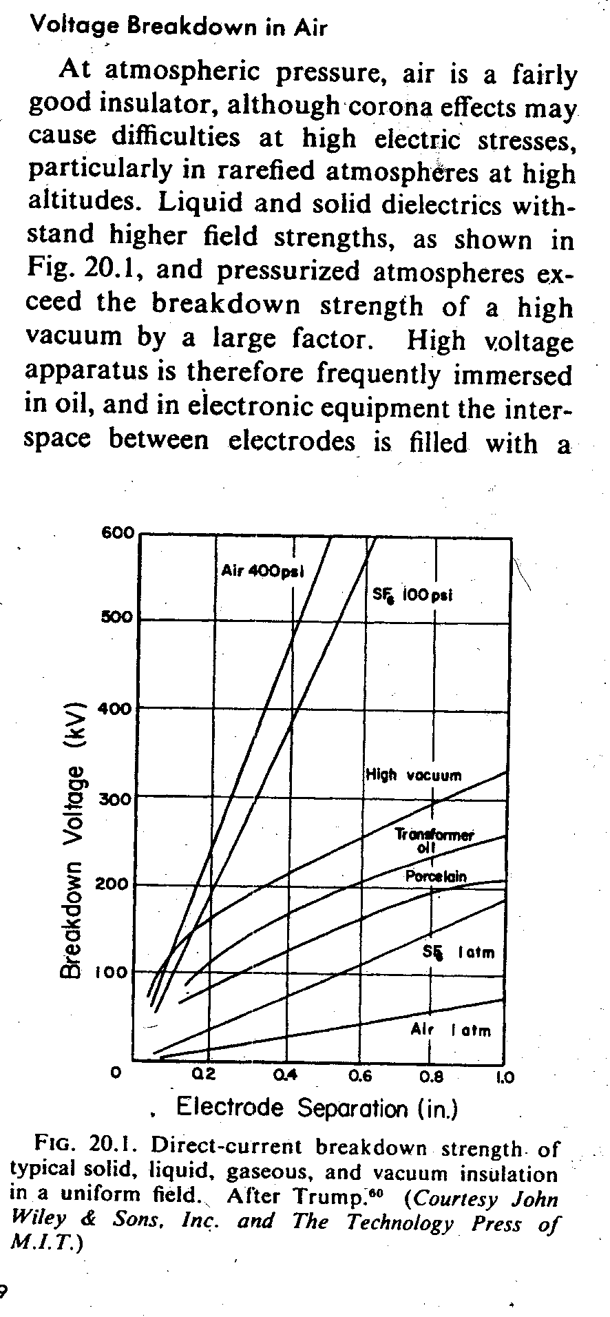

Sure hope this is right (or close) for the mineral oil I intend to use as "transformer oil". Else I'm going to have problems.

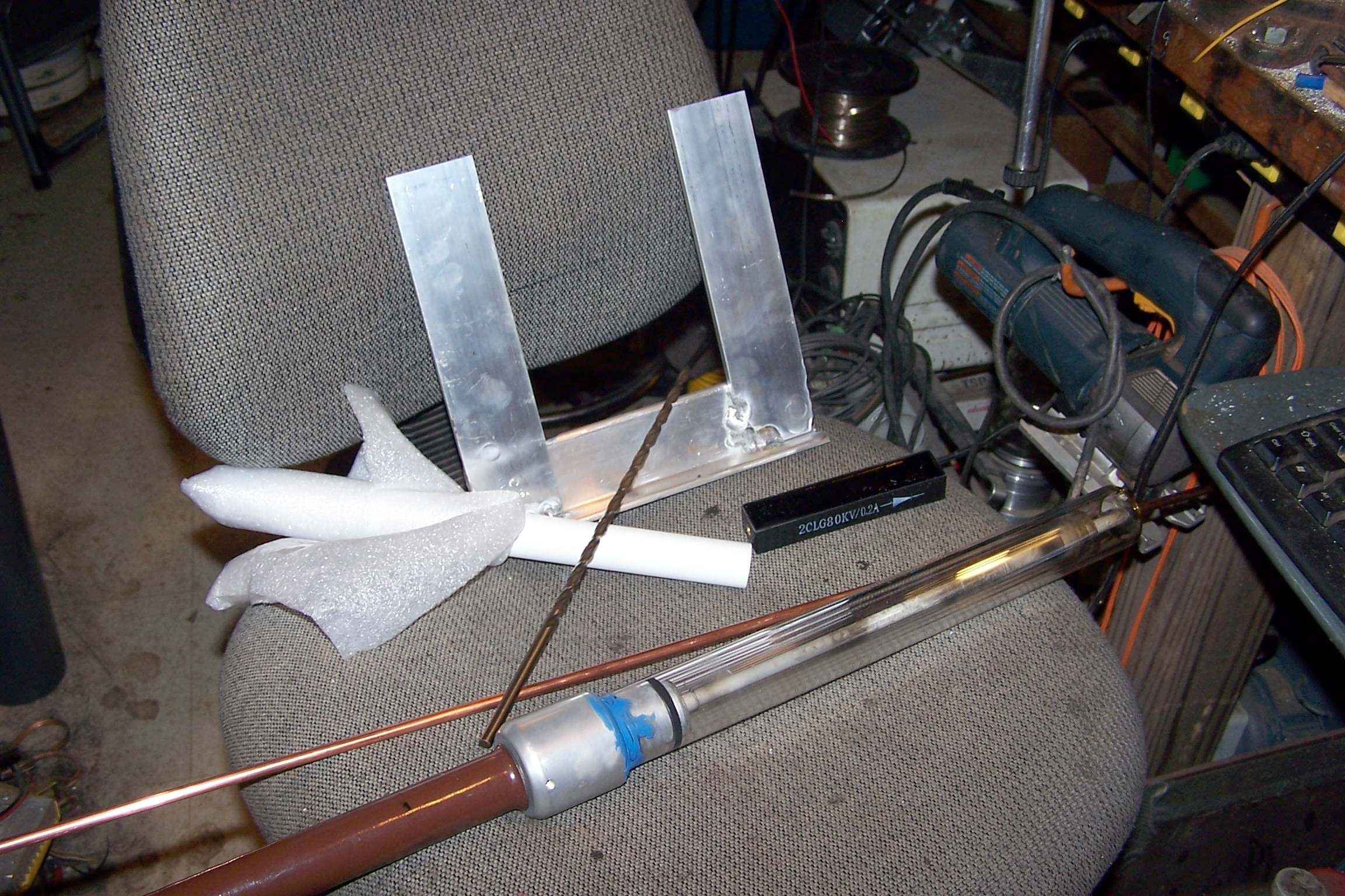

Every time I order from McMaster, they amaze me. While this stuff wasn't super cheap, it's the right stuff. Boron nitride rod to replace the rapidly degrading quartz in my new hv feed-through, a drill to bore it (special, long, self centering), OFHC copper rod to push through the middle - ordered last night, here at lunch. Gheez.
I also got some bigger rectifiers from a Chinese outfit that actually ships on time at decent prices. When I find the link, I'll update our vendors list - these guys are great, and it's all the HV stuff you can't find and dream of scoring. I just got 10 of those 80kv/.2amp guys, am getting a gig's worth of 200m 5W resistors from the same place, and yes, they sell all sizes and ratings of capacitors, diodes, and resistors for HV. Pretty neat.
But here's the pic - might have been eye-candy for some, it was for me. It doesn't pay to look too closely to my Tig welds on the brackets I built to hold that huge transformer off it's windings in the tub - but they're all in compression and almost not needed at all. Good enough.

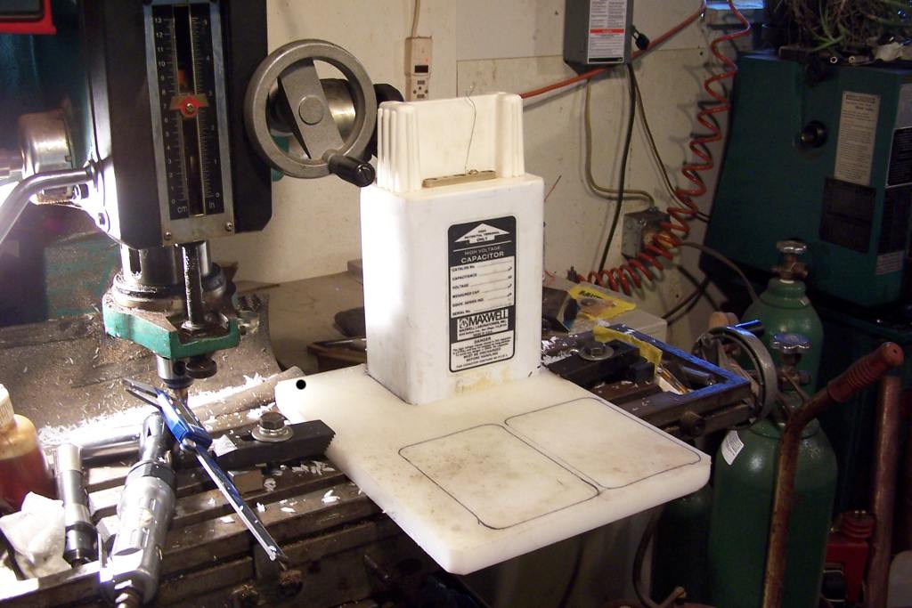

EEEEK! How do I mount these Maxwell caps, which only have one terminal insulated from the world at full rating? After all, in a doubler, both sides are "hot" in varying degrees. I was concerned for a couple reasons. One is the thing tilts when being hoisted, and if just wires were holding them, they might fall off as the oil drains off.
Also, since I'm using an old oil-soaked board (saved out of another HV supply we scrounged) for the base - what if it arcs across the board itself (through the plastic walls of the caps, ruining both)? Gee, it's not like they provide for mounting these by anything other than the terminals (bad move IMO). Soooo...here's my solution - mill out little pockets in some HDPE, and glue the suckers down with oil-proof silicone gasket maker (not caulk - this stuff is special and expensive at the auto parts store). I can then bolt the HDPE down to the board - and use the bolt for a ground point. Since this whole mess sits on top of another piece of HDPE in the bottom of an outer tub, it should be fine. There will be copper mesh screen between the tubs, grounded, to keep me safe - and if an arc blows a hole through the first tub...I still will have the outer one to contain a spill. The amount of energy .06 uf will store - one at 100kv, the other two at 50, is no joke - I'm betting it'll pay to have been this careful. Of course, the ballast R should keep peak currents to the outside world down, but - there's always a but - what if it arcs across itself, and shorts - then I've got nearly a thousand joules that are going somewhere very quick - these caps have only 20 nh of series L and next to zero series R. Better safe than sorry.
