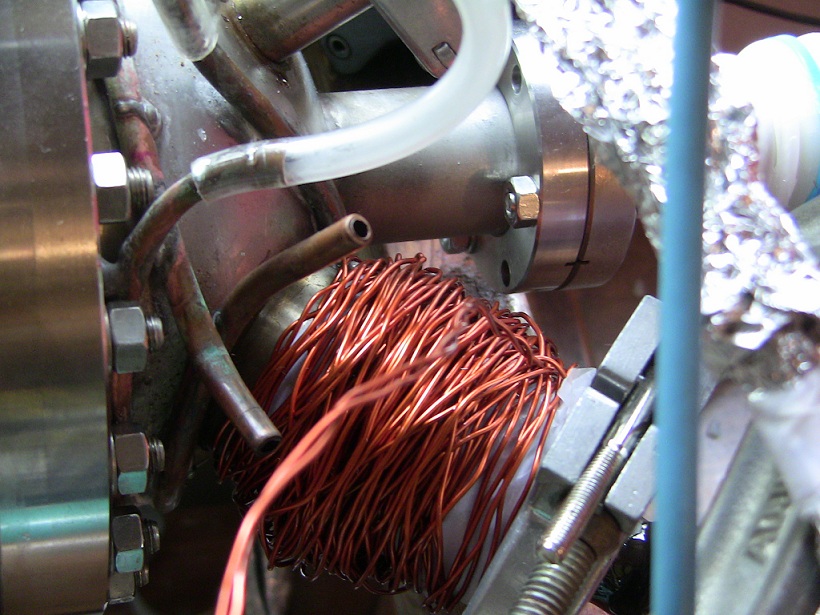

I've been working on a new ion gun design which seems to be working quite well, however it has led me to discover something very interesting that's going on, and I'm wondering why it's doing it.
The ion gun design is a KF50 flange with about 150 turns of magnet wire around the tube. At the time of this incident, it had about 6 amps through it, so the field at the center was somewhere around 200 gauss (very much an estimate since the exact winding count is unknown and there was no active current meter on the DC supply at the time, but after previous probing and knowing the variac setting, it was about this amperage). Then there is a little mini-grid inside the flange attached to a feedthrough. This then connects to a rectified NST. So, basically a pretty simple DC magnetron using an electromagnet to vary the field.

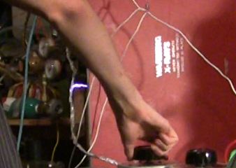

So, what is the incident? The first observation during operation around 10 microns D2 is that there is crackling noise coming from the chamber right when plasma forms at about a kilovolt positive polarity on the feedthrough. This makes massive RF noise, enough to throw my neutron counter to ridiculous counts and even turned my computer off on two accounts. Interestingly, this interference and crackling noise entirely stop as the NST variac continues to be turned up, then as the current/voltage diminsh coming back down it again starts up until the variac is turned to zero. But the incredible thing occurred when the wire providing the feedthrough voltage arced 1.4 inches to a ground sleeve. This thing was being fed by a center tapped 12kV NST with the variac at 25V, so no more than about 1.5kVDC there. I can't figure out what's going on, there seems to be some sort of charge establishing past the rectifier, but it just doesn't make sense to me. This kind of an arc would take 20kV+, not even remotely close to the arc ability of 1.5kV.

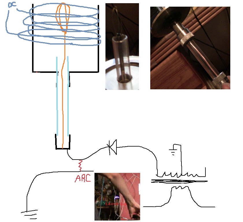

So the question is, why is there a massive charge building up here? My only thought is that charge is being pulled into the grid similar to how a van de graff picks up charge without giving it back out the source, but since it's all electrically connected here I'm not seeing how that's possible.
I've attached some images of this, the first being the electromagnet, second showing the arc, and the third showing a diagram of the wiring and coil.

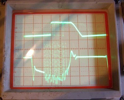

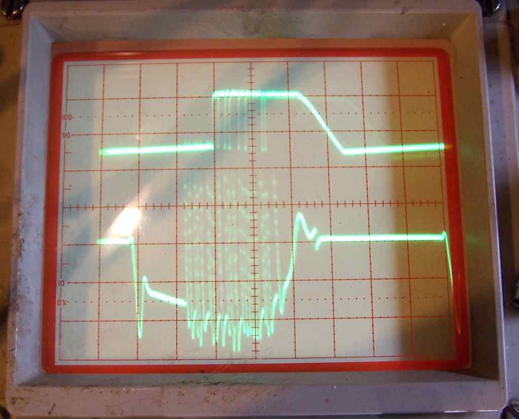

This video shows what I was doing at the time, not the same as you, but a similar thing going on.
Scope trace - neutron counter upper trace, voltage on secondary grid, lower trace. Lower trace 10kv/div.
Here, the upper trace is the output of the 3He tube (after some pulse stretching, a transformer, and an audio amplifier, that's why the weird jump up after the first negative pulse,
which is energy stored in the isolation transformer and the audio preamp clipping -- for what I'm doing, I don't care about that).
The lower trace is the realtime volts on the FT using a frequency compensated high voltage probe. Zero volts is one major div below the middle. There are several important things
to notice here, I think. This is chopped traces triggered off the 60 Hz line, so within the camera exposure time -- they are concurrent. Two things that are making
me really scratch my head here. One is that you can see that when the phase is such that we are trying to drive the secondary grid positive, it takes awhile for
it to start "rectifying" and clamp the volts back to ground -- eons in electron transit times. Why? Second -- why does it take so long after getting to negative volts for those
pulses to begin? Eons again, and so is the repetition rate, slow considering the equations of motion I think are applicable. And why do they go positive of ground?

Note, you'd not necessarily see this if I ran my 3He tube normally. I have a very high threshold set so I only see a pulse if it gets hit by multiple neutrons inside on tube response time -- more than one per 10-30 us in other words. I do this as I'm interested in bursting, and because otherwise it always sounds about the same on the audio amp you can hear in the movie it counts
so fast.
My pulse widths have sub microsecond rise times, and about 10 us fall times, but only occur at sub kHz speeds.
It's like it takes a long time to "make up it's mind", then avalanches, and does this a little *after* you get to negative volts on the thing, after having sucked out the electrons
and made the plasma net positive (we normally measure net negative with a faraday probe in usual DC fusor operation). I'm getting about 5-8 pulses per
60 Hz half cycle doing that, at least until it fries the NST.

Having said all this, there is a potentially simpler explanation for what you saw. There is so much inductance at the output of an NST that you might just be having
plain old kickback if the discharge is unstable. In a car spark coil, a 12v input on the primary can kick back to 600 volts when the points "open" -- and an NST is
a much better inductor. So you'd have to put a scope probe nearby (not too close!) and look and see I'd think to be sure of what's going on there. One way to test that
might be to add a fairly substantial filter cap, then a series R to the ion source and see if it still happens at any point in the circuit.
While you can't count on any particular frequency or time response other than it will be differentiated, a 10x scope probe a safe distance away (say 6" or a little more) will see a lot of this and might give you a clue. The signals from this will be a lot louder than the usual room hum/local radio station pickup. Try it as a poor man's probe for things like this.
