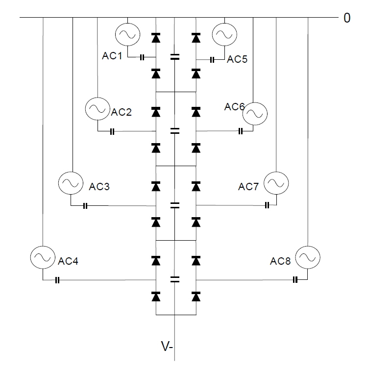

I am building an HV supply consisting of several stages with buck-boost CCFL converters.
I'll be posting this in detail quite soon so you can see progress - but first I need to order the HV components (from China/ebay)!!!
What I am building looks like this, with 10 stage;
Two issues I am facing, for safety and circuit protection;
1) Each stage mustn't exceed 3kV else the total chain will exceed the values of the coupling capacitors, yet could reach 5kV when unloaded. I can simply add a resistive drain on it to rein back the voltage, but are there any straightforward less lossy ways to limit each stage to 3kV? - e.g. is there such a thing as a 3kV Zener diodes or transorbs!?! Or would regular diodes work?
2) The stages are each fed separately but capacitively isolated from one power inlet. The risk is that if a capacitor fails in the chain then it could dump the stage voltage to the power inlet. What are the best means to couple the power inlets together such that if they diverge by more than a hundred volts or so (an HV transient short trying to get out) then it'll be shorted within the HV supply? e.g. are regular transorbs quick enough to stop an HV spike getting on to external lines, should I be thinking about using some form of spark gap, or are there recommended TVS components in the face of potential multi kV pulses? Or all three together - or more!?

Before getting into the other fine engineering details, I'd like to ask "why do it this way"? Is is just to break up the big AC supply into lots of little ones which are presumably easier to make?
(that assumption may or may not be a true one)
This does need more in the way of AC coupling caps (in terms of volt ratings) than a standard CW multiplier where you don't need increased voltage standoff for each stage. I'd guess if you made them all big (in capacity) you'd have a stiffer supply, but I've not noticed any big problems with that in CW multipliers run at decently high frequencies, and with HF, the need for stored energy in any cap or combination of them is less -- so the thing becomes less intrinsically dangerous to itself and the load. I'm not saying your idea is bad, just that I don't see the advantage of it so far -- seems like more work and more parts to get the same job done. It can be hard to make "more parts" more reliable then "less parts", but as usual "it depends". I know the big inverters that power my house are very reliable, and that they use a lot of little fets rather than a few large ones...but from looking at how they did it, that was a lot of work to tweak into working right.
I'd suppose you could optoisolate (though you might need a fiber to get the standoff volts) to regulate each supply based on the output of that stage. I'm just not yet understanding why this topology is one you favor. No one else seems to be using it at this point, though back in the day, there were a lot of floating batteries used in stacks, or various strange chainings of transformers.
In another approach, a single spinning shaft (ala the thing JohnF made recently) could power any number of isolated little generators, which output could be used directly or stepped up simply, and get rid of the need for the AC coupling caps and give improved robustness (other than mechanical).
I'm right now looking for fibers and transceivers myself for opto isolating things that will have to float way up high in my beam device. I'm hoping to find something cheap and standard, like what is used for digital audio -- I don't need that much bandwidth, but I want cheap and reliable for certain. And if a gel cell sitting up there turns out to be not enough power, I will definately build a smaller version of that mechanical energy transfer thing JohnF made, but probably with smaller servo motor as a drive and one or more small steppers as the generator(s) -- both are amazingly efficient and I won't need kw of power anyway for ion sources and focus supplies. You don't have to spin a 24v stepper very fast at all to get a couple hundred volts output, and it's nicely split phase so easy to rectify and filter with small parts. It will certainly be photogenic if I build that!
It has only proved difficult, but not that hard or expensive to find decent main HV transformers here -- or make them, so I guess I'm coming from a somewhat different direction. Is that what you are trying to eliminate the need for?

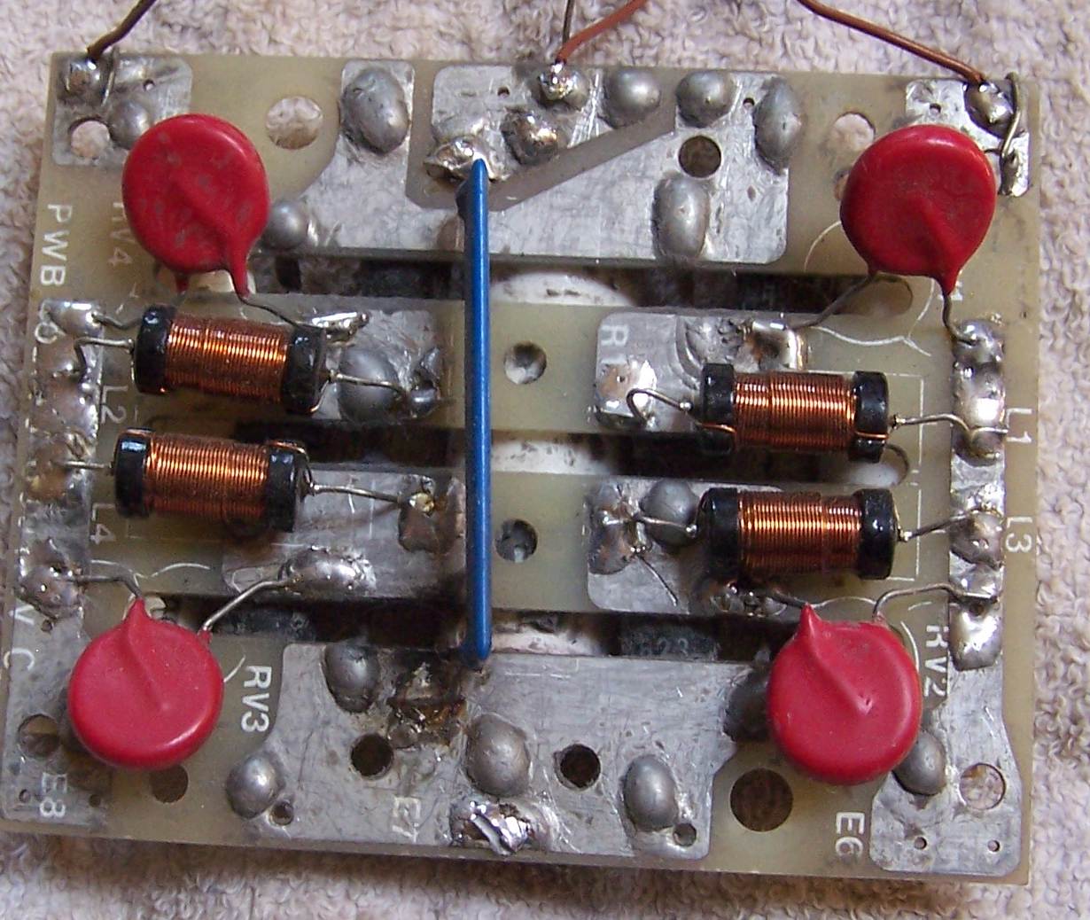

To get a little closer to your actual question -- here's how Spellman does things. We bought some parts from a fellow HV experimenter, and he'd de-potted a Spellman stack. These stages are rated 10kv each, but only usable to about 5-6 kv outside the potting.
Backside view
The blue thing is a resistor across the stage output. The inductors separately decouple two sets of rectifiers that are otherwise in parallel. The red things are surge absorbers, presumably standard units. Here's the other side of the board.
Frontside view

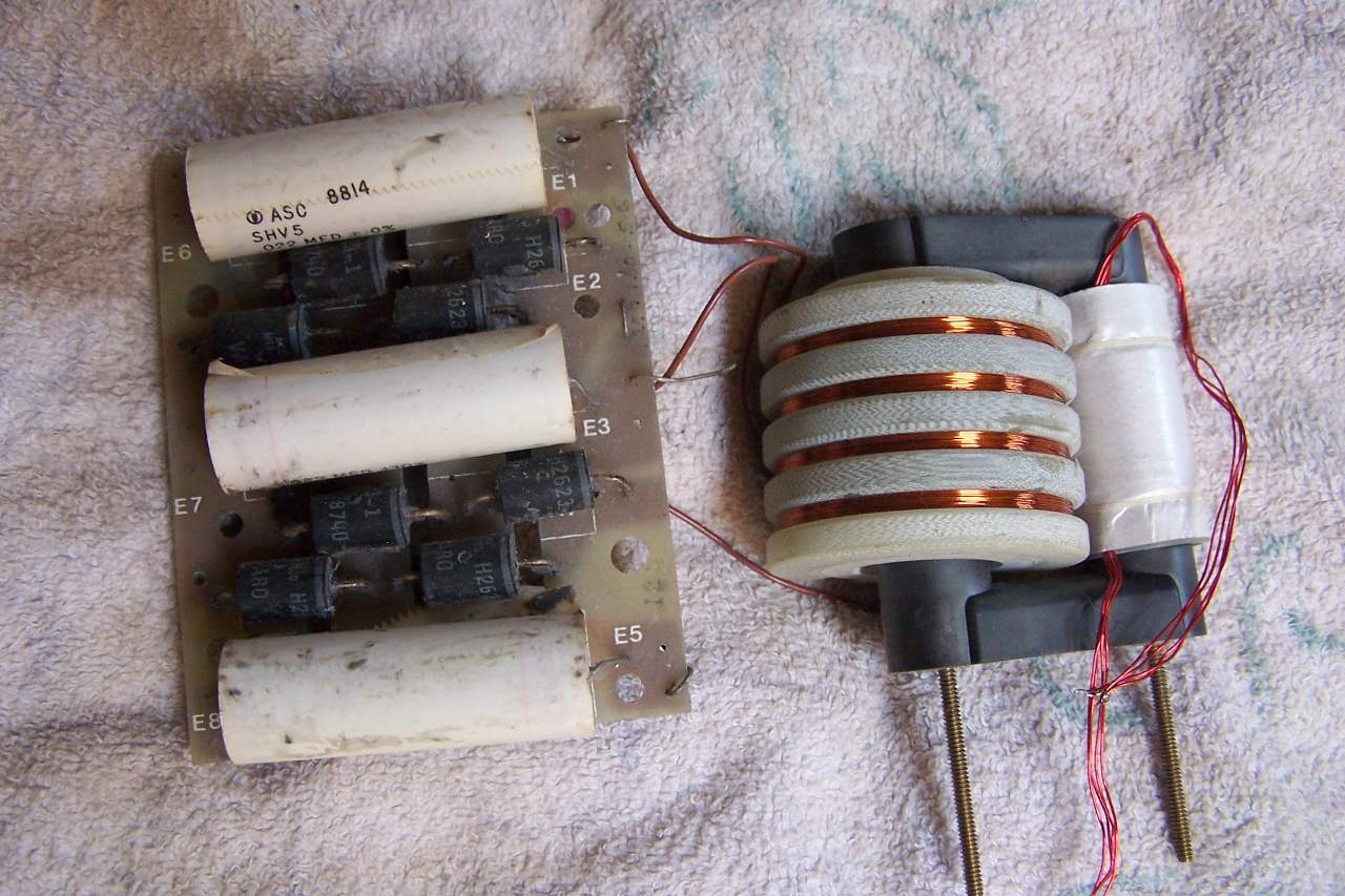

This one shows a homebrew transformer, good for roughly a kilowatt, and the caps and diodes. Note how large the diodes are...over-design for safety in impulse (arc) conditions. The caps are .022 at 10kv here, polypropylene types with good pulse characteristics.
Other parts of this supply (not currently easy to get to and not in this building) include protection from an arc across the output, which is more or less a series resistor made of a whole lot of 2w carbon resistors in series-parallel and also potted, as once this is built, the main risk to it all is an external arc. The fact that every stage uses the same value caps means that a quick discharge happens fairly equally across all stages, so eliminating the risk of seriously overvolting any one stage -- The diodes sill have to carry the peak current from the AC coupling caps in that case, but the series ballast limits that peak to the couple of amp range, well inside what these diodes can take. There is further a big resistor across the entire thing for voltage monitoring (also potted), with a floating ground end for sticking a little current measuring resistor into.

Ripple added at random might actually be worse, but more likely they'll phase lock if they are all oscillators. Else you could get some fairly horrible "beat notes" at low frequencies that are *harder* to get rid of. Though with the CCFL's I use, even small caps make ripple utterly nil -- hard to even measure at a millivolt/scope div.
Reversing is not going to be hard either way if you build it yourself. For the huge one I'm working on (stalled out because I didn't need it yet), all you need to swap polarity is a single extra pair of AC caps and to mechanically turn the whole thing upside down.
In my experience, the worst risk of things getting fried is diodes and that in an arc across the whole thing - big peak discharge currents can pass in even small caps if their quality is good -- you need a current limit/ballast for certain to keep peak currents down in that case, and to limit how much of that junk you need, you need to make sure other arcs just can't happen internally.
I do worry that for example your coupling cap on AC8 has to store a lot more energy to be the same uF and have a higher volt rating, which makes things have more stored energy and much higher chance of failure should the thing arc.
With a straight CW design -- you can hook the transformer and ground anyplace in the stack too, BTW -- and not only that, do the same thing with the transformer stuck on either end, if the transformer insulation will hack it. I've not yet managed to fry a transformer even in extreme abuse. The push pull nature of a full wave stack seems to protect them well, and the driver behind a lot better than you can do in a single eneded stack where the discharge currents don't cancel.
