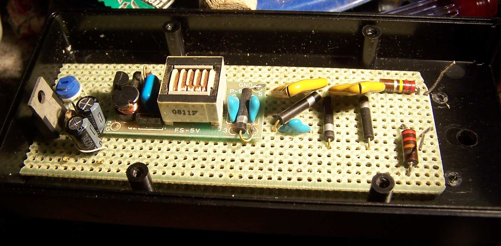

Innards of the HV low power supply
Almost doesn't deserve a picture, since it's so simple, but here's what it looks like on the inside. I put the trimpot on the other side of the board so I can tweak it through a hole in the front panel.

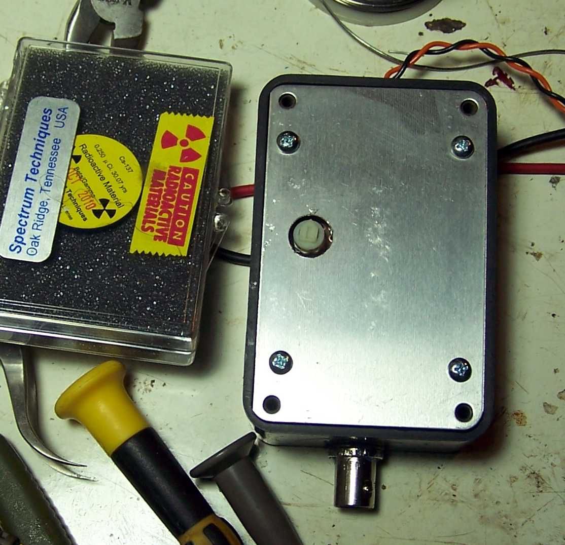

Outside of supply
Now, these guys radiate quite a lot of 50khz stuff, so I grounded the box panel and put a bit of copper tape in there to shunt that to ground to keep the air around it quiet.
And that's it. If I do any more of these, oh please let me lay out a PCB for it -- I've made maybe 5-8 of them so far for various things; the basic design goes to 3kv fine with parts value adjustments, so a similar one is also running our 3He tube which has most of the same issues with noise, or worse. The reason I haven't is I don't have a stock of standard little boxes to put them in, you really do need a box, and so I wind up customizing each one to fit in whatever box comes out of my junk-box-box.
This particular one draws almost 20ma under the design load. I could about cut that in half with tweaking the lm 317 resistor values, where most of the actual power is going!
It'll run on 6v or so on up to whatever the lm 317 can take, 40v or so.

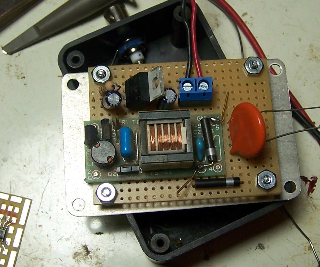

So, I'm rebuilding the preamp for the 3He tube, and decided I may as well re-do it's power supply too. I had been running it at 3kv, which is right at the limit of the original voltage doubled CCFL running on 14v...A little iffy, and I'm at the point where none of that is permissible anymore, I need this stuff totally rock-solid.
Therefore, I rebuilt the supply, fixing a couple of things along the way. For one, I went to a two stage CW multiplier to get more output volts for less input volts. Along the way I got rid of the .047uF caps I'd been using -- far too much stored energy in those, and replaced them with smaller .01uf caps -- still too much stored energy, but at least not as ridiculous. I'd used 1/8w isolation resistors in the previous version, which were easily exploded by the energy in a couple .047 uf caps, so this time I went with good old 1/2 watt carbon composition resistors for that, should be more reliable in a fault condition.
A bonus of going to the lower input voltage is that I also lost half the quiescent current -- down to 20ma from 40, and since I'm now running the input at around 6v, that means 1/4 the power. In this case, it doesn't matter -- all these run off one of those bench supplies used to fix CB radios and car audio back in the day, but less waste is generally a nice thing.
Since I'd put the previous model into a fairly large box to accommodate the big original caps, I had plenty room to do this up clean and sweet. Here's a pic of the thing in the box bottom, which will be again screwed to the side of the 3he moderator, away from the preamp. I've not hooked up the input and output wires yet.
Top view
I used a spare small cap for the 2nd AC side -- this may as well be a "no load" situation, so the 27 pf is plenty (and the price was right). I didn't really need the spark gap caps here, but they were short enough to fit in the box well after being bent over. Lots of room meant I could spread things out nicely for low corona issues. I will probably want to put some copper tape on the outside of the box and ground it to keep from radiating so much of the 50khz supply noise, but again -- with the supply at half voltage, the first 6 dB are free too.

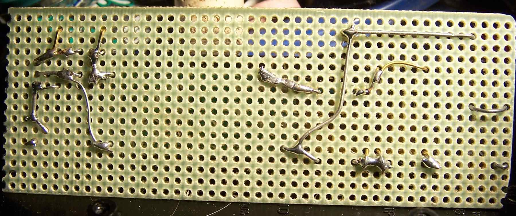

Here's the back.
Bottom view
The other change I made is to the pot value. This time I used 2k to get a wider range. A bit harder to adjust precisely, but less bother than calculating a pot + series R, and this makes the thing more generic should it be put to some other use later on. It is adjusted correctly in the top view picture -- right in the middle, cool.
BTW, in tests yesterday I found I had to take the PS voltage down from 2.95 kv to about 2350 V or so to be in the right gain range for the preamp as built. That will get a little mod and update itself, as it has an issue with the big digital signal it puts out getting coupled back into the input -- a little shield in there should fix that one and get rid of any double pulsing.
