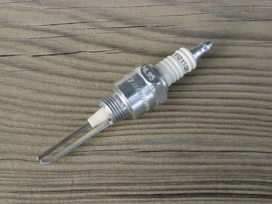

I found these at the local hardware store. They have a little longer longer reach than your average spark plug if you need it, but cost 2-3 times as much. This one is a Champion plug used in torpedo heaters.
Champion F121501

Joe, do you know if this one has a built in resistor or not? If not, that looks like the best seen so far -- worth the price of an odd tap if needed.
Re: Spark Plug feedthroughs 101
Postby Joe Jarski » Sun Dec 12, 2010 4:05 pm
Unless I am mistaken, the threads are a M14 X 1.25mm. The resistance is 2 Ohms which is higher than I expected, but I've never measured spark plug resistance before - still not a resistor plug at ~5k.

Excellent, so not even a weird tap. A few ohms might be ohmmeter error -- that is certainly not something you'd worry about much. Remember, if it's galvanized you'd want to remove that before vacuum use, it really makes a mess when it sputters in the tank -- weak HCl does that quick and easy. Why not pick up a few extra and bring them along when you visit, for trade?

Good idea! I just bought one because I wasn't absolutely sure that they weren't resistor plugs, but I will go back and get more now that I know.
