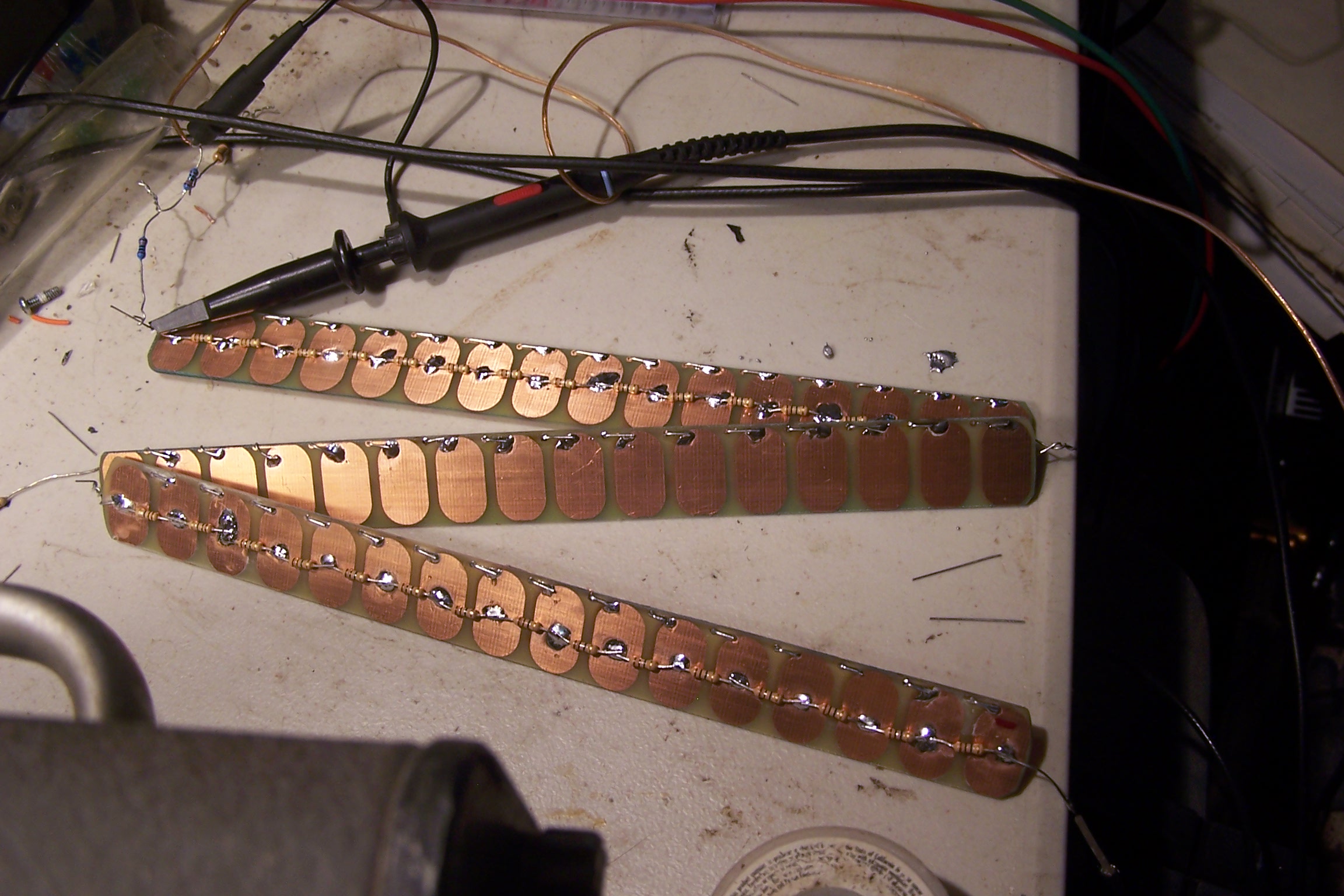

I built one (15 R's and C's) stage for testing. I got a couple weird results, but at anything higher than a few hundred kHz it looks great - Looks like my PCB capacitors are a little large in value - much more fringing and other parastics than I expected, but...with a 200k load (instead of one meg) the load capacity to make it flat at HF is between that of a 1x and a 10x scope probe (and don't believe their specs on that - this ain't Kansas (Tektronix) anymore, Dorothy. We're in the 10pf+ range at 10x...
Anyway, the artwork is in the postscript files attached if anyone wants it - I just print these on transparencies with my laser (using the same one flipped over to be cheap) and expose pre-sensitized board and go from there.
15 sections of eventual 45 probe test sample

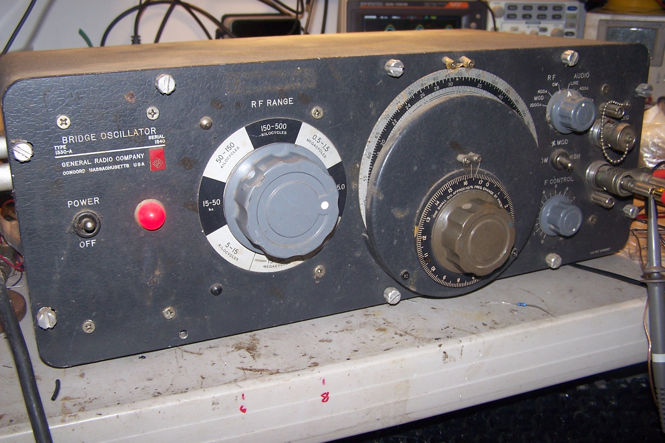

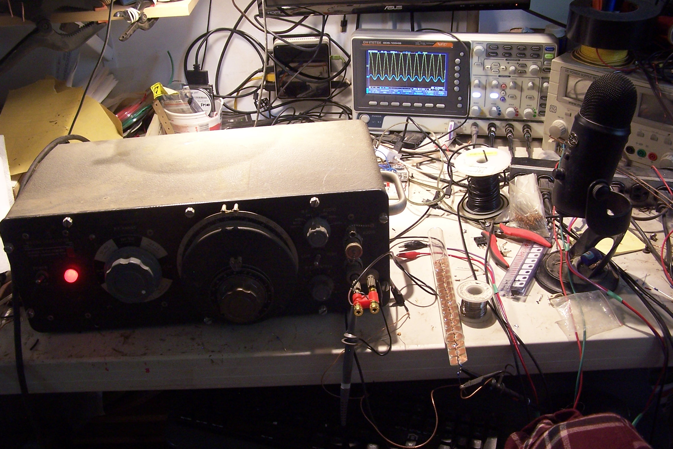

I pulled out some real vintage heavy hitter test gear to check this stuff:
GR FTW - but my hernia....
Messy bench. The probe section is to the right of the GR in quartz pipe.
The gain isn't perfectly flat...varies from a 760:1 to around 600:1 from 1 mhz to 10mhz (I can probably fix that). There is obviously some effect from nearby things with ground or other signals on them...I'm going to try to make this work inside some kind of shielding - all this is non trivial. But it looks pretty good so far.

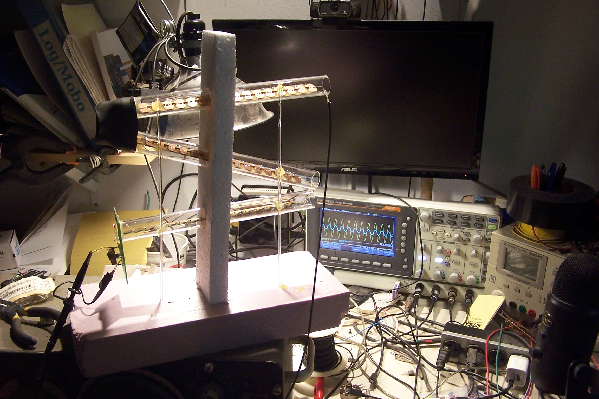

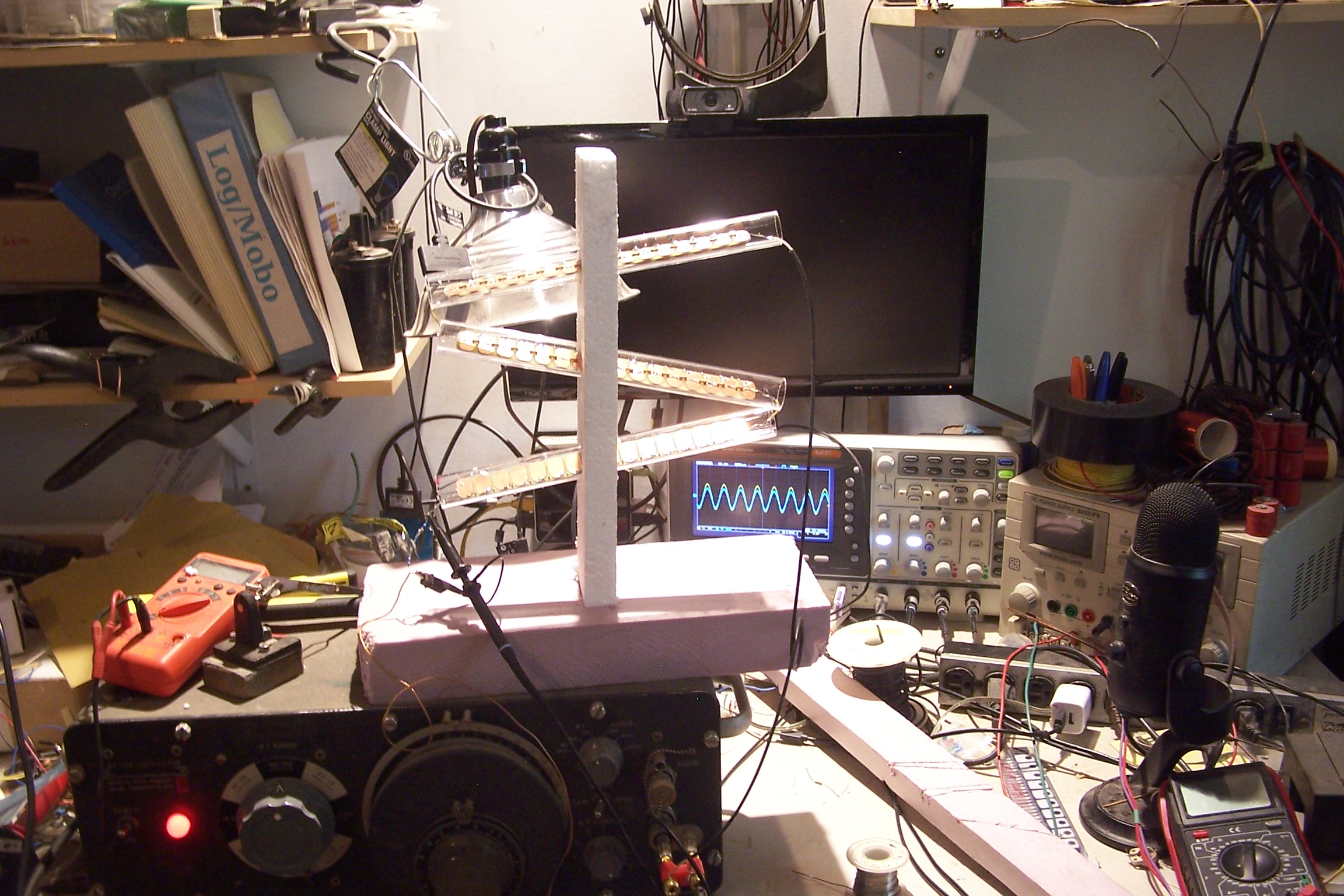

Here are all 3 built and being bench tested. I had some fairly bad fall off at HF (10-30 mhz) till I put them in the zig-zag config shown. That's going to be interesting to package and shield (at least the parts I _can_ shield). Picks up some 60 hz hum as is, to be expected when I "only" have 40v of test RF in, so I have to set the scope really sensitive. At least that's around 10x more signal than I'd get out of solid state gear.
Probe on bench. 45 x 10 meg + ~~ 2pf per resistor
Seems current scope probes have lots more capacity than the old Tek ones...but those old Tek ones cost around the same as a scope today in == value dollars, so not a big surprise. I had to go down to 200k load instead of a meg to get the RC ratio right. No big deal as I don't care that much what the ratio is as long as it's in a decently large range and I know the number.

Postby Bob Reite » Fri May 11, 2018 3:43 pm
Putting it in the zig-zag is giving additional capacitive coupling about 1/3 and 2/3 across the stack. Probably only 0.5 pF worth, but at the Z you are dealing with now.... No wonder you have all the issues with hand waving on your results.

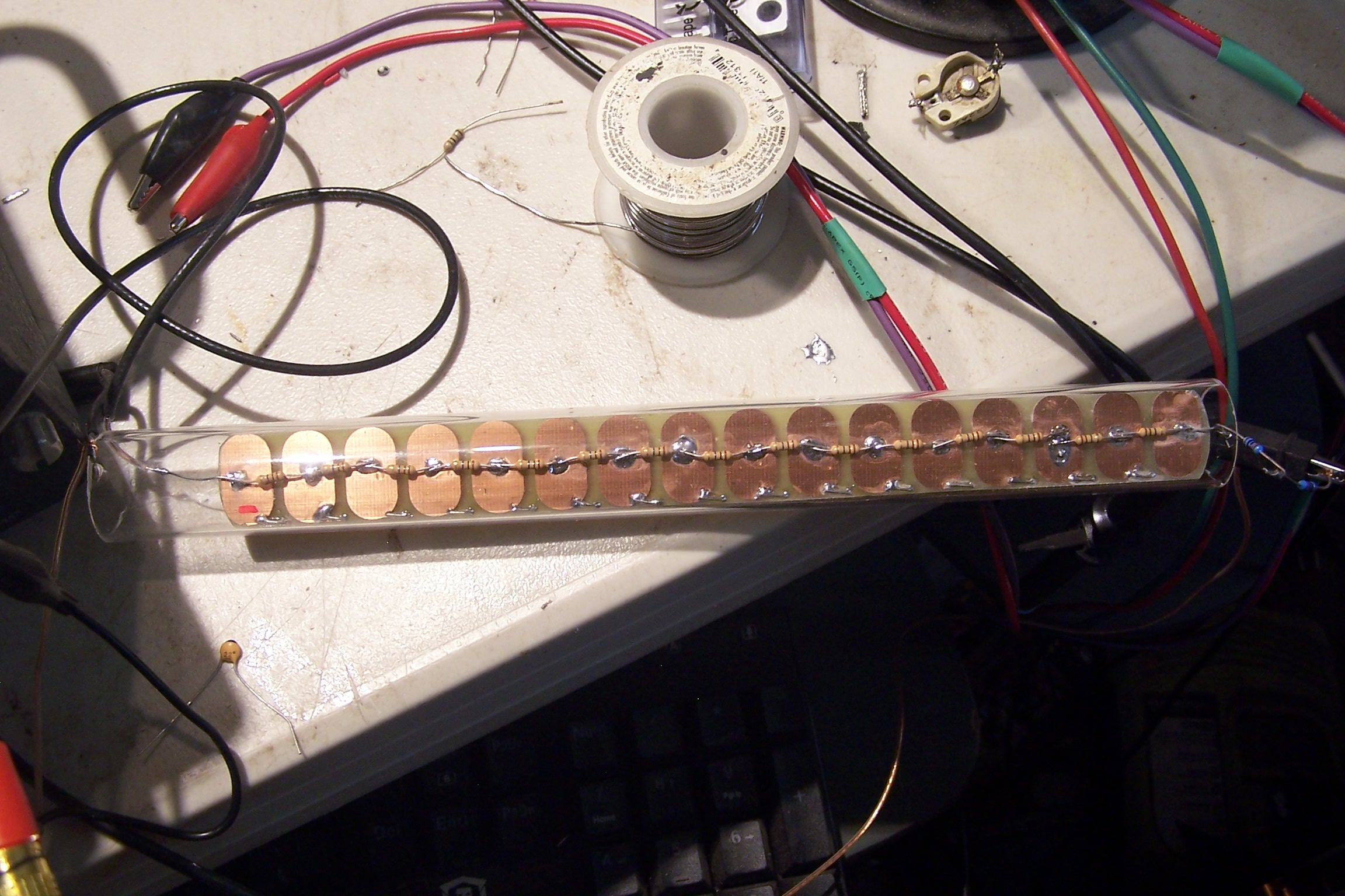

Looks like this now:
Mostly more rugged for a wimpy definition of stout. Adjustable R and C load on board at bottom.
You can maybe see what normal looks like on the scope. I have this set up for 400:1 on the dot for DC and it stays inside 10% error over most of DC-15 MHz or so.

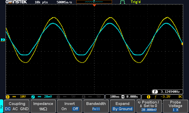

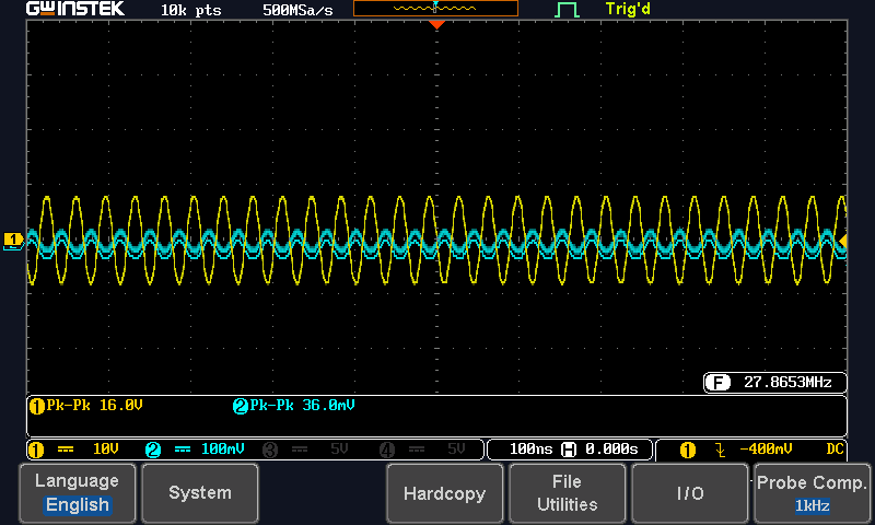

Above that, the phase reverses (What????, it's almost a purely capacitve volt divider, and FR4 is supposed to be really good, as is that NPO trimmer on the output).
Bad phase and divide ratio, note frequency here.

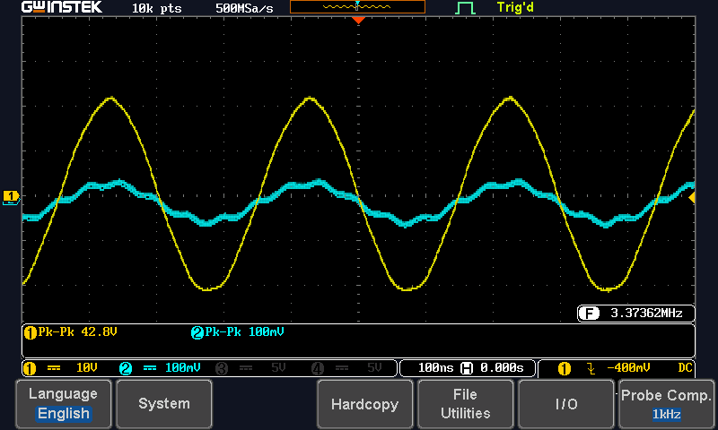

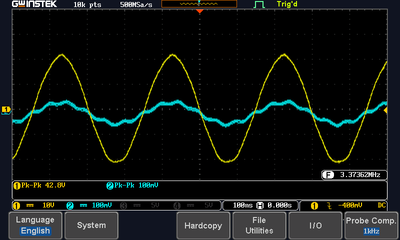

But what's baking my noodle is this one - and it's fairly narrowband around 3.37 something MHz. There's nothing deliberately nonlinear in sight, nothing I think would resonate at such a low F (it'd take long length and lots more C) and generally, what the heck?
Note harmonics and wrong divide ratio, only a couple hundred kHz wide with this visible at most here.

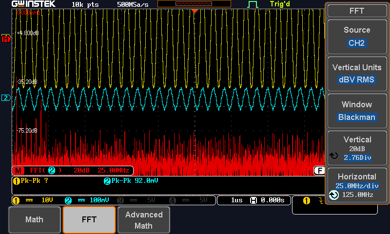

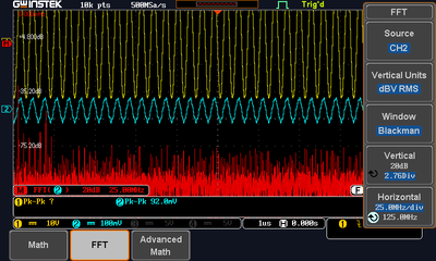

Here's an FFT if that helps anyone. Looks like 6th harmonic mostly. Other windows make it stand out more, but...this one is my fave.
FFT of nutty distortion
A bit disappointing. I can easily read through big slope-y errors, even ignore a skinny peak. But I want to see just such little wiggles when they are real.
Any thoughts?
