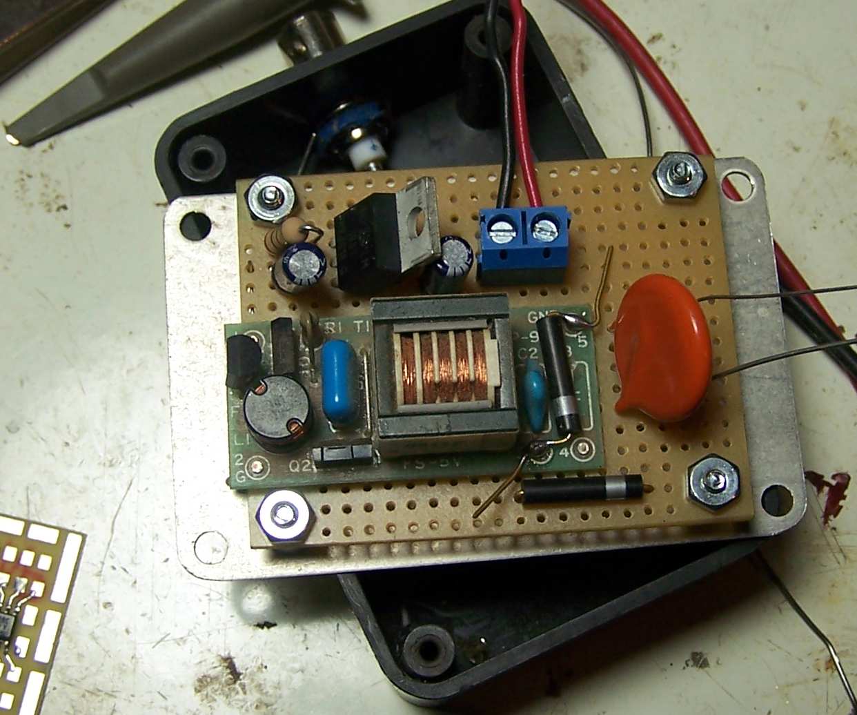

I am working on adding a B10 lined neutron detector tube to my lashup, and needed yet another power supply for it. For those not familiar with these, they are old as the hills (maybe older than I) but they work fairly well. Ours are GE made, around the end of WW II or so. Basically it's just a big proportional type tube but lined with B10 metal to make much more signal when hit with neutrons. In practice, these are sensitive enough for fusor use, and in fact, better than you need. But they have one caveat. The signal is tiny, and riding on the DC supply power, so you need to mind your P's and Q's when it comes to powering one (I'll document the preamp elsewhere and cross-link the posts).
This turns out to not be a hard task with a CCFL inverter, my favorite being DigiKey's 289-1025, which is 12v nominal in, and 1kv nominal out. Of all the CCFLs I've tested, this one has the best "manners", draws the least no load power, and is hardest to fry, as well as making a very stiff output voltage that is tightly related to the input voltage, so a full closed loop regulator is very rarely needed, and that only if you're going to draw real power out of one (they'll make12w if you're careful). The manufacturer is JKL and their internal part number is BXA-12529.
I've tried a ton of CCFL inverters, BTW, and this on is hands down the best -- hard to fry, most power out (it's designed to drive two lamps) and lowest quiescent current by a rather fat margin over say, the TDK brand ones I've tried. It appears designing an efficient Royer oscillator is a little past most of the manufacturers, they don't use the right core material. This part number will run reliably all the way down to .7 volt inputs, which is nice too. Something to watch for in new CCFL's is that many are now uP controlled and do dimming via PWM. Those are utterly useless for this, as they won't run on lower than spec voltages to make the output adjustable (unless you happen to have multi henry filter inductors laying around doing nothing). They also tend to be real power hogs. This is another case like getting the HV stuff meant for old CRT TV's before it's all gone -- as the world rushes to flat panel displays and LED lighting for those, all this stuff is disappearing off the market fast. So stock up now!
For this case, I needed 650v on the dot, positive, with sub millivolt AC noise on it. Since the supply operates at 50-60khz, filtering is a snap -- a .01uf output capacitor is all that's needed.
In this case, we know the tube will never (we hope) draw much current at all -- it works out to millivolts across 10 megs, so we don't need a super output power or super stiffness under load either. I always run these with at least a volt doubler, as that means they waste less power running at a lower input voltage for a given output. In this case, I simply used one of the 27pf caps on the original board as the series cap in the doubler, as that's plenty and helps current limit the thing in a fault condition, and the usual two fast diodes and that nice ceramic .01 uF output cap.
To control the input, I used an LM 317, with a 200 ohm output to adj pin resistor, and a 2k 1k pot to ground for the adjustment, which in this case puts me in the middle of the pot when it's on bogey - perfect, and plenty of range should I need this for something else. The one special trick here is that I use the same bench 13.6 v supply to run all these, and you want to avoid ground loop issues in this sometimes noisy environment. So to help with that, I put a 120 ohm resistor in series with the output ground, and a 10k ohm resistor in series with the positive 650v output.
There is another .01 uf filter in the preamp to take care of any "antenna noise" and this way the real ground is provided by whatever audio amp or counter I connect it to, not the noisy 13.6v supply that has "antennas" all over it to power other detectors, the ion extraction power supply and so on (also CCFL's btw).
Innards of the HV low power supply
Almost doesn't deserve a picture, since it's so simple, but here's what it looks like on the inside. I put the trimpot on the other side of the board so I can tweak it through a hole in the front panel.

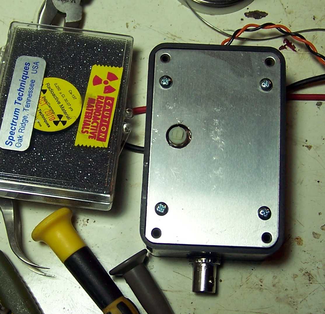

Outside of supply
Outside of supply
Now, these guys radiate quite a lot of 50khz stuff, so I grounded the box panel and put a bit of copper tape in there to shunt that to ground to keep the air around it quiet.

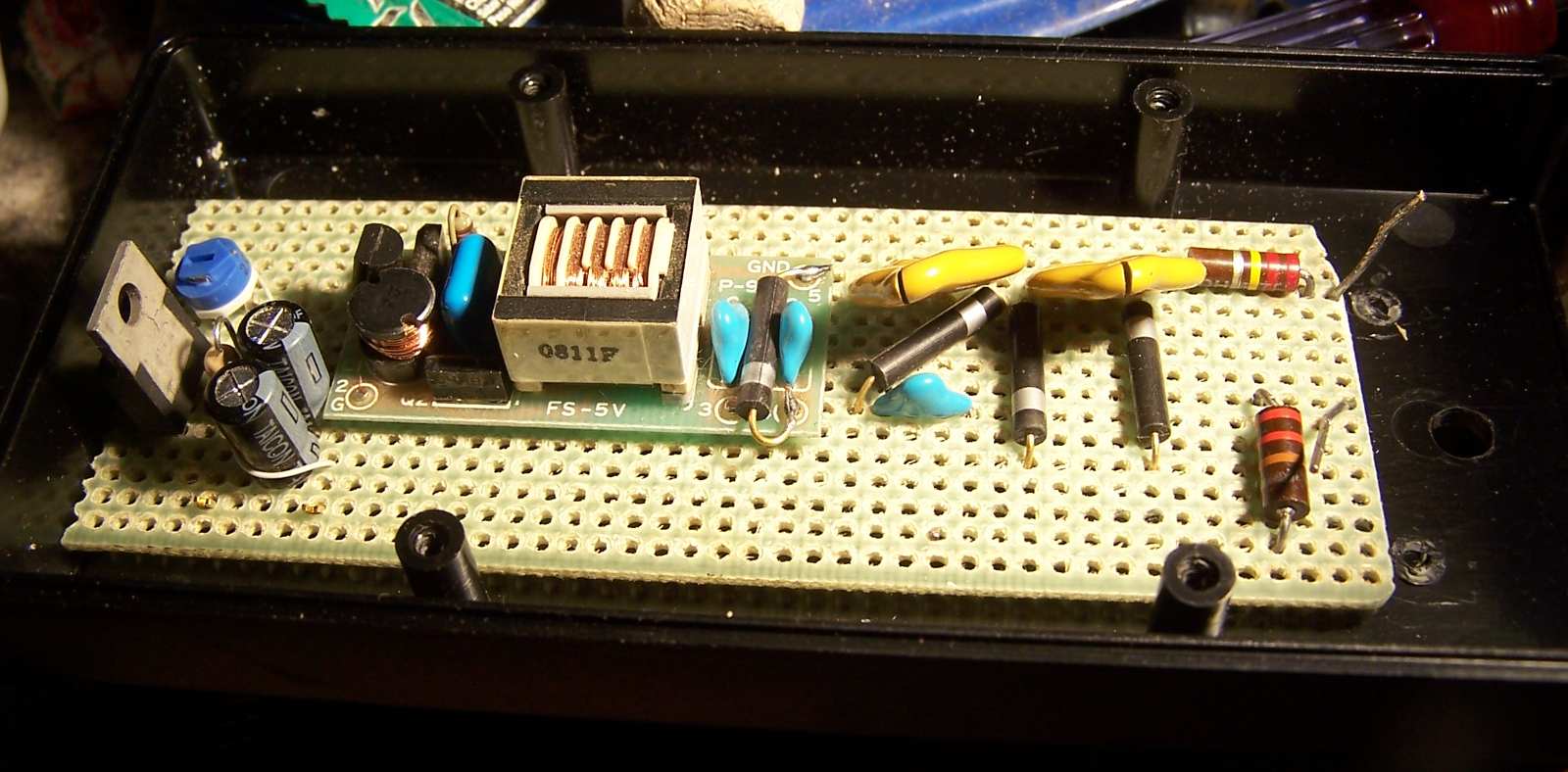

Since I'd put the previous model into a fairly large box to accommodate the big original caps, I had plenty room to do this up clean and sweet. Here's a pic of the thing in the box bottom, which will be again screwed to the side of the 3he moderator, away from the preamp. I've not hooked up the input and output wires yet.
Top view
Top view
I used a spare small cap for the 2nd AC side -- this may as well be a "no load" situation, so the 27 pf is plenty (and the price was right). I didn't really need the spark gap caps here, but they were short enough to fit in the box well after being bent over. Lots of room meant I could spread things out nicely for low corona issues. I will probably want to put some copper tape on the outside of the box and ground it to keep from radiating so much of the 50khz supply noise, but again -- with the supply at half voltage, the first 6 dB are free too.

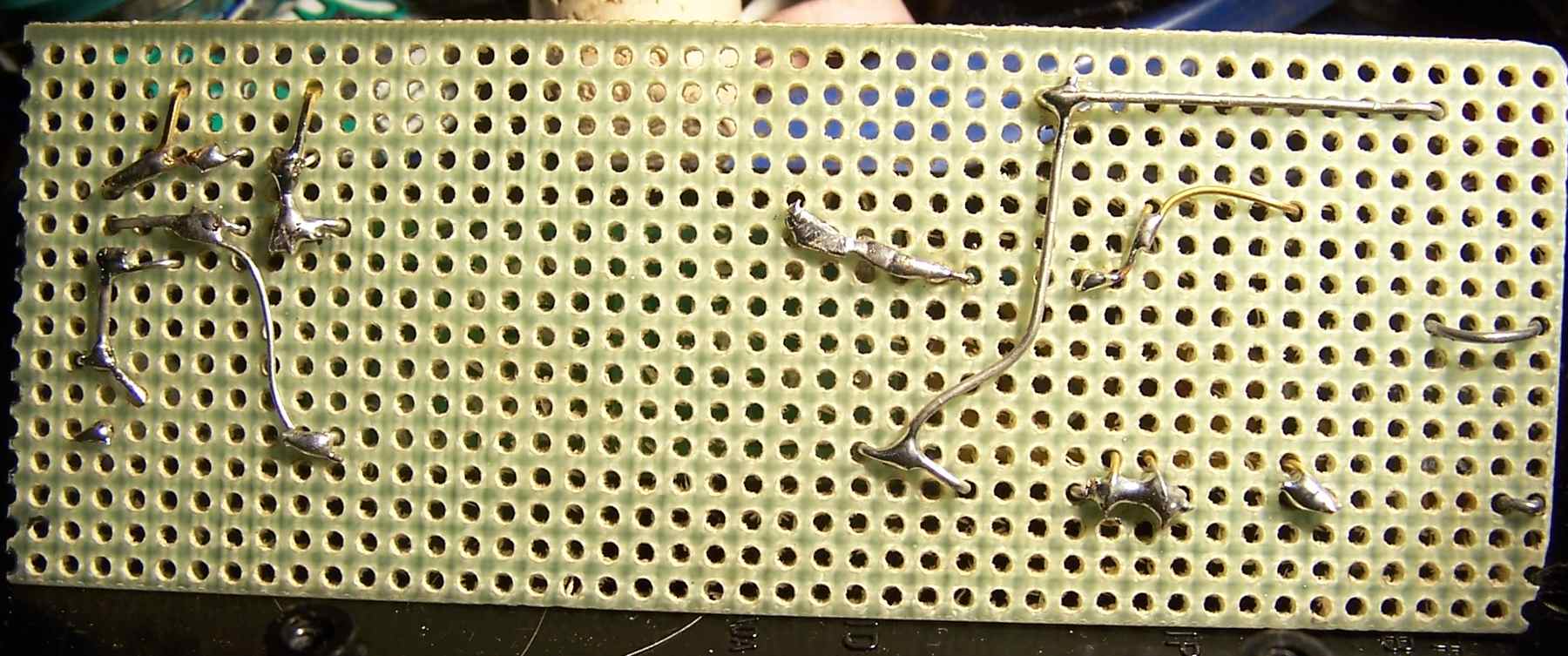

Here's the back.
Bottom view
Bottom view
The other change I made is to the pot value. This time I used 2k to get a wider range. A bit harder to adjust precisely, but less bother than calculating a pot + series R, and this makes the thing more generic should it be put to some other use later on. It is adjusted correctly in the top view picture -- right in the middle, cool.
