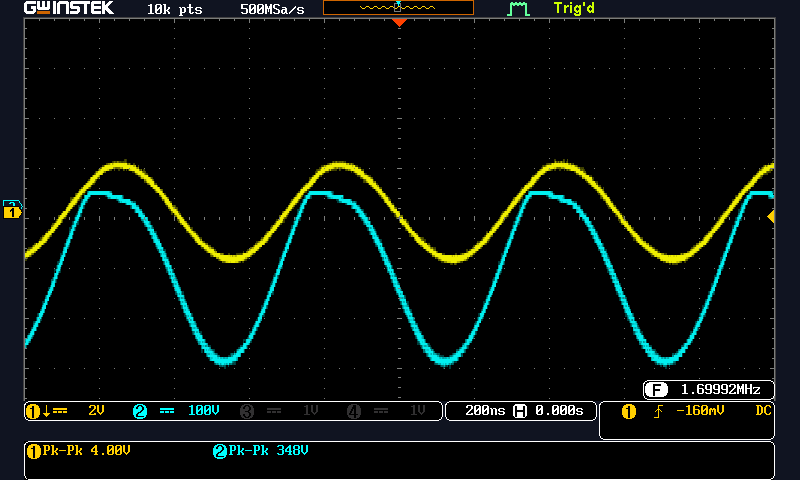

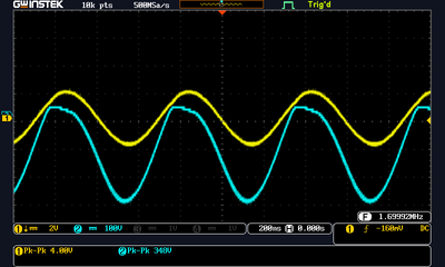

The 6146 stage now will make a few hundred volts pk-pk into the 4-125 grids and drive them nicely positive despite starting from -95v bias supply.
Input and output of the 6146 are now "modern" toroid transformers I wound that work well at the range of interest (1.5-3 mhz, but pushing it at the top end, too much Q). Based on other measurements I haven't posted yet, I think I want to be down around 1.7 mhz for now.

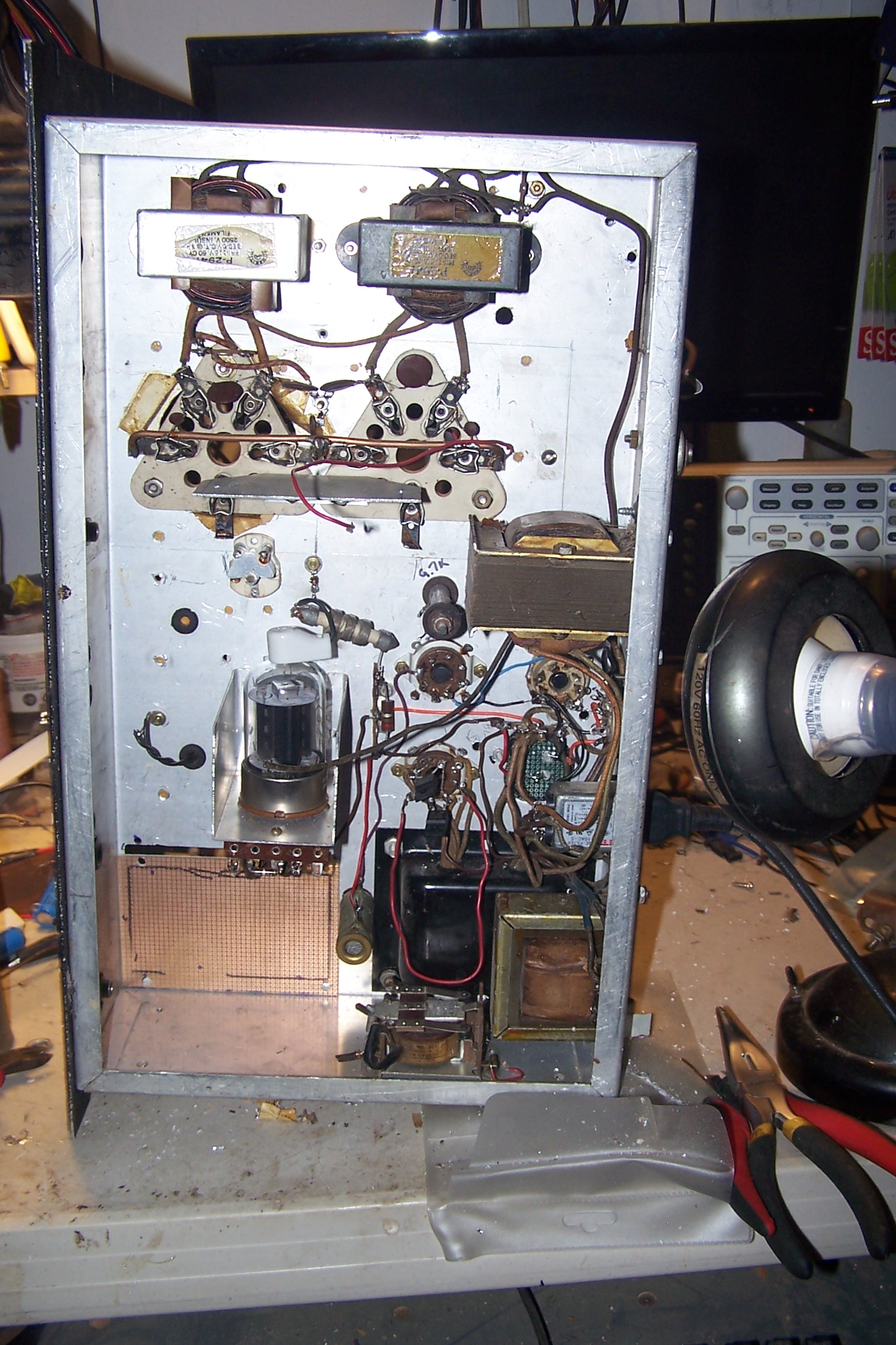

input and grid drive to the final
the underside in progress (I've added things since)

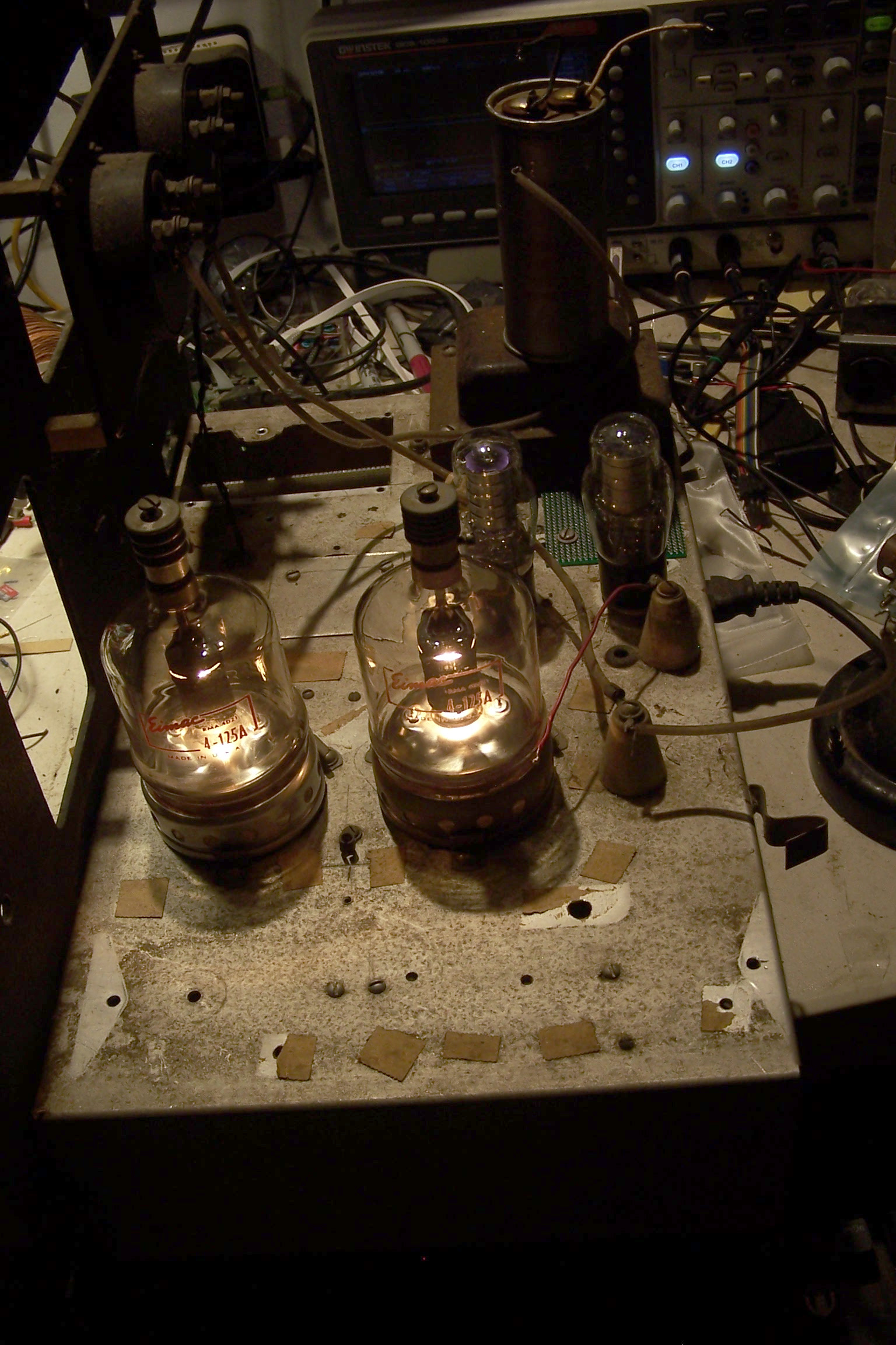

Fire in the hole! They at least light up.
I've been "conditioning" these to hopefully let them self-getter for awhile. Procedure is to light them up for an hour or so, then tie all the grids and plate together and put enough volts to draw rated plate current (around 50v in this case) and run that all day. This may or may not be enough, I've heard the best way is to run enough power input (somehow protecting the screen, maybe just run the grids at or near ground) to light up the plates red hot - where they will act as getters. I do plan to try seriously current-limited HV on this to see what happens...maybe with a big series R in the screen supply too. Meanwhile, a lot of tedium, adding fans and power supply control and so on. And getting my little coupling transformers right...

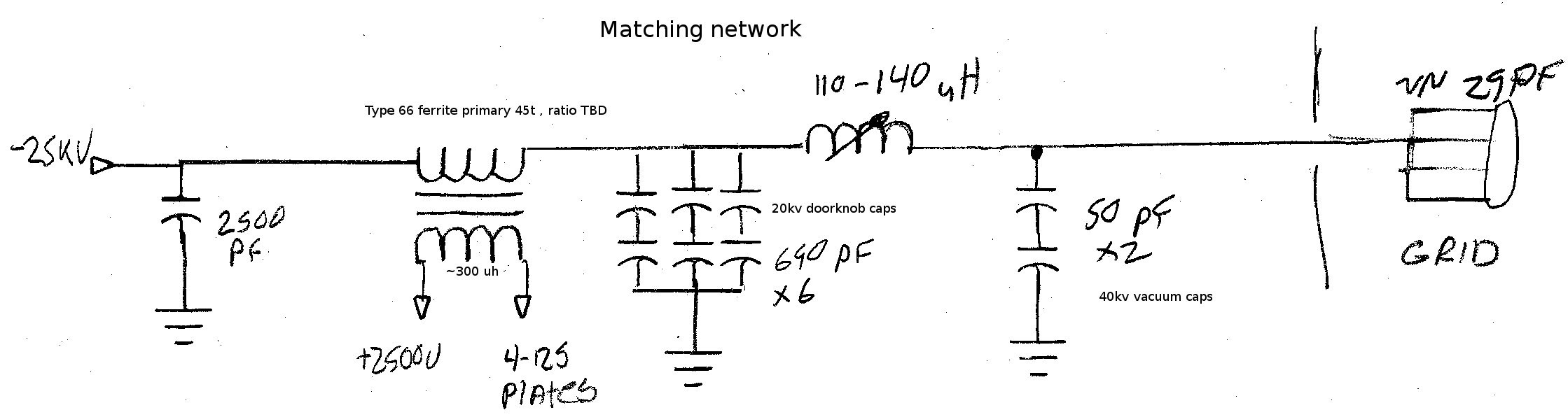

I am planning to use transformer output coupling for this. I need to isolate between the ~~ +2.5kv amp plate voltage, and the -25 or so kvDC I'm adding in.
So a transformer will drive the pi network, the RF ground end of which will get the DC feed. Right now this pi is ~1035 pf at the low impedance end, and grid + 25 pf at the high impedance end, with around 115 uh L (needs a little increase to hit where I want, to around 130 uh, which is only 2-3 more turns).
I added the 25 pf in the belief that it would help swamp the few pf the ions add, and to get the F0 down a little with less modification on the pi L, as I'm kind of out of room for more turns there.
The impedance at the parallel resonance is near 500 ohms, and the ARRL tells me my plate impedance is going to be ~ 2500 ohms, so 2.3:1 turns ratio more or less, at least that is going to be easy to twiddle. I'm using a bunch (and this stuff really ain't cheap) of type 61 ferrite rod as a core, and wound a test winding on it.

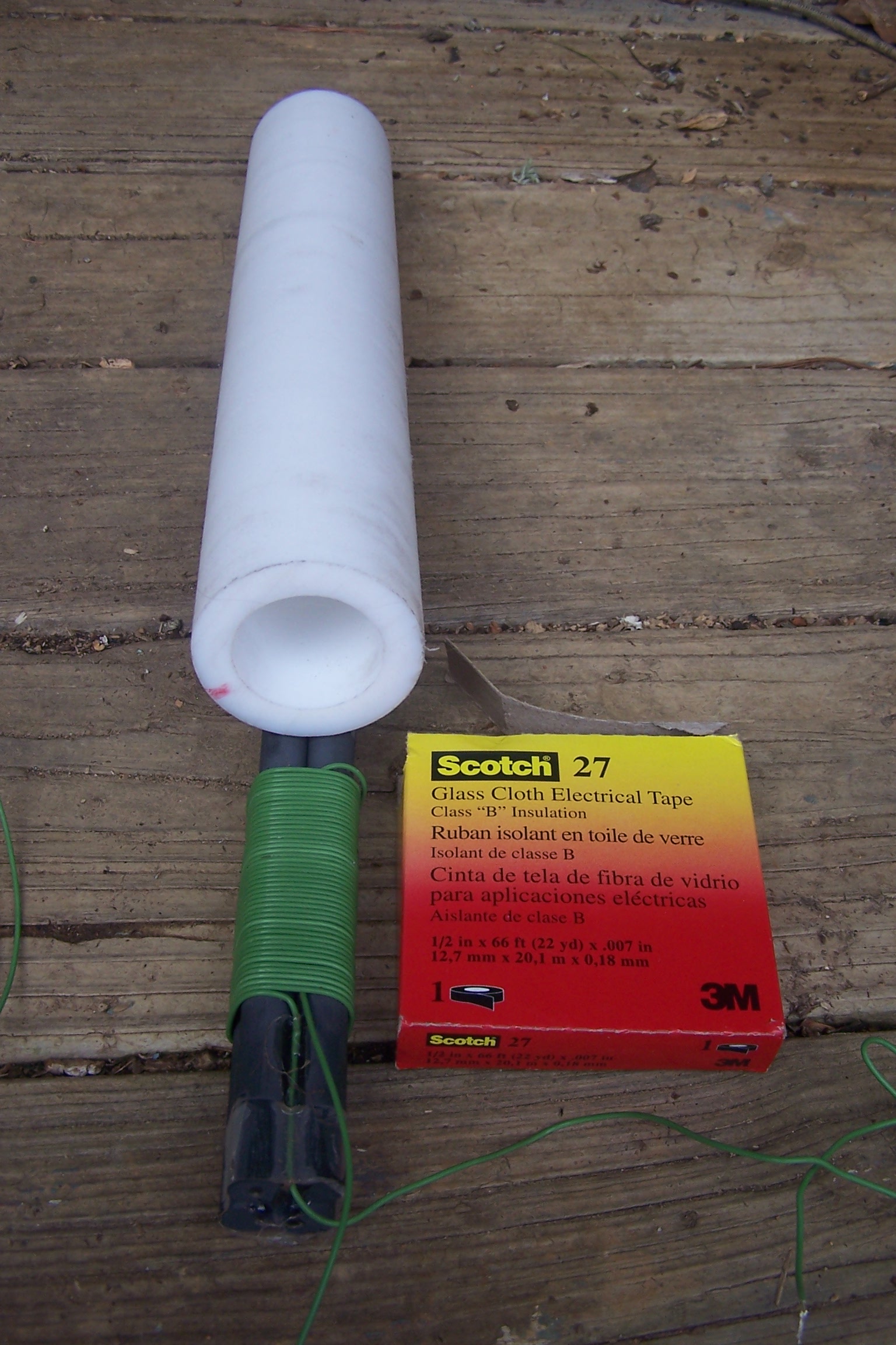

Isolation is going to be provided by this rather thick wall chunk of teflon. In low power testing with the winding shown, things look pretty good, but of course I'll need better than that skinny teflon wire, the core wrapped in insulating tape and so on for the real deal.

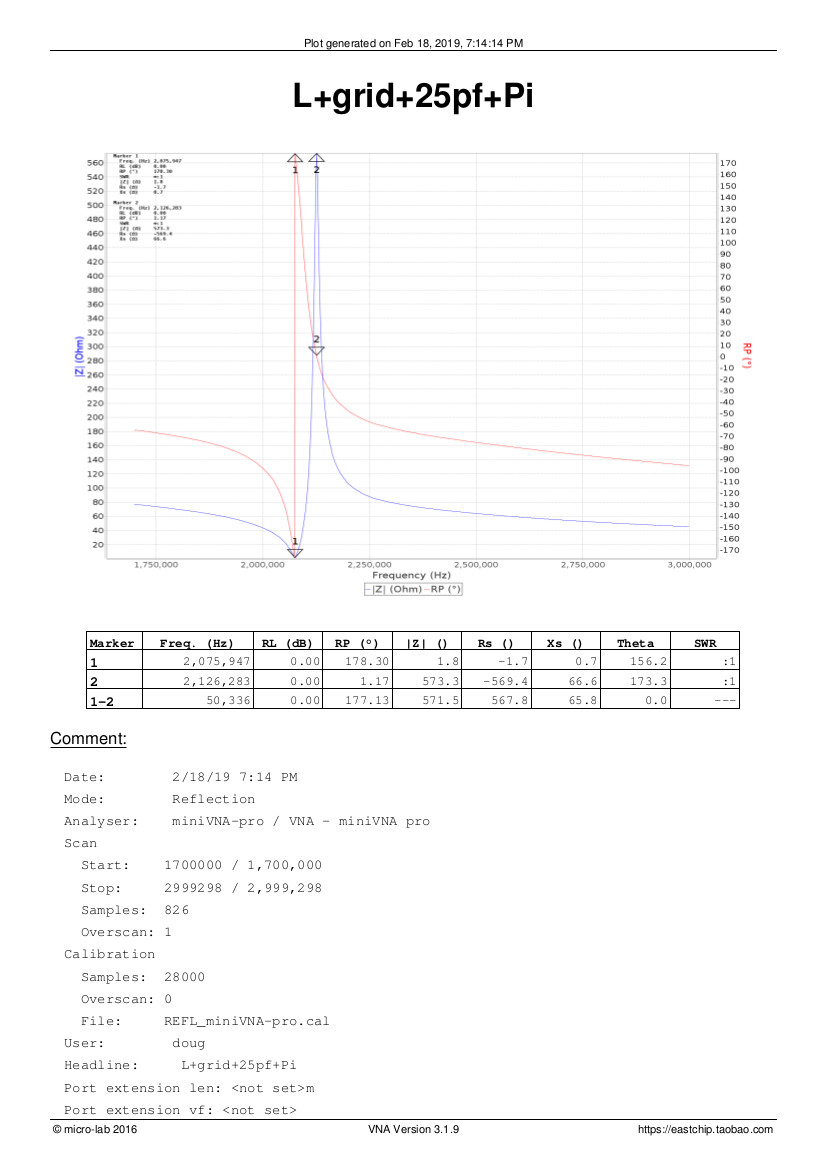

The output of the VNA looking into the low impedance end of the pi network (here we are stepping up rather than the usual direction).
What this transformer will be driving

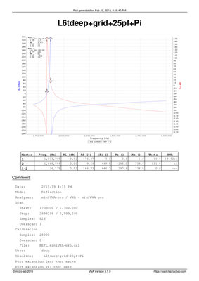

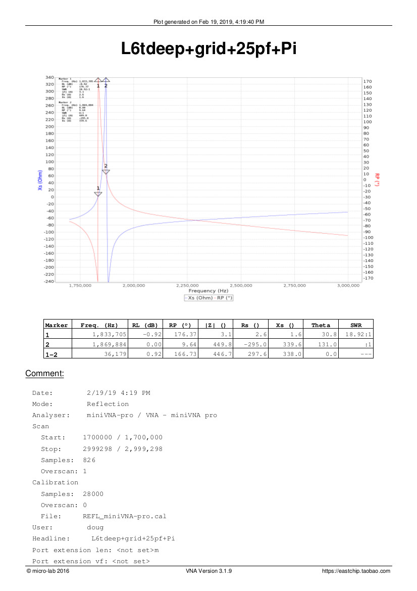

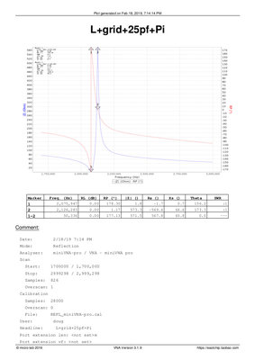

L+6tdeep+25pf+Pi.pdf
With adjustable L and additional 25pf across the grid
(146.5 KiB) Downloaded 350 times
Oops, PITA pdf. Here's the relevant jpeg.
Visible without download...
So, a few hundred ohms load looking into the final pi network at the parallel resonance, should be fairly easy to hit that number. The pi net is 1015 pf input, the L which is around 130uh (adjustable a little) and 25pf+grid, which is around 55pf total (~ 20:1 step-up!) The fusor ions aren't much load themselves, they look like a few more pf and some parallel R (around 750k) in earlier tests. I want to push this to higher ion density, and if I understand right, this will increase the load (decrease the net R at the fusor end of the pi) which should in turn raise the no load impedance at the pi network input. Still should be in bounds for the range of interest. I might have to add a few turns to the output transformer secondary...

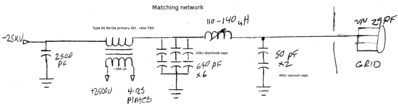

Gotta start somewhere, I'll try to get the schematic for the amp (at least so far) up soon too. This is what it drives, it was hard to describe in just text.
I'm using a 6" rod (4 pieces of .5" type 66 ferrite "in parallel) for the primary. The secondary will be on the outside of a 1.5" ID by 2.25" OD teflon pipe for voltage isolation between the negative HV from the Spellman and the positive voltage from the amp's supply.
This resonates as shown above in the VNA plot with the parts shown.
Initial matchining network, voltage and impedance step up from amplifier plates.

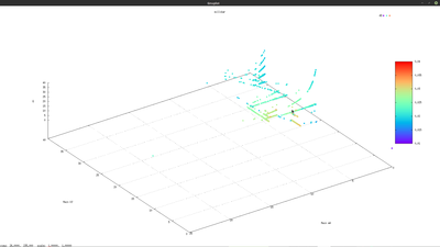

While OT for this thread, I want to mention that with 25kv DC + 8kv peak AC I got better Q than I did with 50kv DC (which was already around the best reported on fusor.net), and it's going up as I run off the edge of the plot! That's why I'm building this more powerful source, so I can run the conditions where the peak might lie. It's already working at 100x (at least) the pressure where a quadrupole craps out - probably because of where in the a and q map of those equations I'm running, and it doesn't seem super picky subjectively at least.
I'm guessing this is because at some ion density *not handled by the ion trap math which assumes no interactions* that things are smeared out - we have after all, even electrons and other species, and enough space charge to create some repulsion in the D+s. With DC we measure the particle velocities having around 1/10th the speed they "should" have for the applied field due to things like this. I'm betting the same is true with the ion trap class of drive signals, and this seems to be borne out by the results.

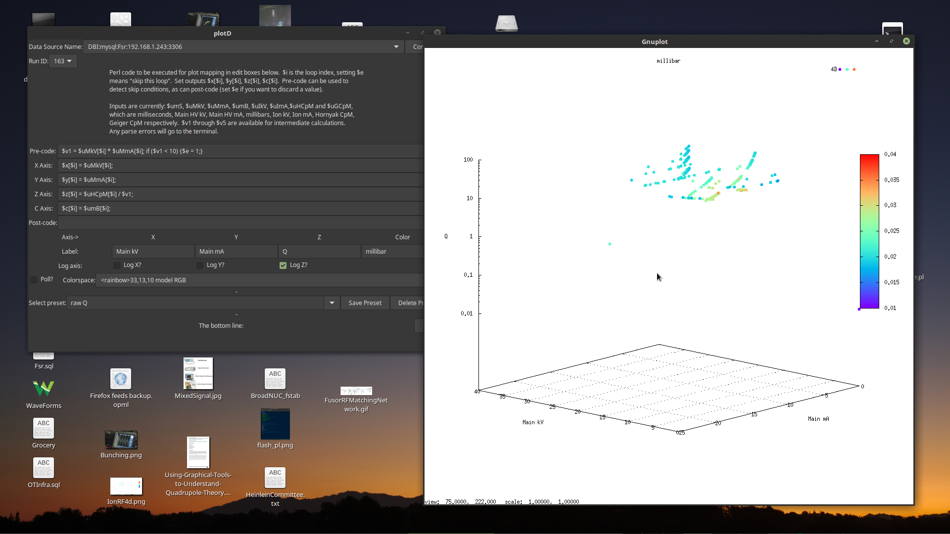

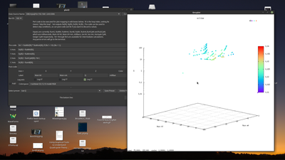

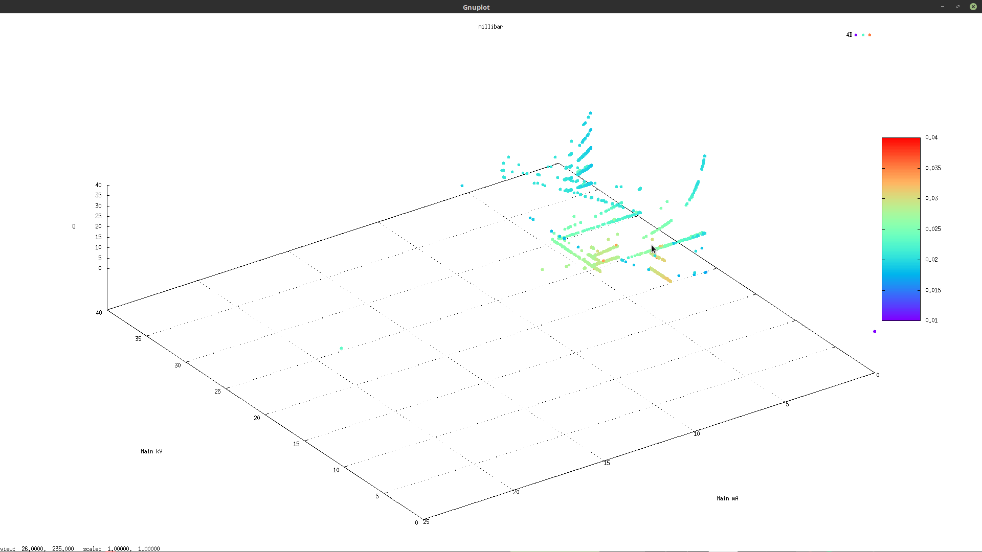

I'm a little hesitant to show this plot, but not for the reasons one might suspect - this is me spinning all the knobs and looking for any sweet spots (which I found) and even some time with no power, where cosmic ray triggering of the neutron detector makes things look "too good to be true" - because divide by zero kinds of issues.
But on the 25kv line, you can see what happens with RF off, and RF on - the lower flat line is with it off, and lower current is lower pressure, which the color map doesn't show very well. Notice it gets better fast as the pressure goes down to the point it's not drawing much power at all - it's barely staying lit. This all agrees with any reasonable theory one might make, except perhaps that it probably shouldn't work this well at again, around 100x the pressure a normal mass spec craps out at (but I'm using a more stable portion of where the math says it'll fly at all).
Further, for fun last night, I tried logging the Z axis (which I have mapped to Q in arbitrary units) and if it'd been going up exponentially, there'd be a straight line as a result. Nope, it's still curved going up, so it's better than exponential. I'm enthused.
Note the stuff above 25kv is probably errors, things started to arc and make lots of RFI....I don't edit my raw data here - honesty in reporting and the possibility you'll see something new later on.
This is of course better here where gnuplot lets me rotate this around any axis and other neat tricks.
And here's the version with the log(Q) plotted instead. It's still concave-up. That's pretty encouraging.
Logged Q
If it turns out that stuff with the higher DC bias is "good data" - and it might be, I haven't re-run my scripts that do the math on it yet - then I'm going to need some better bypass capacitors for the DC feed end - that's what arcs now (they're rated at 30kv). Those are to get an RF ground at that end of the drive network, and keep from back feeding RF into the spellman and messing it up - that was a pricey investment!

The 2500 pF capacitor probably doesn't have to be that exact value. Probably the bigger the better. It's purpose in life is to provide a ground return for the RF side of things and keep the RF out of the Spellman HV supply.
