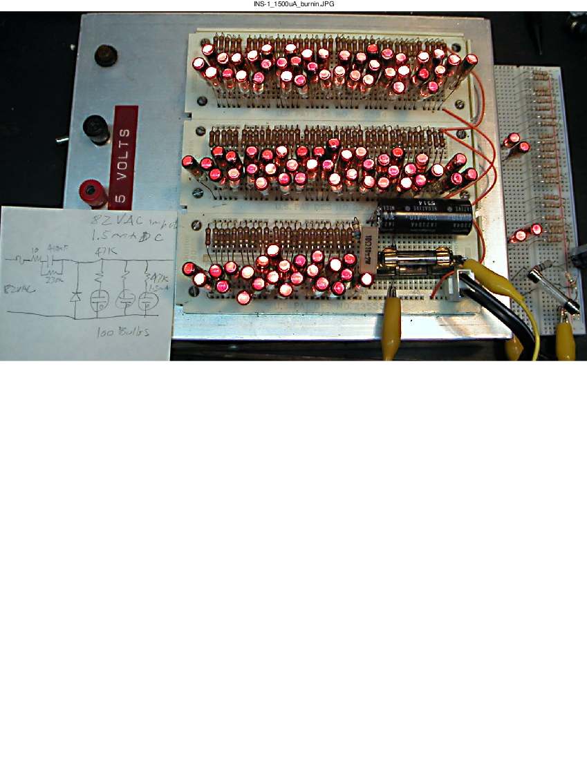

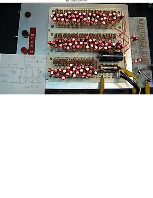

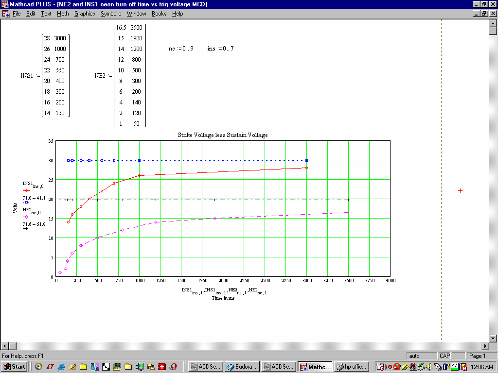

I attached some measurements I did a few years ago on how long it takes for the trigger voltage to recover it's full value after current to the bulb is turned off. This a deionization profile of sorts. The attached plot suggests that oscillation above 4kHz would be a struggle as only 6V out of the 20V histerisis loop has recovered. The measurements show results for the NE-2 and for the Russian INS-1. On a related topic I attached results for burn-in of the INS-1 bulbs over a week at 1.5mA. This shows how poisoned cathodes can clean up.
