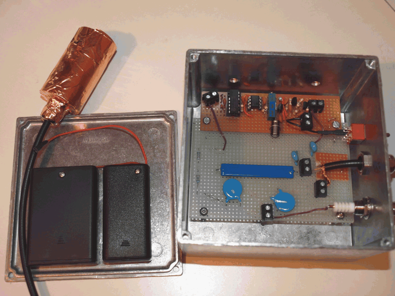

So, with the board I have now made up, as per other thread, attached to another (on uncopper-ed perf board) with the HV bits on, here is the tube socket and preamp stage, as envisioned above:
I decided I needed a bit more space than the 110x90 type size of the smaller project boxes, so went for 120mm x 120mm, and when I looked at what RS had there was a h=80mm box, so I decided I might as well use the height by installing AA battery boxes. So these are currently loaded with 5 x eneloop 2Ah, which should supposedly give 1000hr duty before a recharge (and 100hr once similarly installed in the second box with the HV supply in, where I'll use the same battery scheme).
...I am planning to make a second one of these to the same 'plan', so any comments for improvements/extra features welcome.

Make sure your CCFL or any AC carrying wires from it are fully shielded. A box inside the box is not too much (and might not be enough if the wires coming out of it have current pulses on them). I'd add an analog output along with your thresholded one, so you can know if you've got drift or other issues. I usually do a lot more testing before I assume some TTL output is good to go than you did. Lots of things can go wrong...a scope output at analog level is nice to have to know about that instead of blindly trusting some sudden vast increase in counts as real neutrons that was really noise or oscillation or drift that puts the intrinsic noise above threshold.

That's what has taken the 'weeks' of work - testing, testing and more testing, so it is right first time I build it.... I started with the HV PSU from the crate which gave me the stable supply I needed to get to grips with the tube's signals, but once I had established these basics I have moved on. The ccfl supply has already displaced this and has been the 'in-the-loop' supply for the last few weeks of test.
